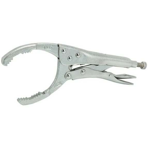

On medium sized tractors, I've had the best luck with this type of oil filter removal tool, the vise grip plier style.
They work great and I can grip the filter near the base where the torque does the most good. I bought mine on a lark from Harbor Freight but now they are my favs. If you can get them on the filter you can get the filter off.

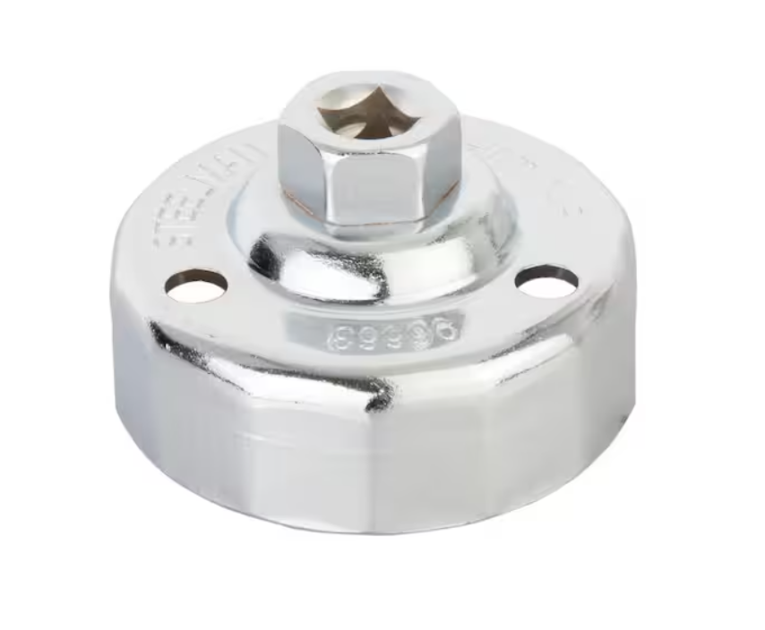

I did try my impact wrench but as its been brought out too much of the impact motion is lost over the length of the filter.
There is vey little room on my tractor to get a breaker bar in.
I do like filter type socket that AB suggested. what is the technical name for that and my filter is 4.5" diameter, do they make them that big?
Regards, Joe

When nothing else works I break out the oil filter vice grips. I must have 20 different oil filter wrenches/sockets/straps/chains. I might only get 1/10 of a turn on a filter in confined space, but the vice grips have never let me down. It helps that I have a 4 post lift and I don't have to crawl under the tractor/car/truck/mower.

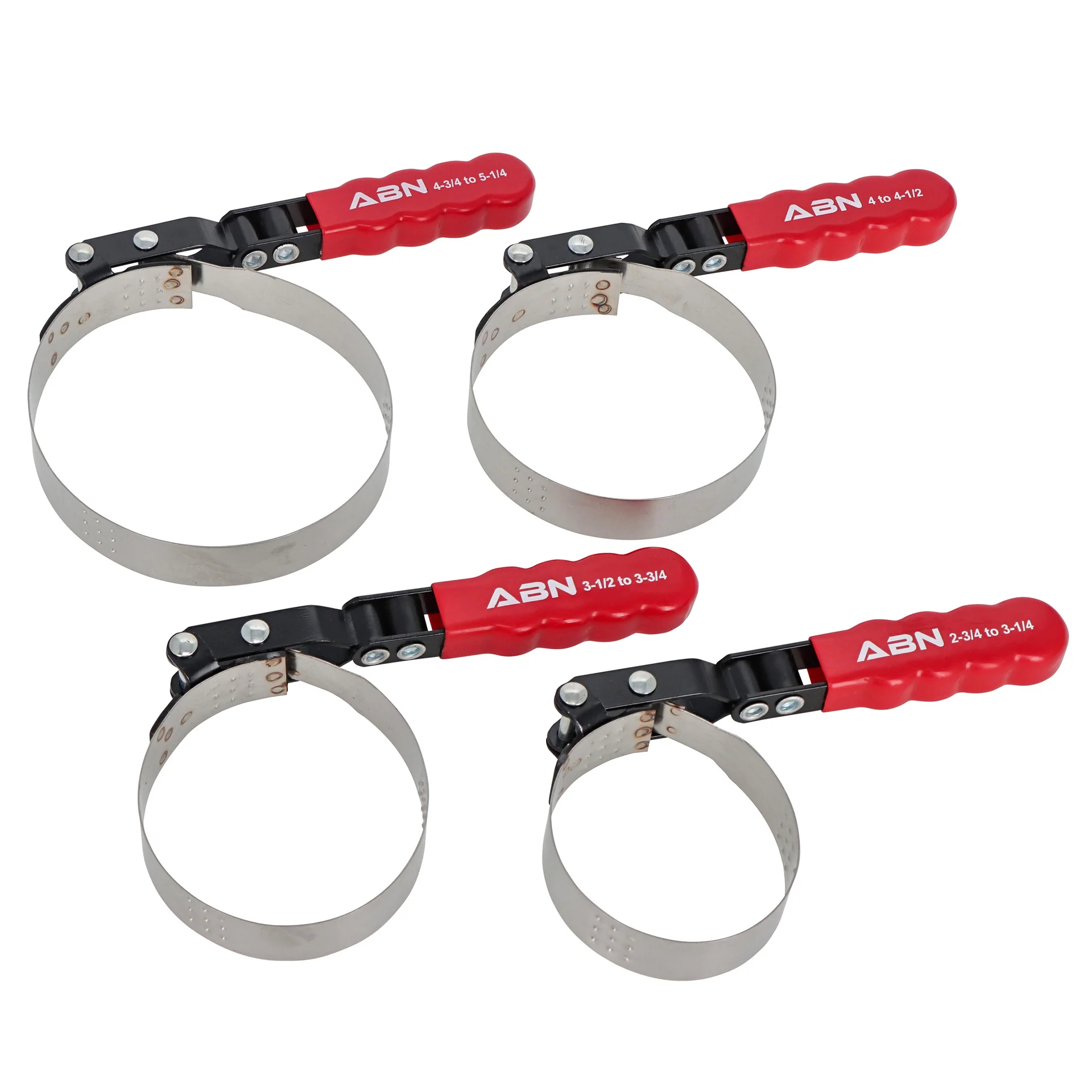

I have yet to fail removing a filter when using a simple band type filter wrench in the correct size, and it's been hundreds of them.
But no, not the strap kind, but the all metal versions. No idea why more people don't use that kind since they're so effective. I must have a dozen different filter wrenches, but rarely use any of the other ones.
   / original hydraulic filters wont come off. #58
Same. I have two in different sizes, which must be 50 years old, and they always work. They're great for mowers and tractors, where you can usually access the filter from the side, but not so much on modern cars.
They're pretty much identical to these, for anyone who hasn't seen one, and the handles pivot to get into tigher spaces:
In the case of OEM-overtight filters, I've had my metal strap wrenches crush the fitler can, but they never lose grip!
For cars, where it's sometimes only practical to grab the end of the filter as it's jammed up between other things, I usually use these:
When those fail, I grab this little medival torture device, which will twist and destroy anything you put it to... should you have two free hands and all the coordination required to keep it on the thing you're trying to turn:

If you like those you'll love the ones I use, with a 3/8" square drive instead of a handle.
Then you can use extensions and swivels which makes them usable in most any situation.
