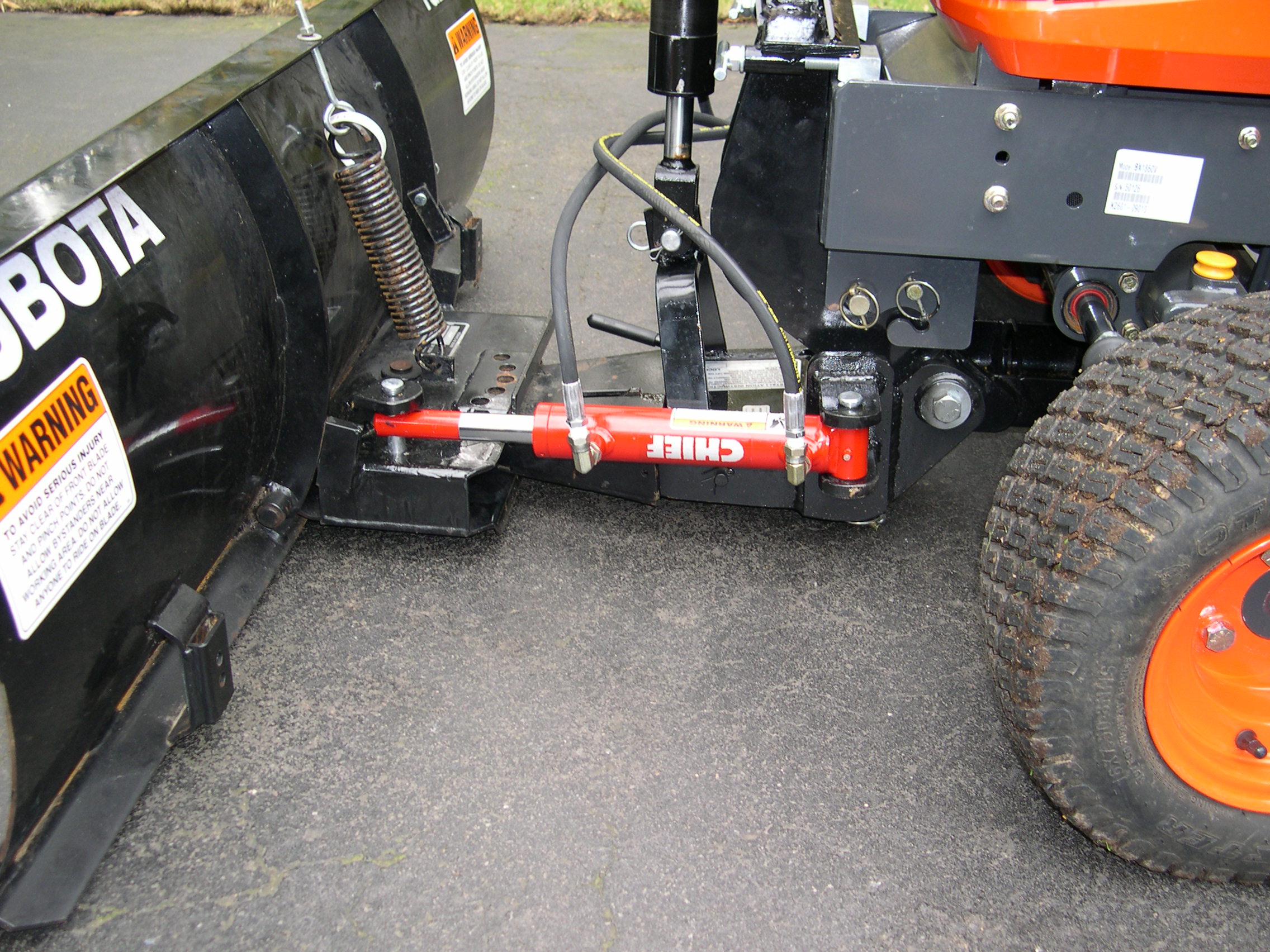

Builder, Kubota does offer a 54" lighter duty front blade, which is fine for snow and probably moving loose material. However, it comes with hydraulic lift only, no hydraulic angle. Price is somewhere a bit north of $1K I believe and uses the same quick hitch as the 60" blade and front snowblowers.
I picked up a 54" blade slightly used from Messicks and a new quick hitch, then added the hydraulic angling by having mounting tabs welded to the hitch and plow frame. Cost me around $175 with paying for the welding. If you can weld yourself, you could do it for less. Here's a few pics.

Yes, but like I said the 54" is fine for snow and loose material and hydro angling can be added aftermarket. I got the idea from another member here at TBN. Another option would be to buy the quick hitch and adapt a used truck plow blade to fit it.
