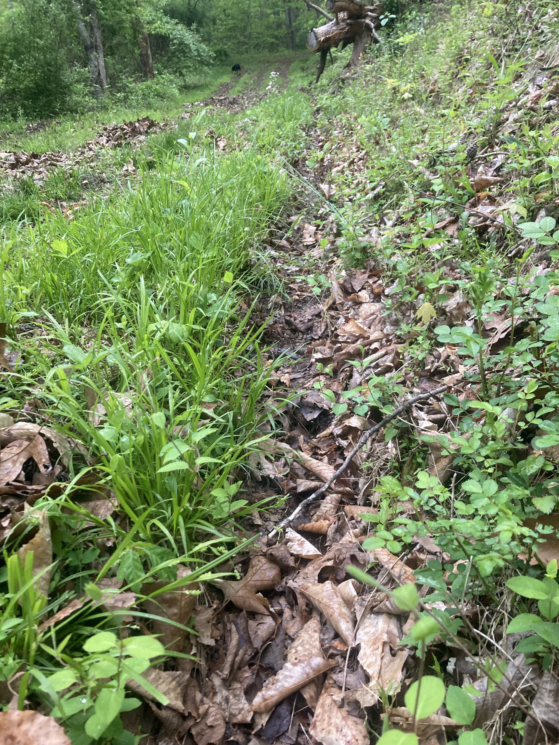

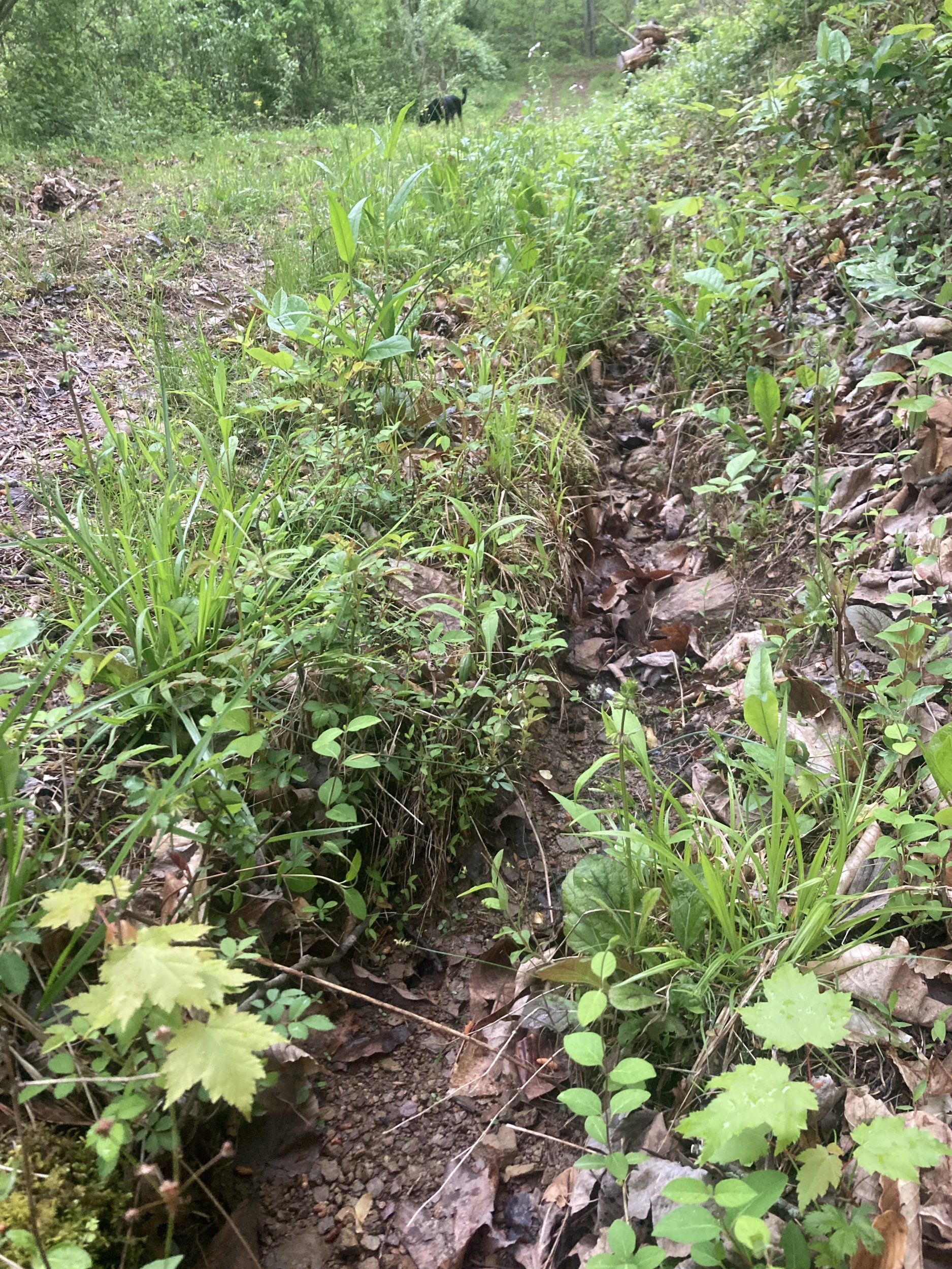

Here are a couple of pics. Thanks for the responses. When/if it dries out I may try dropping tires into ditch line with blade if I can adjust vertical blade angle enough. Should I also adjust horizontal angle? FYI the tractor is 2013 upgrade and implements predate the 7040. I would consider one of those blades that offsets with more adjustablilty anyone have a good used one for sale?

Looks like the ditch is on the uphill side. Problem is that unless you can get enough tilt angle on it, either a blade or box is going to flatten it to where you don't really have a ditch.
/ Opening ditch lines #10
You will need to adjust the horizontal angle. Your tractor probably has an adjustment to make one side of the 3-point lower arms lower or higher. But I don't get enough angle that way on my tractor. But you can get a lot more by adjusting the top link. If you make it shorter the leading edge of the blade will go down, giving more cut out of the ditch.
