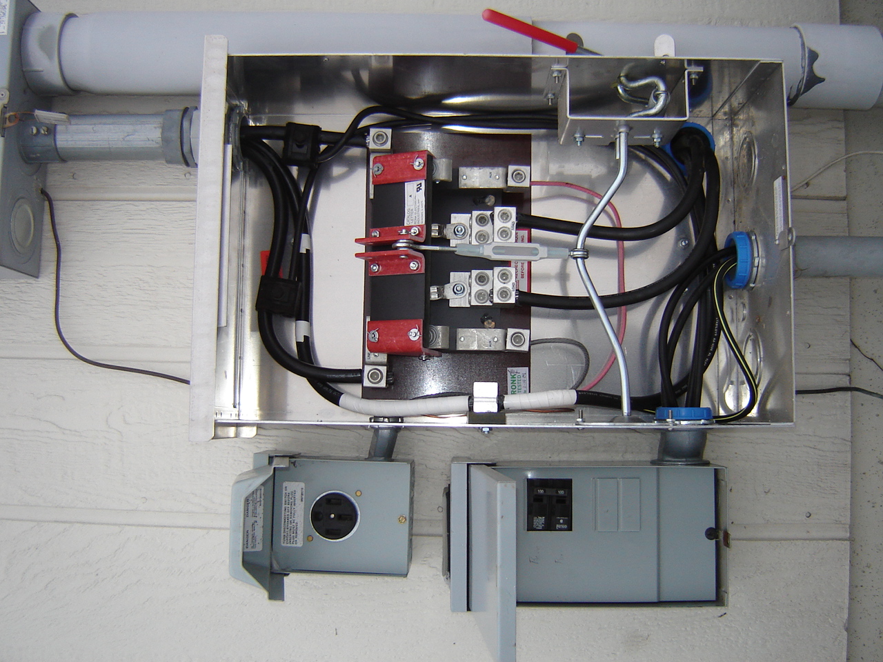

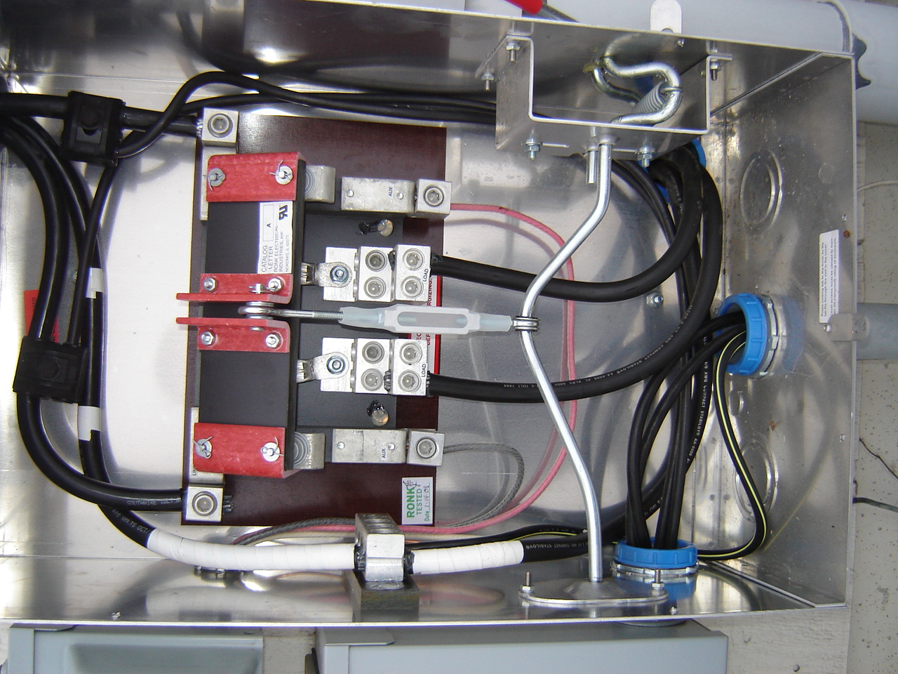

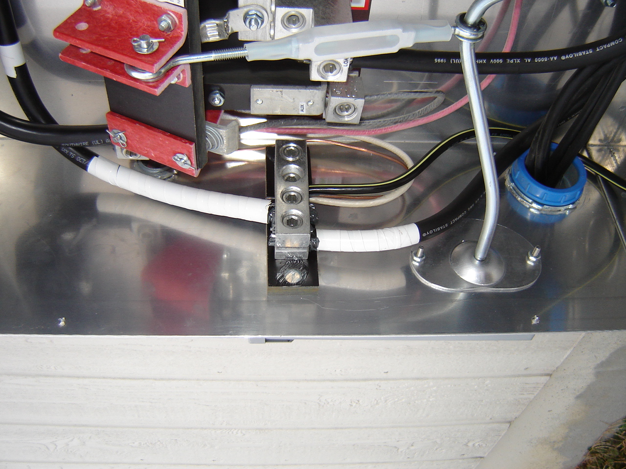

it appears to only switch the two hots.
the neutrals are on the left and in one of the close up pics
the overview show the place to plug in the generator (no comment on the need for double male plug--I know the dangers)
the bottom 100 amp breaker is run separate from the switch and goes to the barn. I don't need it out there and will then know that the power is back on. some of those wires you will see inside the transfer switch.
I hope this helps

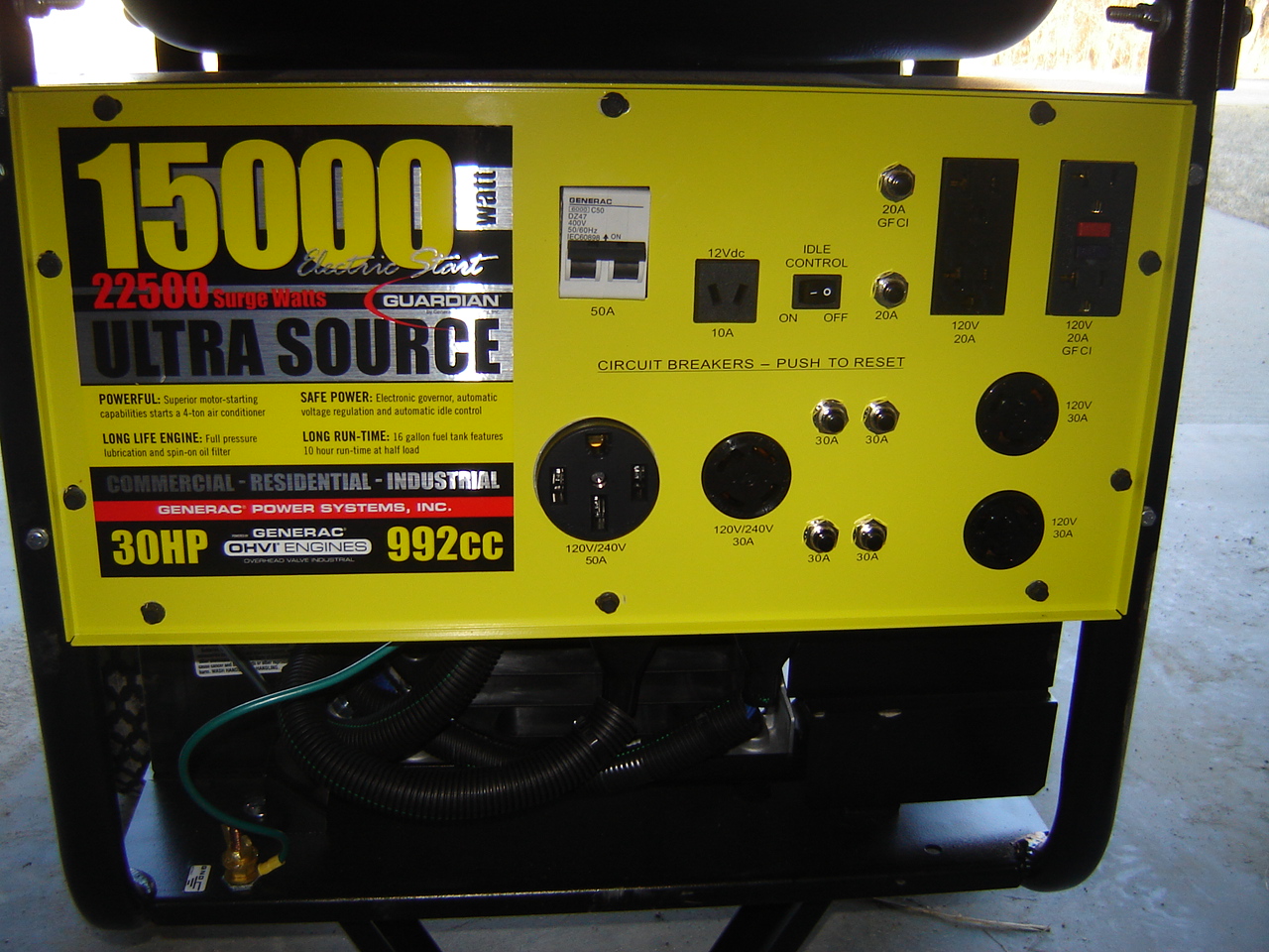

Do you have your generator grounded to a separate rod? What size and brand generator?
/ open ground on generator
generac ultra
you can see the grounding lug below the elec panel (green wire to it)
I used a set of 4 gauge car jumper cables to go to the same grounding rod the house uses. Perhaps it was corrosion on the copper rod as it has been out there for 14 years. Should I be using a separate rod? Some google-ing indicated I should use the same but am by no means an electrical expert

The wiring looks correct from the picture
Be careful with this testing if you have an meter
I'd ring out the cord from the generator plug to plug first make sure you got all 4 wires conducting from plug to plug with an ohm meter.
Then plug generator in don't start it leave house on line circuit take an
voltage reading from the neutral bar to the frame of generator and the ground rod they should be all 0VAC.
Start gen and measure leave the switch to line from each generator line to the neutral bar make sure you have 120v on each line.
Then measure voltage from the gen lines to the ground wire / rod running to the meter socket (in picture behind transfer switch)again it should be 120v on each line.
Measure voltage from the ground wire/ rod to the frame of the generator then from neutral to the ground rod/wire both should be 0 again.
If no voltage is found on the last test check the resistance from the neutral bar in the transfer switch to the frame of the generator.
Do the same to the ground rod/ wire.
This should find the open in the ground circuit.

You have discovered that your genset, like most, has a floating neutral. This is a very confusing concept to many, including me, but I do know that the outlet tester will show fault. The floating neutral means that the neutral in the genset is not connected to the ground and that there will be voltage in the neutral.
It's confusing. Ground rods won't help.
Here's the answer to the FAQ on the champion power equipment website:
What is "floating neutral" and how does it affect my generator? (All Generators)
All Champion Power Equipment generators, with the exception of our 40012 and all CSA-certified generators sold in Canada, have a "floating neutral", meaning that the neutral circuit is not connected to the frame or to earth ground. This also means that both legs on the receptacle are hot legs, which is normal for floating neutral generators. As a result, there is no specific hot leg and neutral leg wiring arrangement for the generator winding connection to the receptacle. The floating neutral configuration is common for applications such as connection to a recreational vehicle and connection to home power where the transfer switch does not switch out the neutral to ground connection.
The floating neutral eliminates the potential of being shocked by contacting a hot leg and the generator frame at the same time, which could occur if an electrical device such as a hand held tool suffered from an internal short circuit.
Meters or other devices intended to indicate polarity may not properly indicate polarity on a floating neutral circuit. Polarity indicators generally measure the voltage across the neutral and ground connectors. In electrical systems where the neutral is bonded to ground, the voltage will be zero and correct polarity will be indicated. In systems where the neutral is not bonded to ground, voltage is also not expected across this connection. However, in a portable generator some very small current voltage readings can be recorded by sensitive volt meters. This voltage may be induced in the frame by the magnetic field of the generator. The current associated with this induced voltage and the risk of electrical shock are negligible. However, very sensitive polarity meters may interpret this voltage as an indication of reversed connections.
If you have an indication of reversed polarity, please check with the manufacturer of your meter to determine if that reading capability applies to the floating neutral output from a portable generator."
