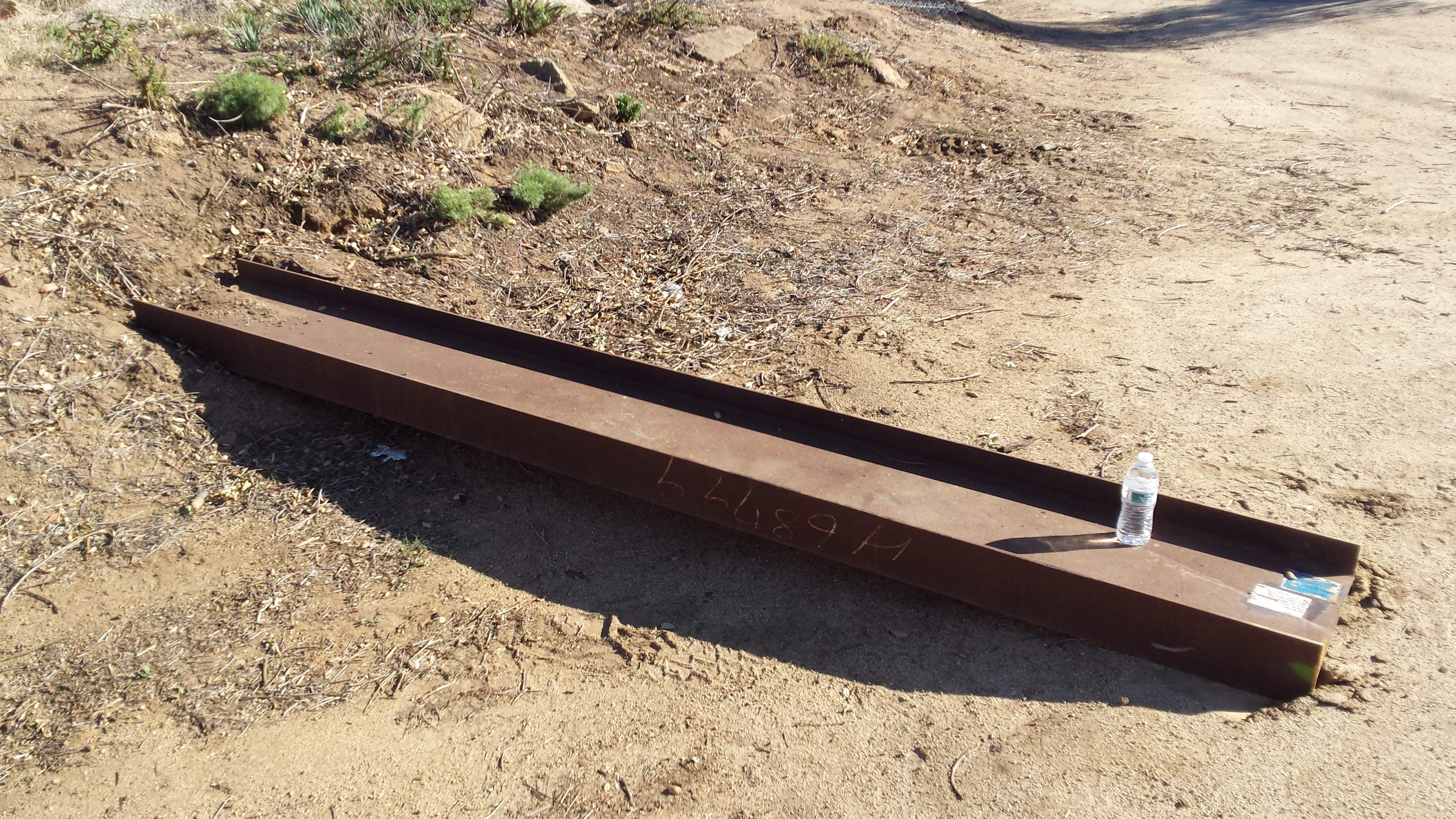

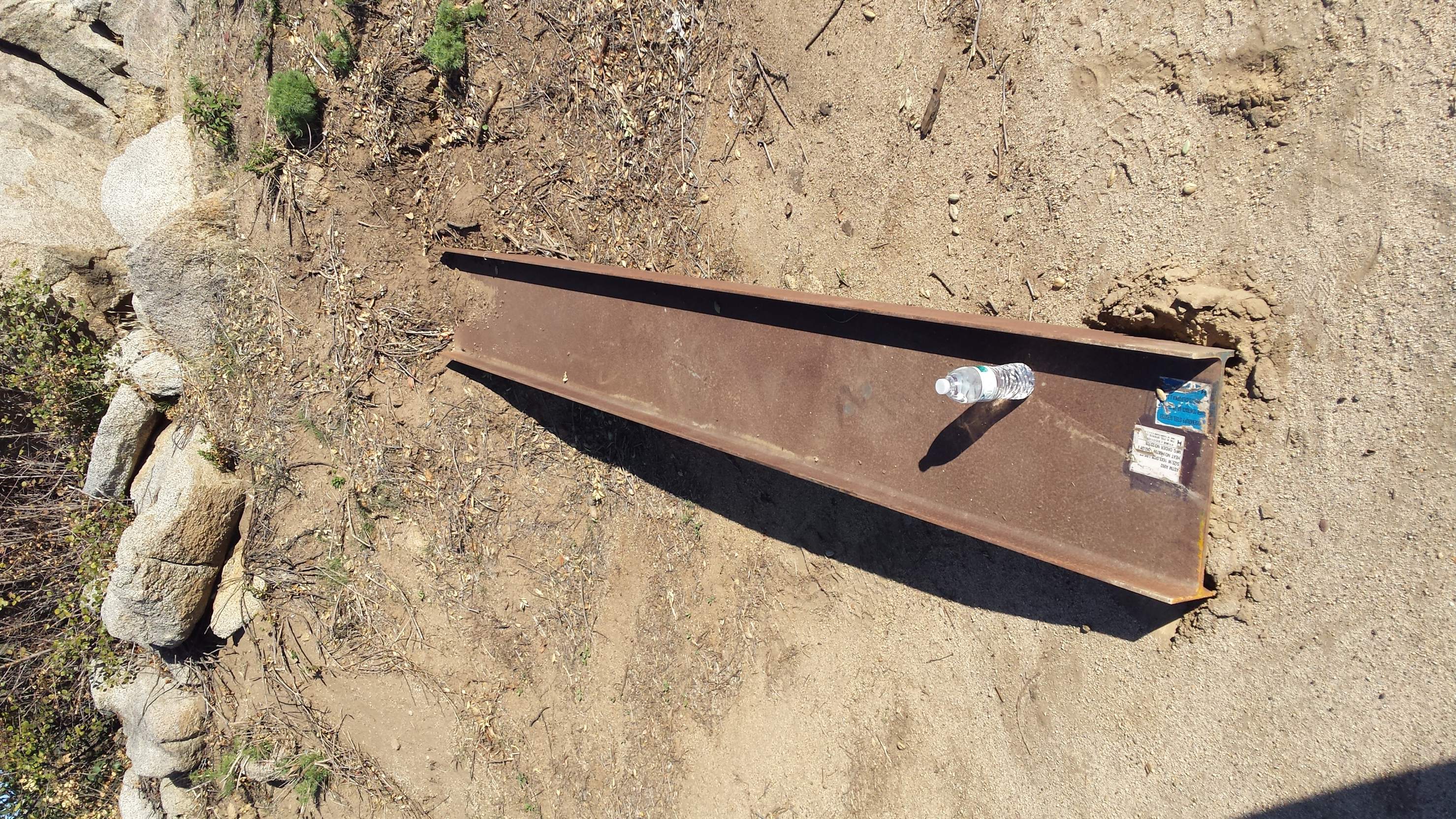

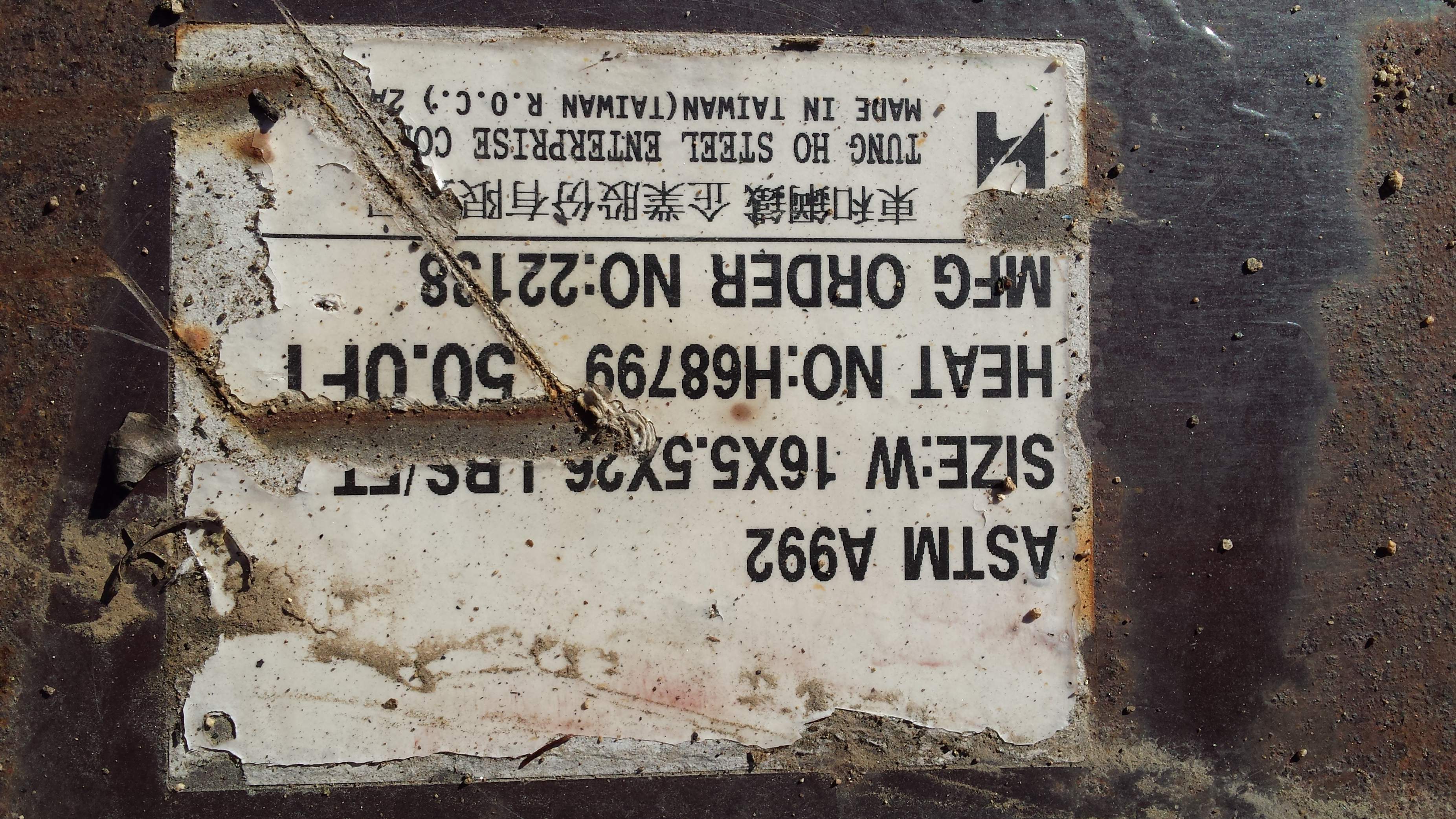

Found a I beam drop 16 x 5.5 x 5/16. Its 10'11'' long and 26 lbs per foot. So working on a land plane build just have a few questions.
blades angled vs straight. Seems like angled blades for gradeing and straight for leveling. So guys with straight blades do you wish they were angled while gradeing ? guys with angled blades wish they were straight while leveling?
If I cut my beam in half ill have 5' 5.5" skids if I back set the blades 5.5" and run them at about 22.5* it would land in the middle of the skid and I would end up with a 5.5' cutting width useing a 6' blade. Does that sound feasible.

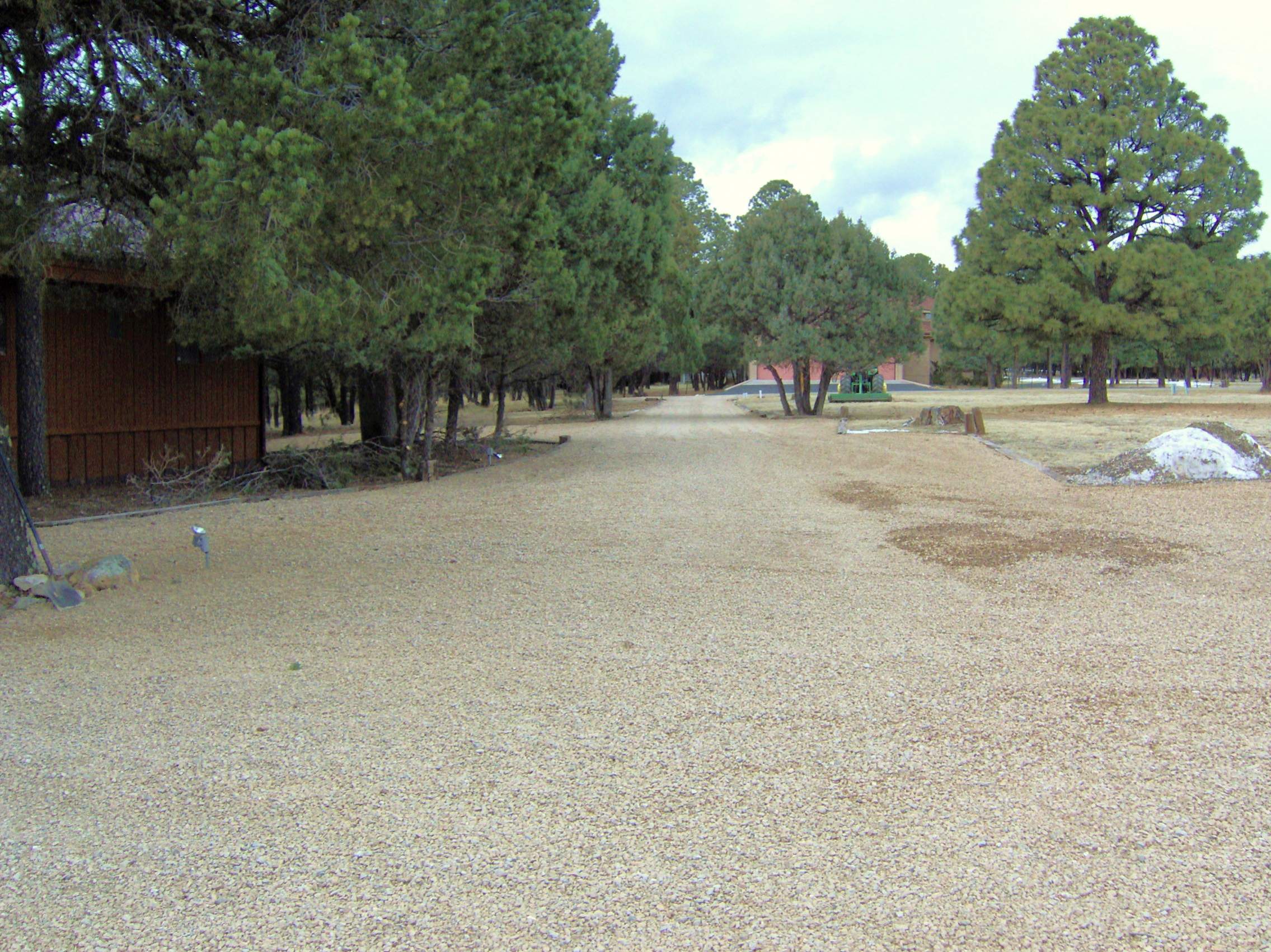

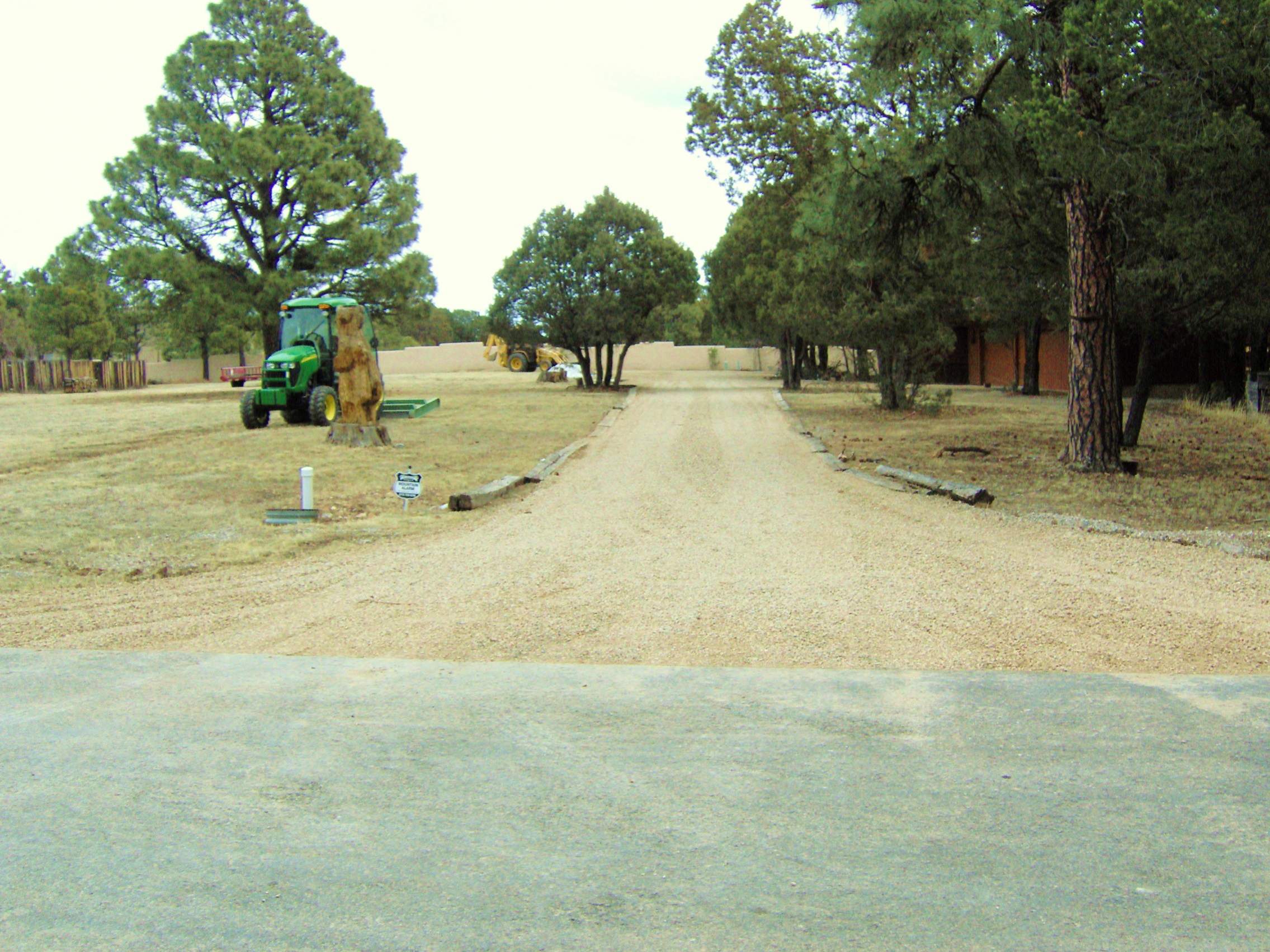

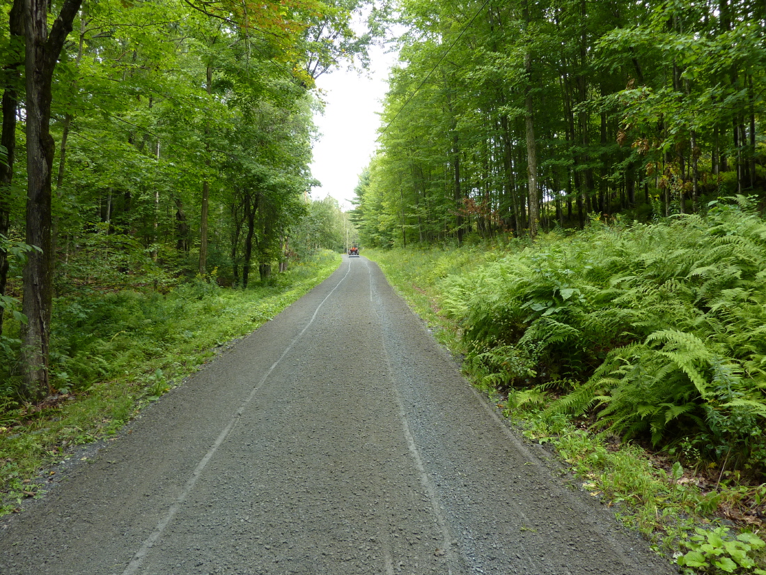

I put my blades straight and to answer your question; no, I never wished they were angled. Then again, I may not know what I am missing.
The reason I put them straight was that I wanted to be able to run up and down the road in either direction and on either side or in the middle w/o worrying about blade angle and material flowing to one side. If angled blades really are a significant help in building crown then you would be forced to grade in only one direction all the time on a crowned road. But I am not sure if angled blades do that much for you anyway. Another reason I chose straight blades was that I also have some sections of road w/o a crown. Those sections are flat but pitched to one side for drainage. As you say straight blades make more sense for flat. So to me it seems straight blades tend to be more general purpose but those people with angled blades like them as well as i like my straight blades. That is why I think it might not make much difference which way you go.
I use a rear blade to set the shape or contour of the road then maintain that contour, what ever it is, with my straight bladed grader and this works well for me.

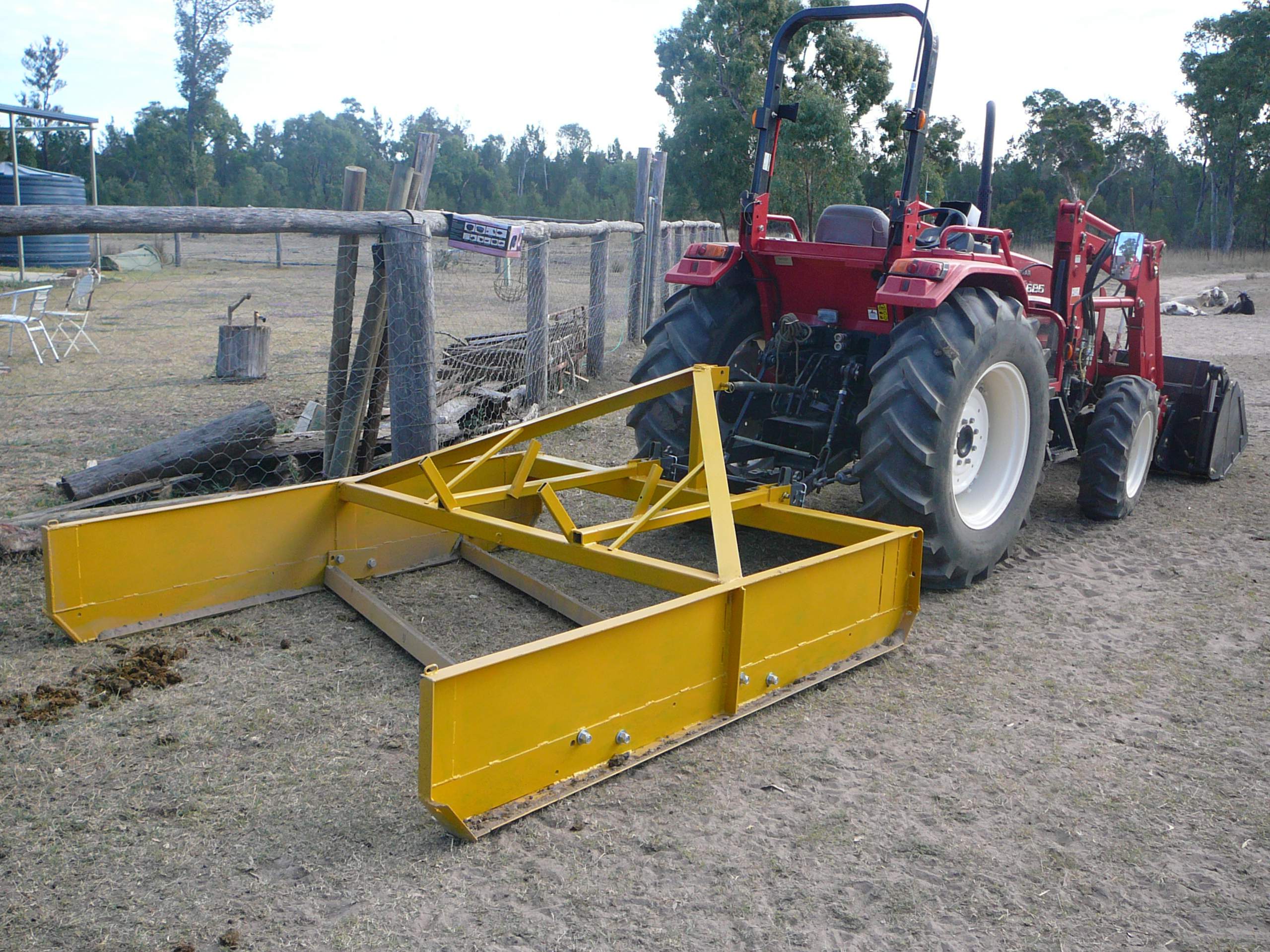

20131111_143936.jpg20131111_144011.jpg20131111_144022.jpghere is a couple pictures
/ one more land plane build

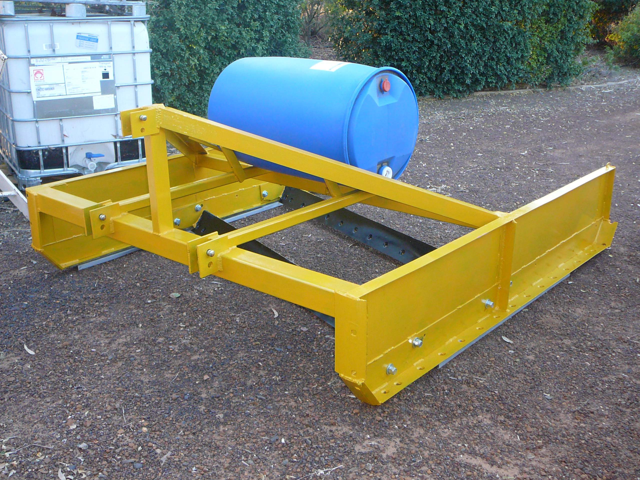

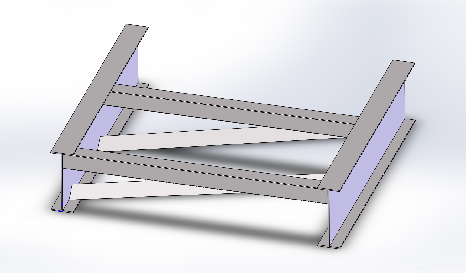

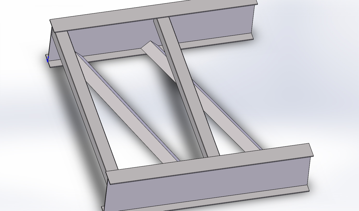

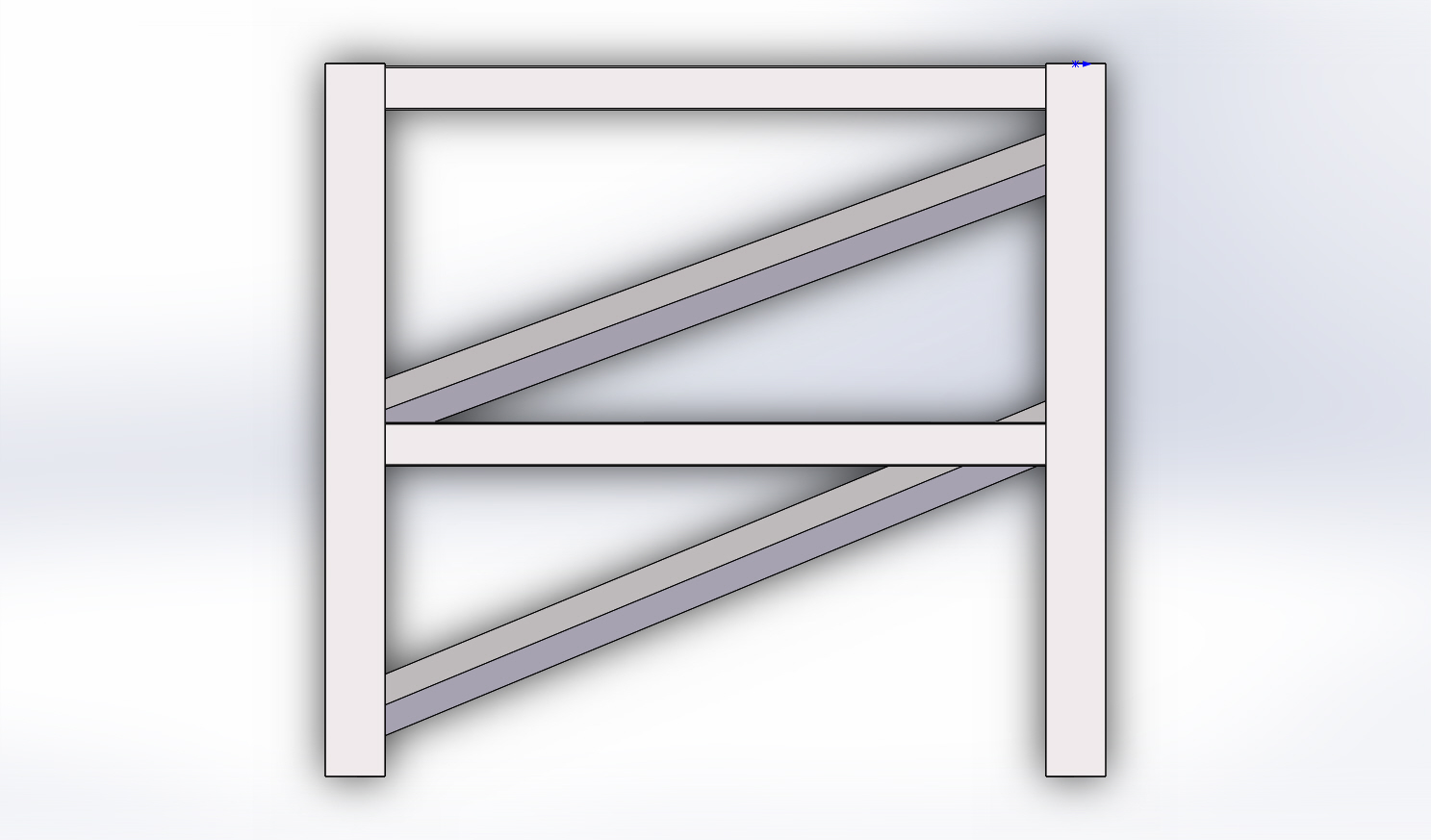

here's a model I made in solid works. angle iron at about 20.5* weighs about 580 lbs could be off by +/- 10% didn't really spend time drawing exact profiles for the beam angle and tube.
should I mount the lift arms to the front of the tube or on the top of the front cross tube

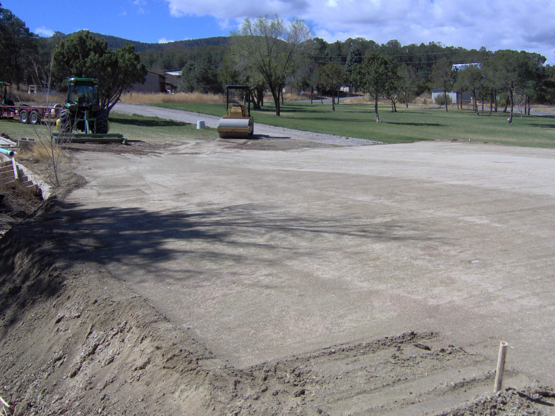

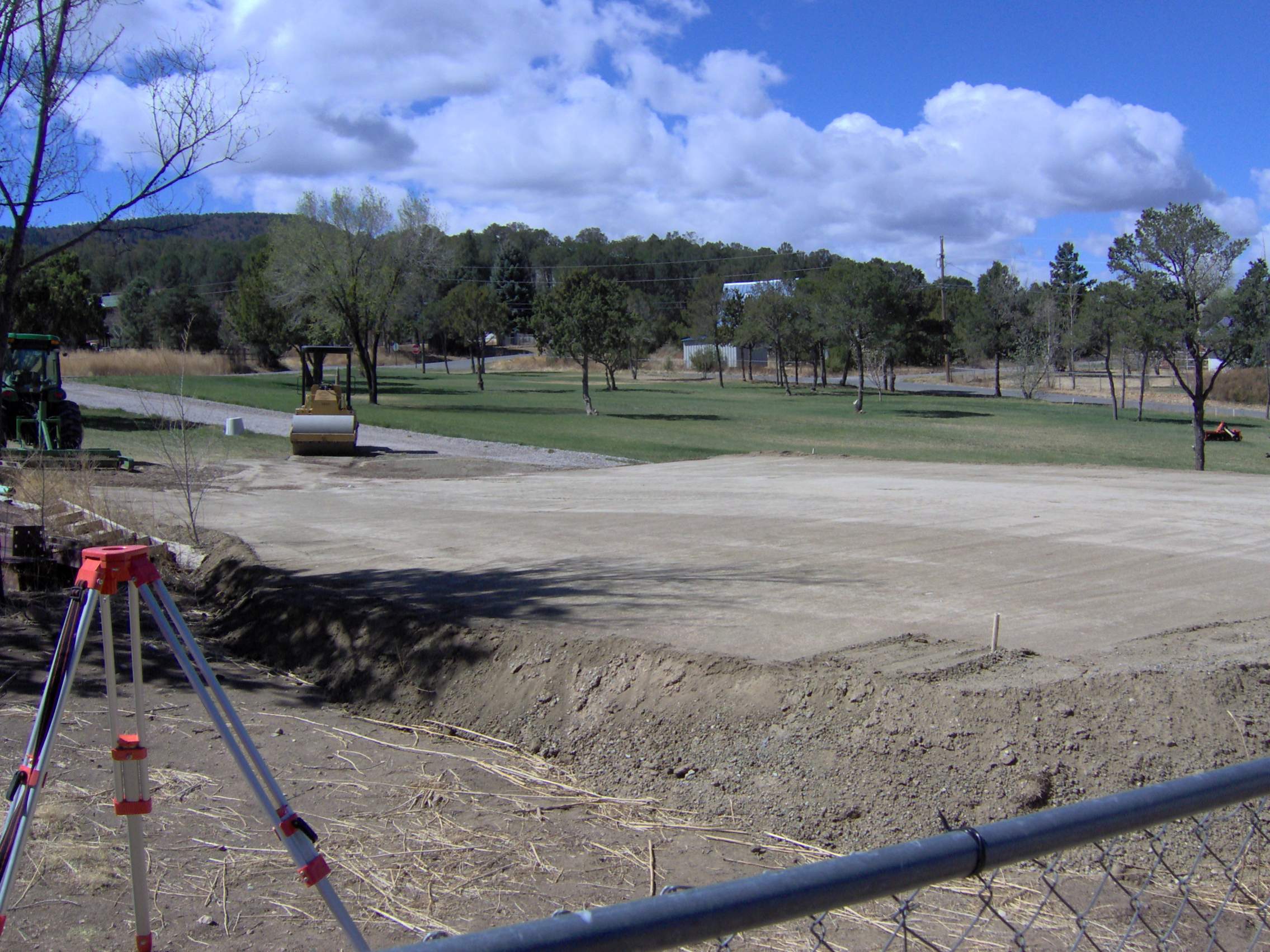

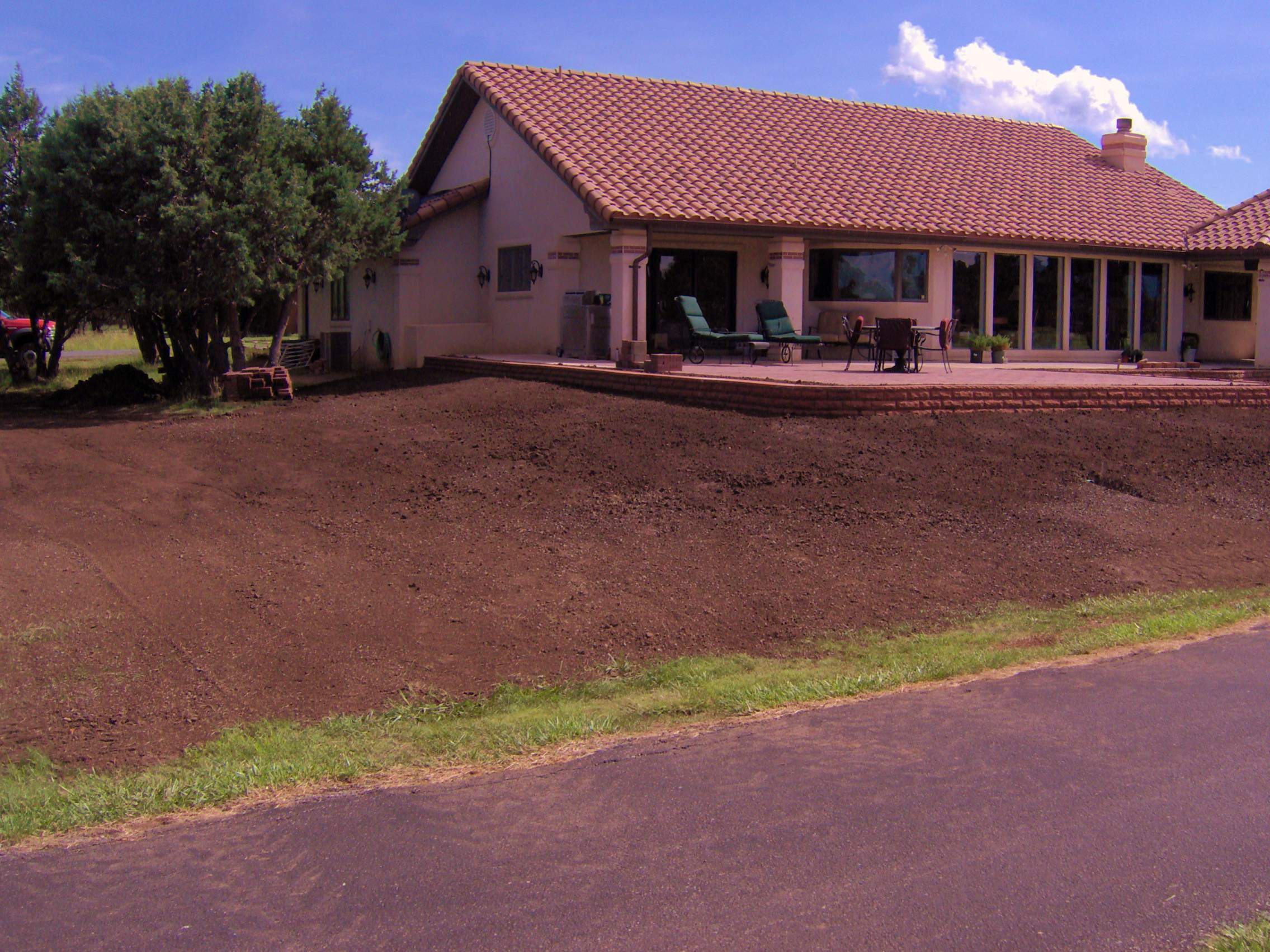

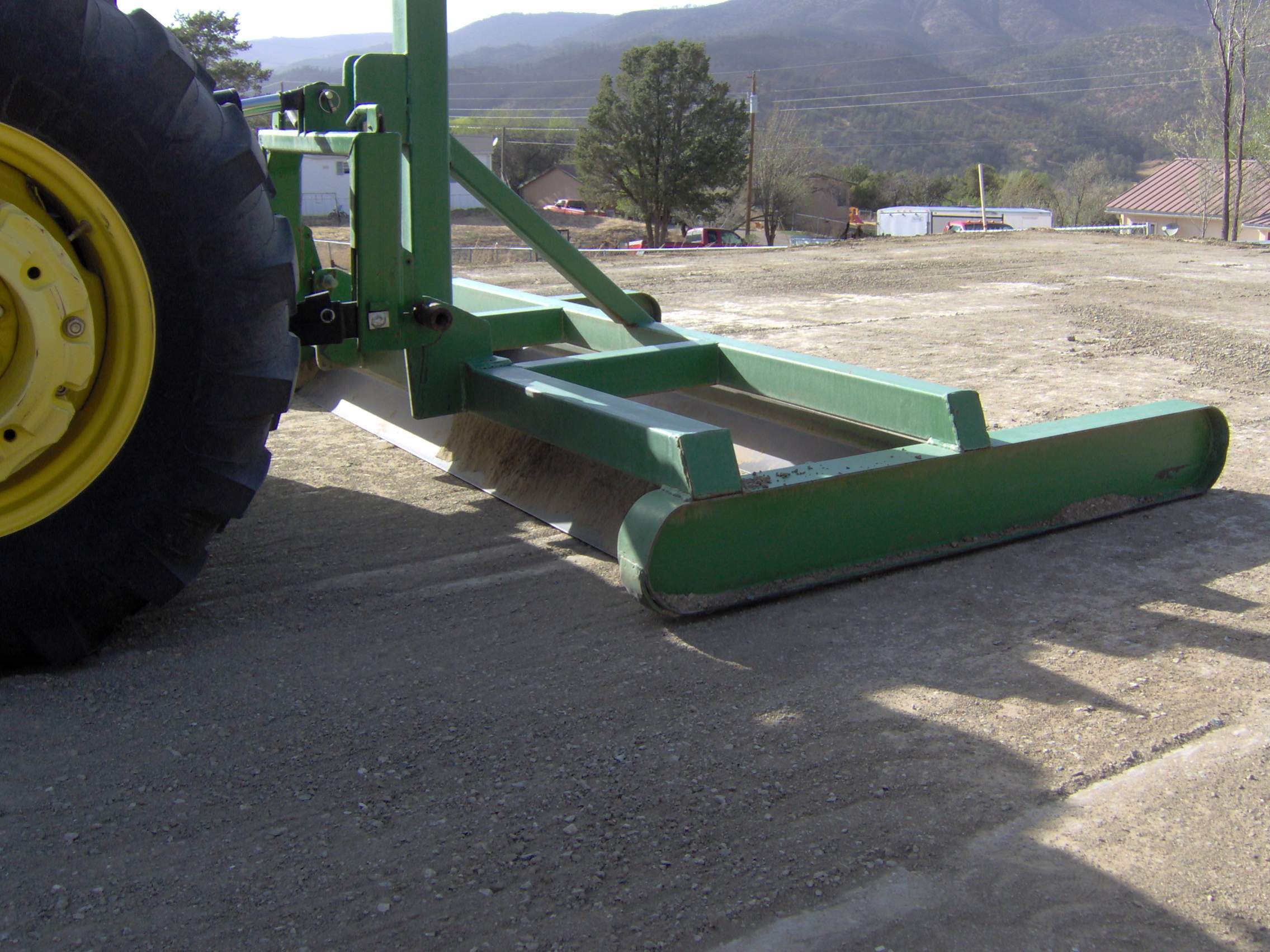

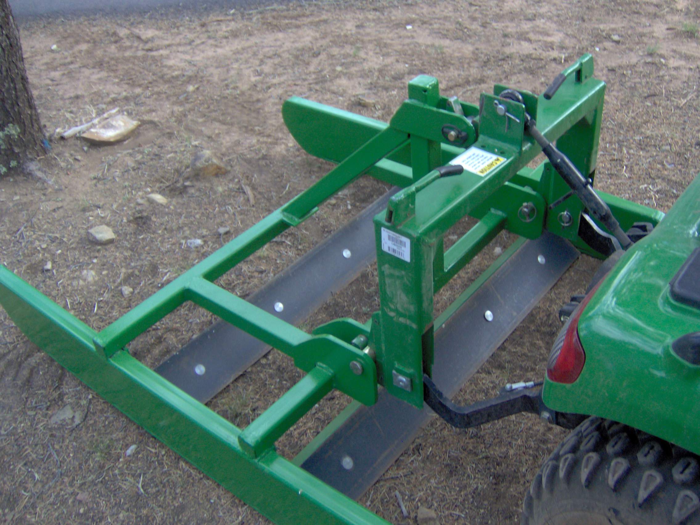

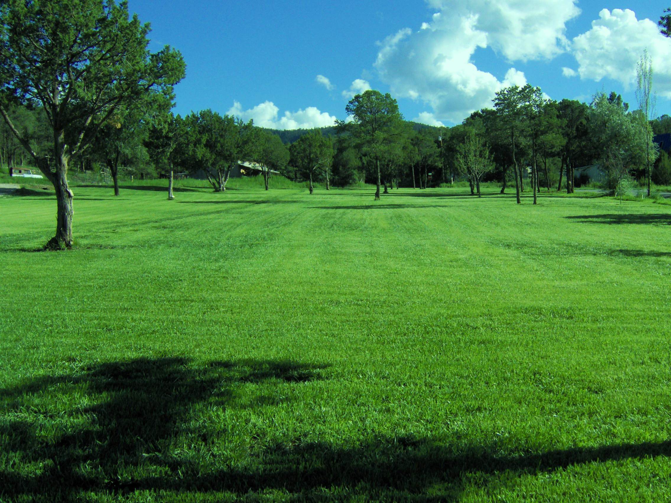

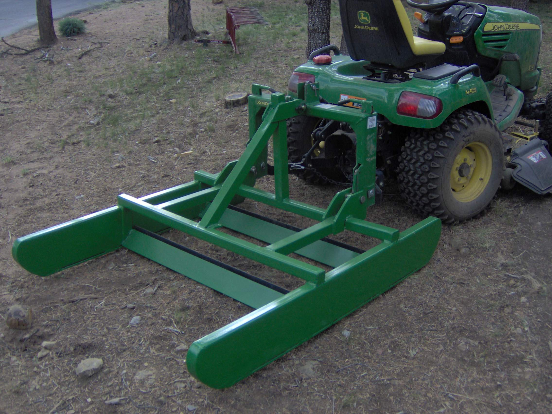

Here are the two I built with some pictures of various jobs I used the larger plane to do. Seems to work well for lawn smoothing, slab leveling and driveways with blades set flush and straight. When I built the patio on the house it originally was with more drop and the HOA wanted the concrete wall hidden. Added the retaining wall blocks and tapered the ground away from the patio extension. Gotta love the HOA's.
Something to consider when building a landplane is it needs to be very rigid you don't wan't it to flex or twist. I would use either good pipe or square tubing for the cross members. I rolled the ends together on my skids to allow them to roll over the ground easier and to stiffen the beams preventing bending or flexing length wise. You can use stiffeners instead if you prefer. I have had good success with the ski shaped skids on the smaller 4ft plane, rides over everything without hanging up and doesn't hold all the gravel the wide flange beam styes do. Dropping gravel on the grass or road is a pita.

Nothing wrong with the WF beam you are using imo. Just to clarify that isn't an I beam if it were it would be 40 to 50 lbs/ft with tapered flanges.
Might try to find some 4x4x3/16 or 4x4x1/4 box tubing for the frame, much better than using angle iron. Second choice would be 3x3x1/4 box tubing or 3 to 3.5 extra strong black pipe. Tubing resists twisting much better than angle iron so your skids maintain proper alignment. As long as the cross members are large enough bending isn't the issue here but flexing can be.
For the ends of the skids you could turn the edges up with a 3" radius bend and fill the balance in with a 10" piece of flat bar and not loose much for the skid lengths. Your 5.5 ft pieces for the skids would still wind up being about 5' 2 1/2" long end to end. That works out to 1.72" to round over each end and well worth it imo.

Yea its a wide flange beam not most people know the difference good call. 4in box 250 wall min 125 wall for the supports and 4x angle 3/8 for blade mounts.
