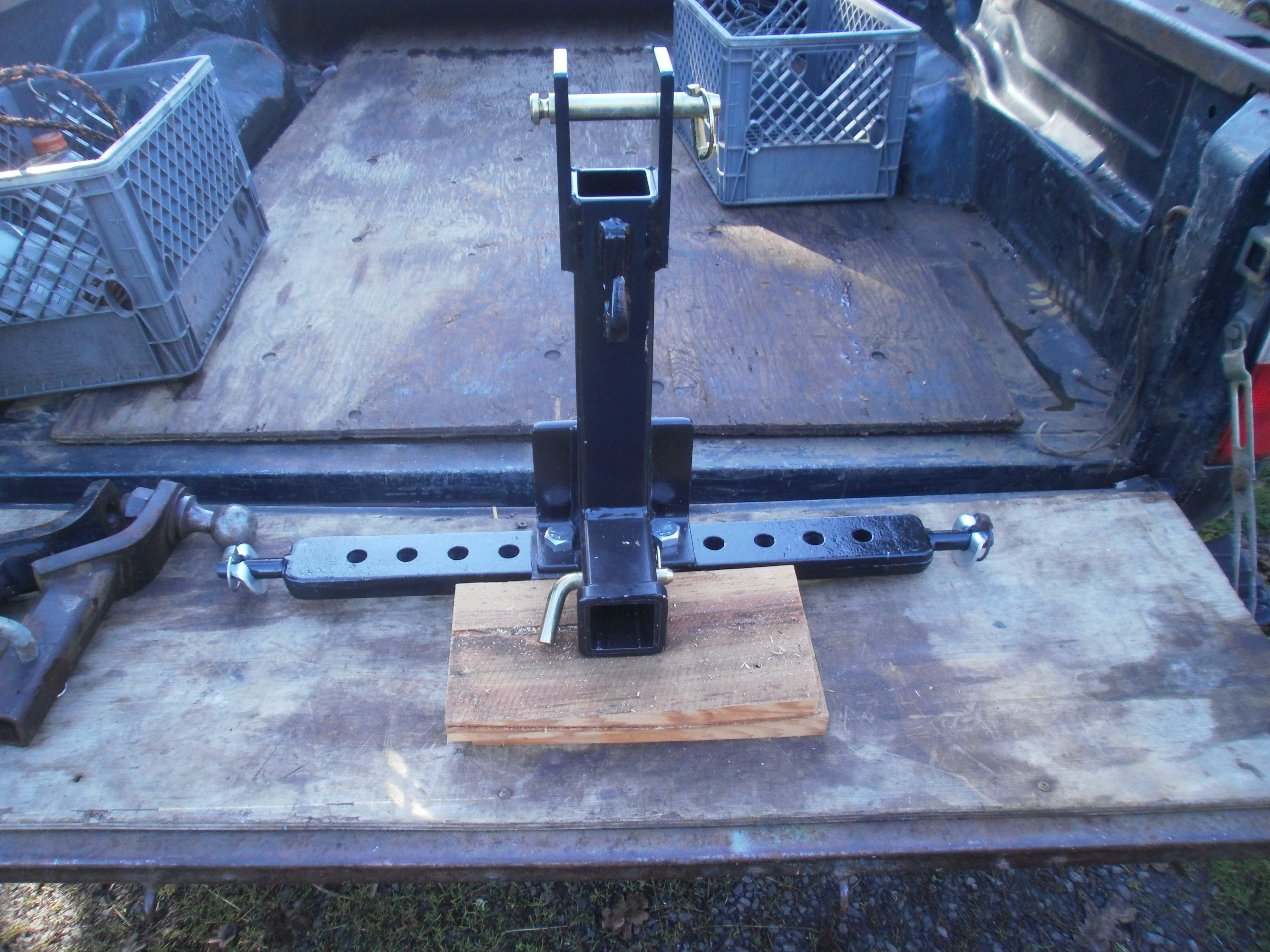

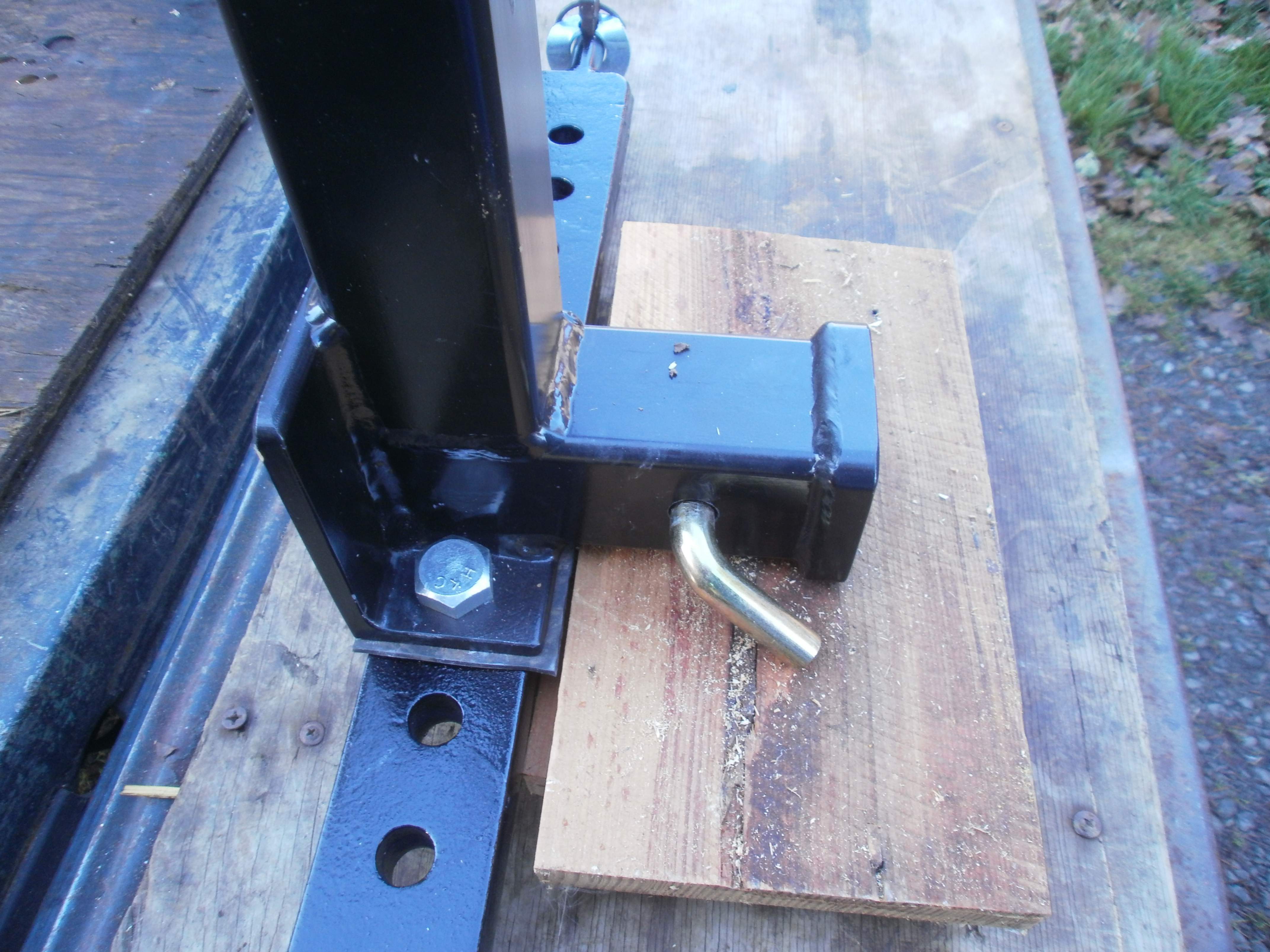

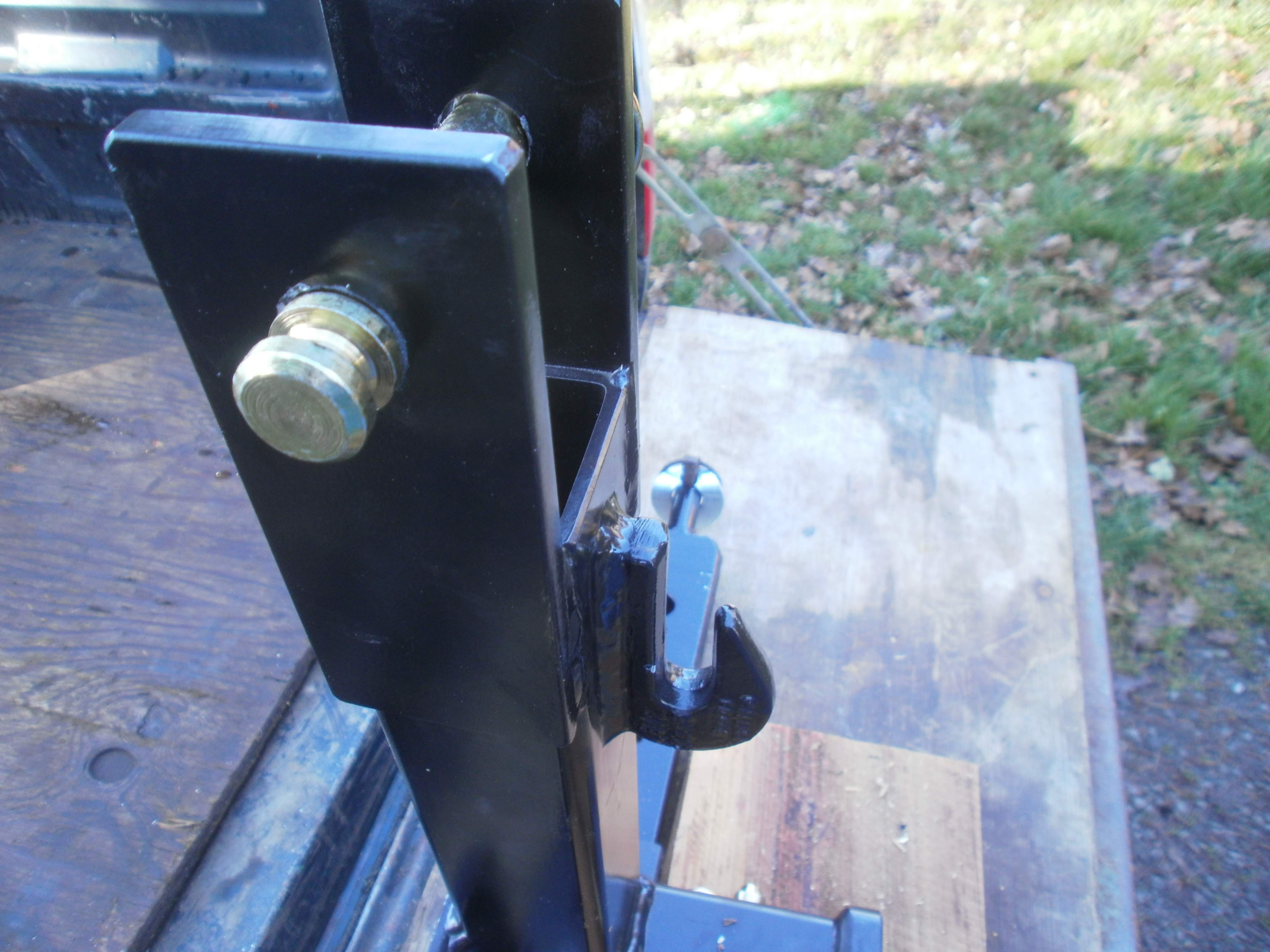

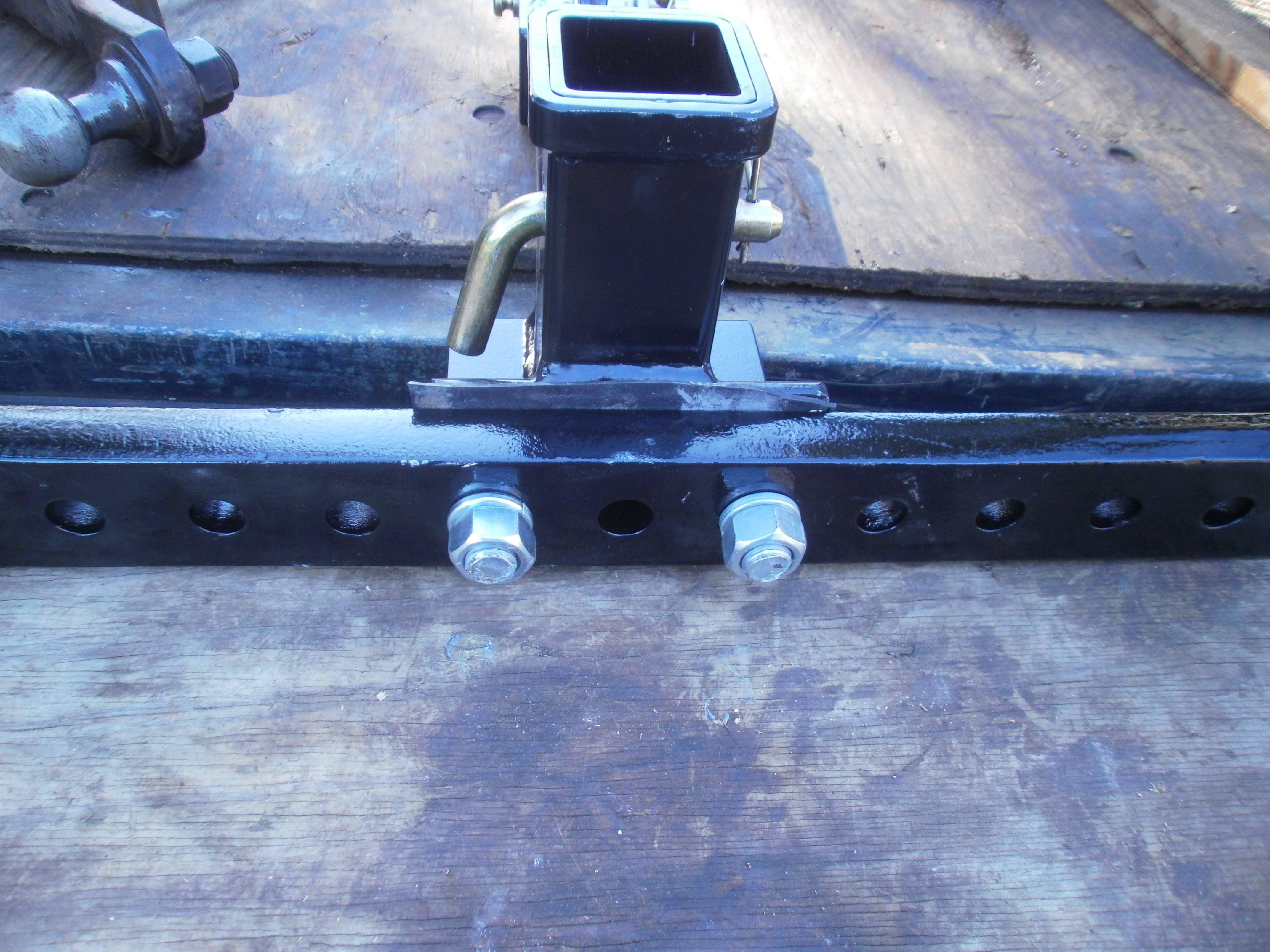

I ordered a a black Omni Heavy Duty drawbar hitch assembly that has the grab hook welded on it. I could not be happier with it. I have it mounted on an OLD USA made heavy drawbar that isn't bent up. The holes match perfectly, I sandwiched a gasket from truck innner tube between the two pieces. The hitch is USA made, painted with finished fabrication. welds are nice, corners and edges rounded. It came with two bolts,nuts, washers, a top hitch pin and a receiver pin. A first class attachment that I am glad to have. They get my vote. It is **** for stout.

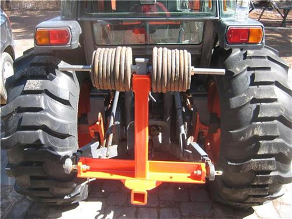

ya want pictures eh, well by golly here ya go
/ Omni Transformer vs Heavy Hitch #11
It makes a nice fit when you are bolting it together. Cast bar has a bit rougher surface than rolled steel. That's the way I like it uh huh.

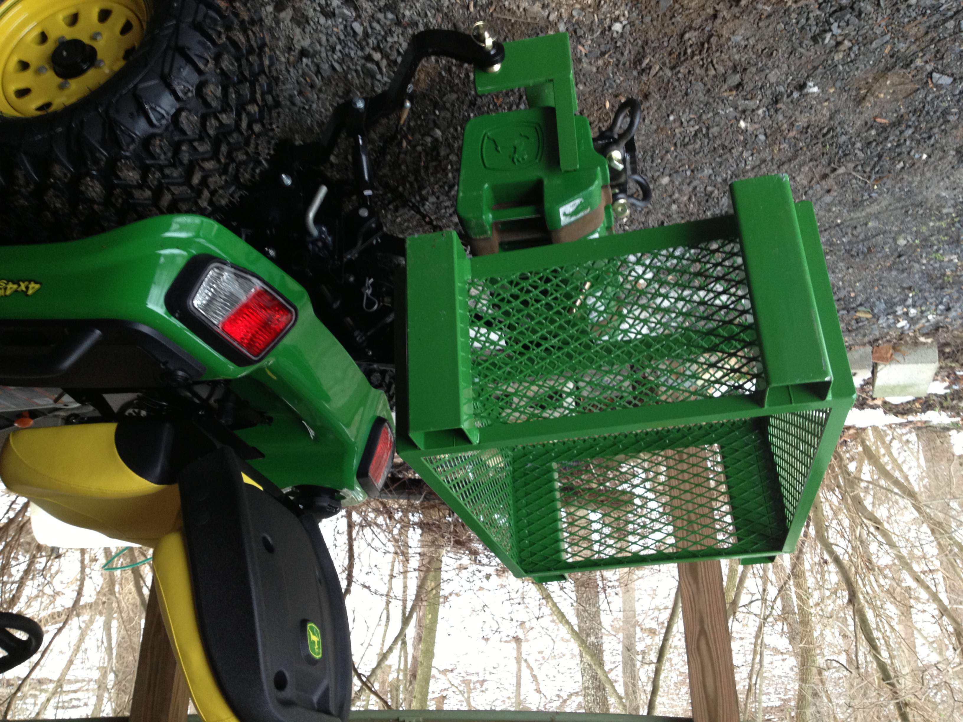

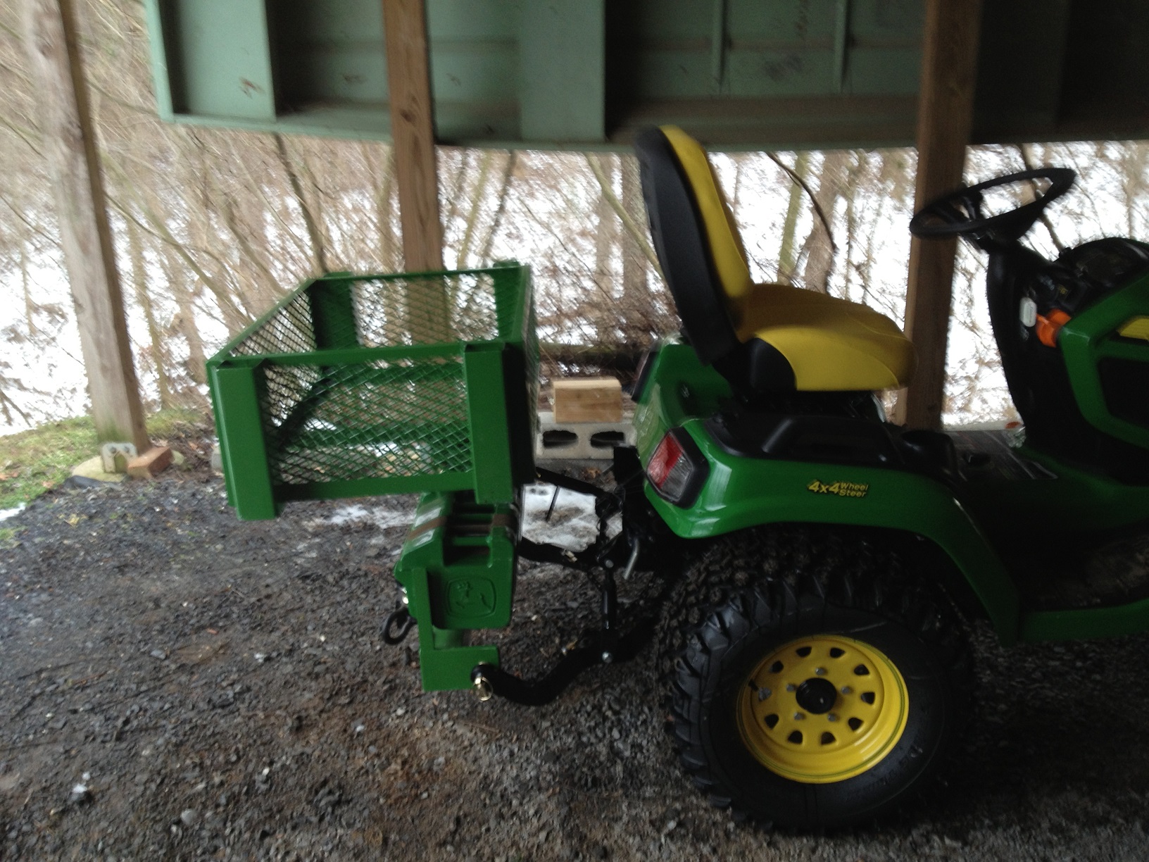

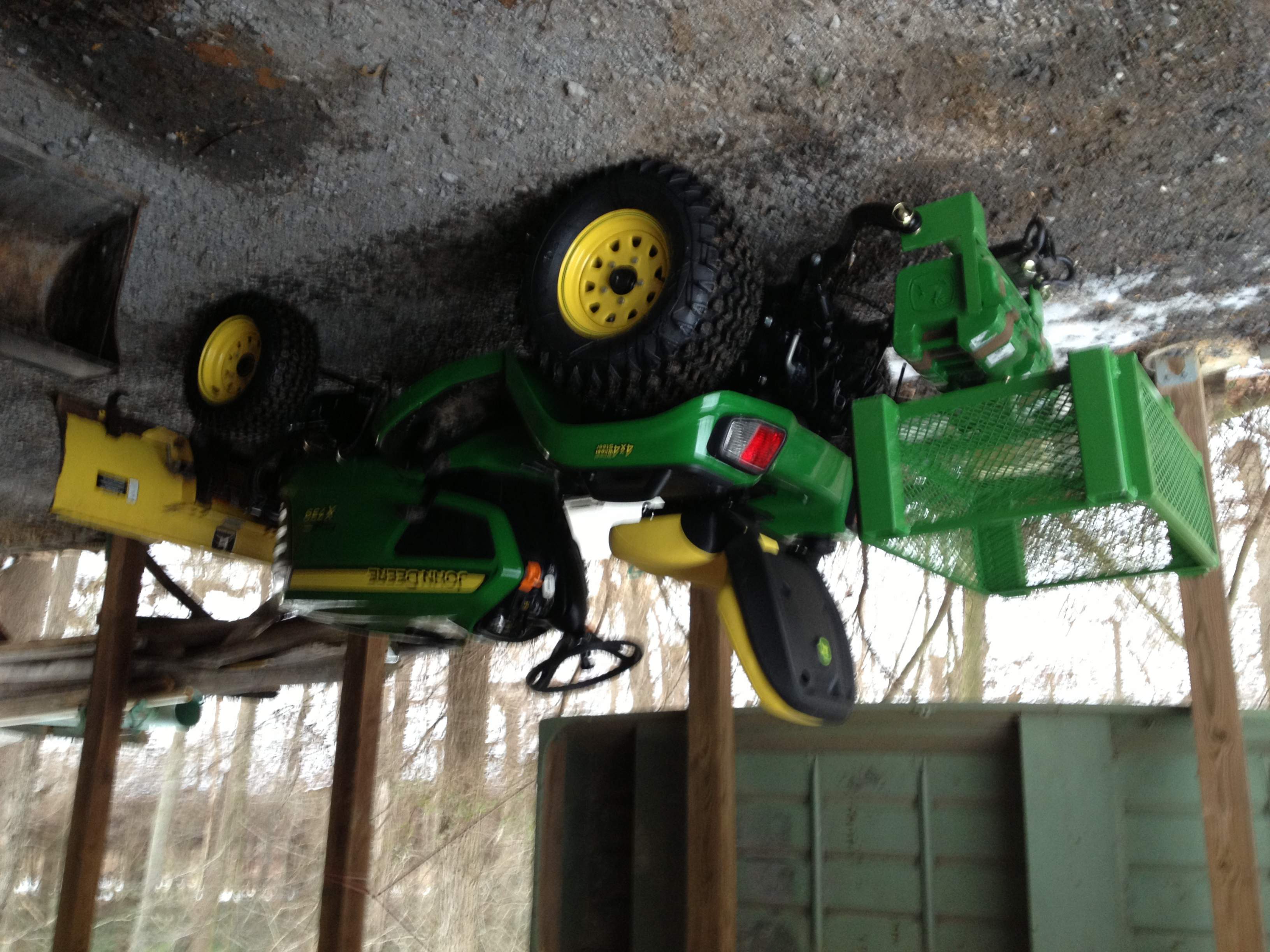

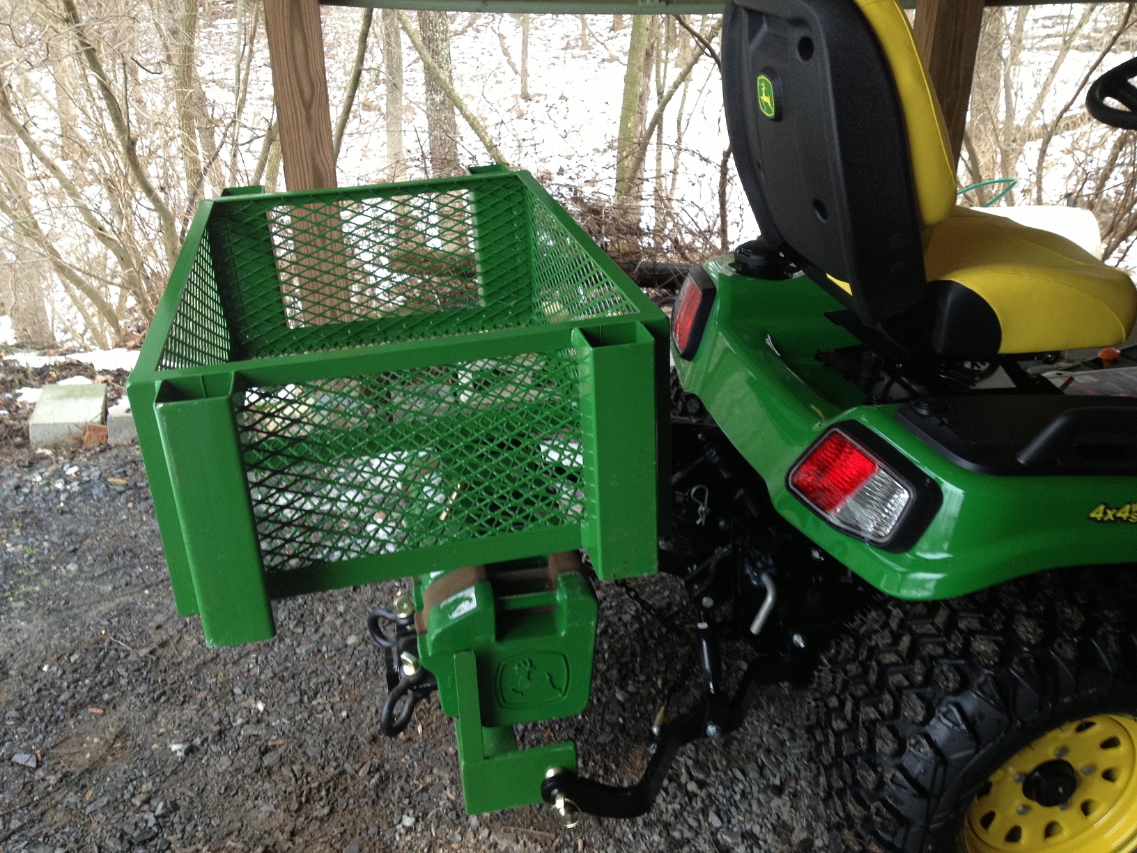

Well it took all day, but I finally got the 3PH hitch installed on my new X739. What a PITA! Then I installed my Omni hitch :)
/ Omni Transformer vs Heavy Hitch #15
Don't know why they are upside down. Edited and try again:
/ Omni Transformer vs Heavy Hitch #16
I have an Omni combo unit for my BX, it's a super nice, well fabricated piece for reasonable money.
/ Omni Transformer vs Heavy Hitch #19
I understand that the rubber is to help match up the two surfaces better, but under heavy loading it may lead to loss of preload in the stack. This is not good for a bolted joint and should be avoided. Can you take a grinder to the uneven surface and flatten it out then shoot it with some paint and bolt it back without the rubber? That's a nice looking hitch adapter and I'd hate to see it come loose on you while you're working it hard. ... and do it the very best you can.
