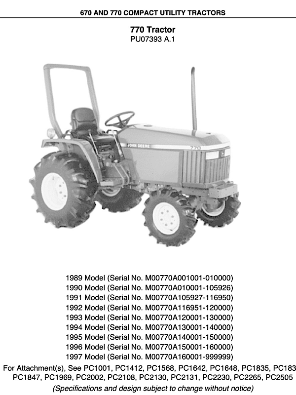

P.s. my comment about the "Old version" is referring to the vin number ending number.
#M0070A001847.
What year of tractor is mine?

/ Old version Jd 770 won't start. #5
Check with your Deere dealer, or search for JD shut-off solenoid
From JD parts
Don't see a split for serial number you mentioned.

Recheck that serial number, kinda looks like you have a 70A loader serial number, not the tractor one. Tractor serial number is right above PTO on rear should be the below format-
