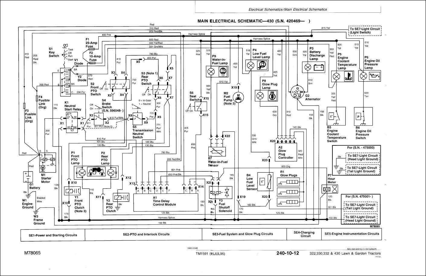

Do you have a wiring diagram?
If not, here it is.

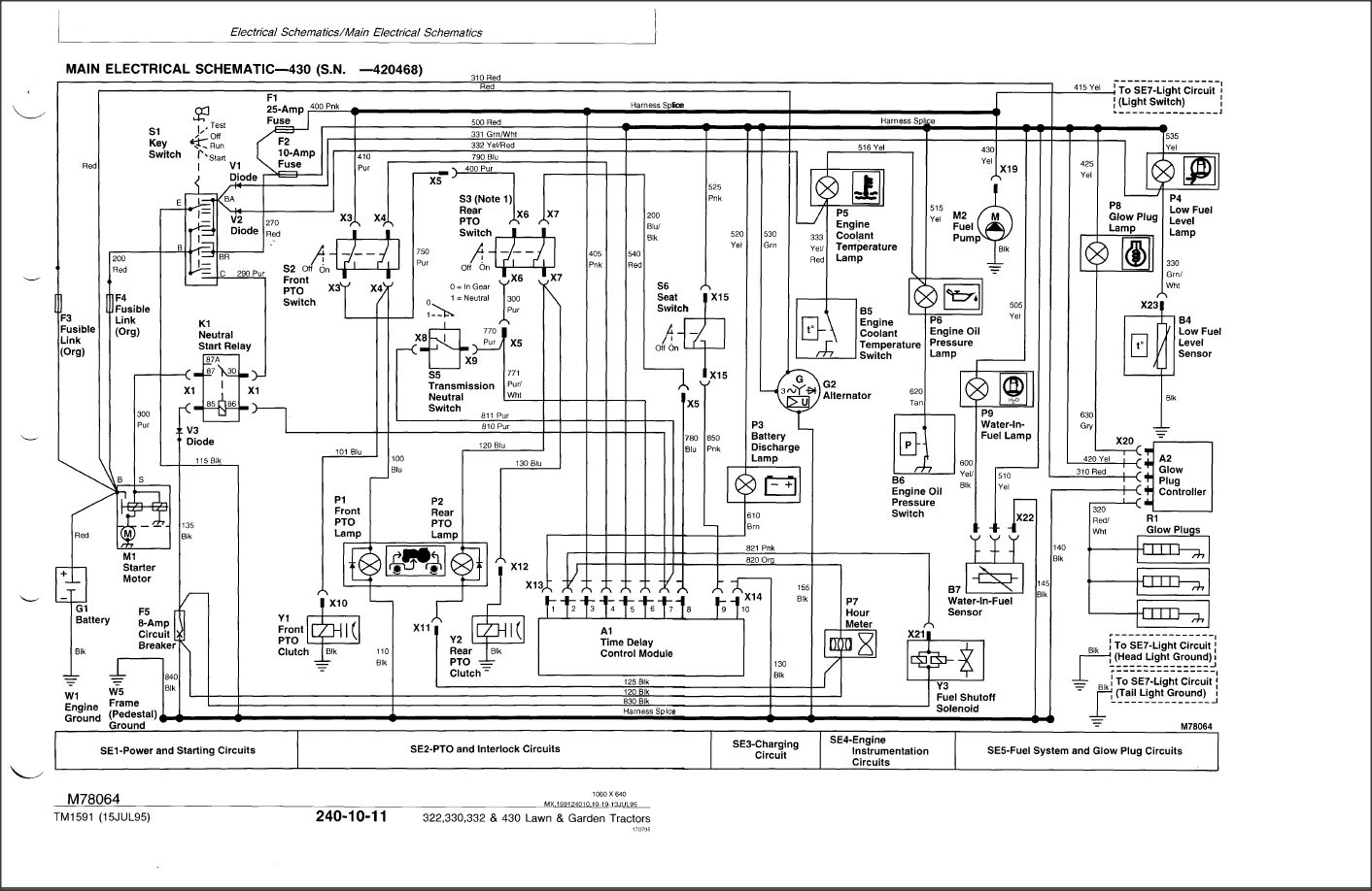

So I tested the battery last night. Fully charged. Didn’t even flinch when I load tested it.
I do have a service manual with wiring diagrams although the one BravoXray shared seems to be different.
/ JD 430 not starting #6
There are two wiring diagrams in TM1591 (15JUL95) depending on serial number.
