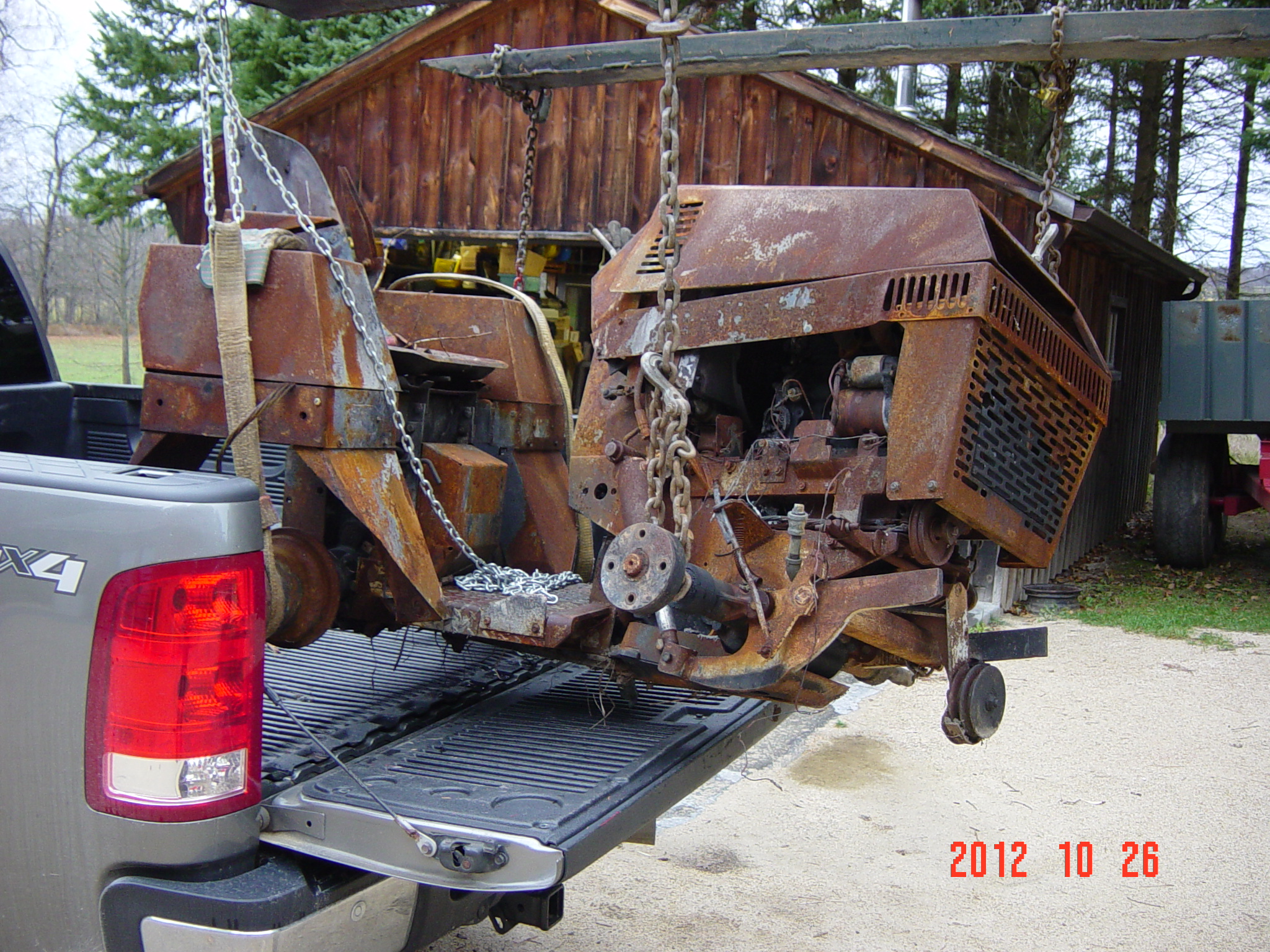

   / Old to Me, Steiner 230 questions #45
This poor machine just tried to push a bon fire when the oily hoses (and fuel line) going thorugh the articulation point caught fire. By the time the FD got there, this is all that remained. Gave the engine to a friend recently to try and recover components to repair a small NH skidsteer, but there didn't appear much useable in the engine.
I DID luck out, because I bought a (GREAT) Gas, Kubota 430 MAX at auction for the V-Plow only and didn't realize it was missing the front PTO assembly, so this donar machine saved the day.

#46
That's sad. Glad a few parts were salvageable.
I just found out the 230's drive shaft that connects between the Kubota diesel, and the hydraulic pump, cost $728.89 :shocked:
I hope mine is OK, I know that one of the bolts through the rubber coupling is missing. Better fix it before it gets out of hand.
