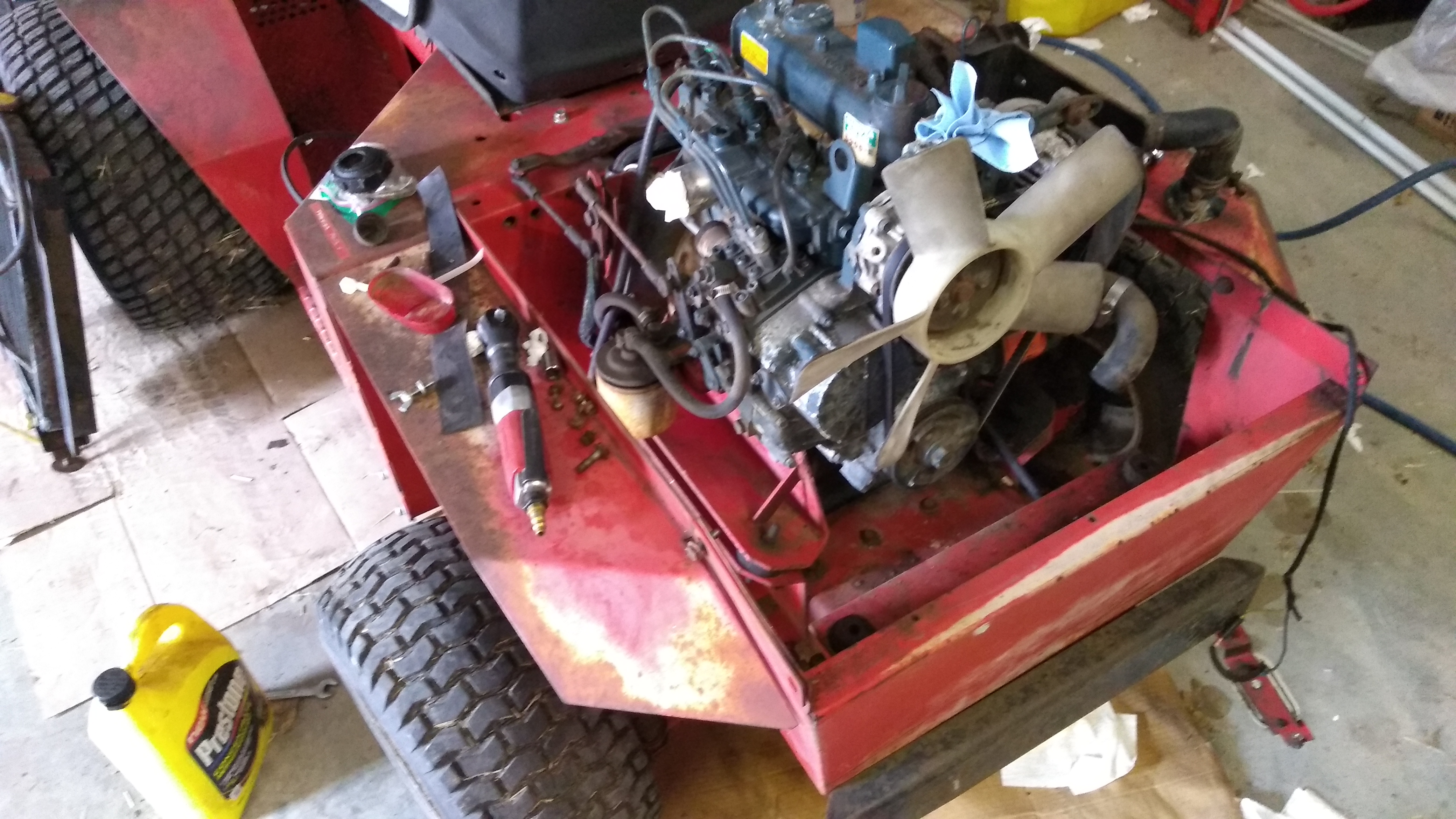

The Beast's kubota D905E temp runs on the hot side, seems many kubotas do.
I took all the panels off the rear engine compartment, and took out the radiator. I cleaned thru the fins, they weren't clogged that bad. Previous peeps had removed the thermostat. I've ordered a replacement. Still waiting. I took the radiator to a shop. The guy told me that it seemed to flow just fine. And that he could take it apart and rod it but could easily damage and ruin it trying. So I told him not to and could he boil it. He said he doesnt boil them anymore.

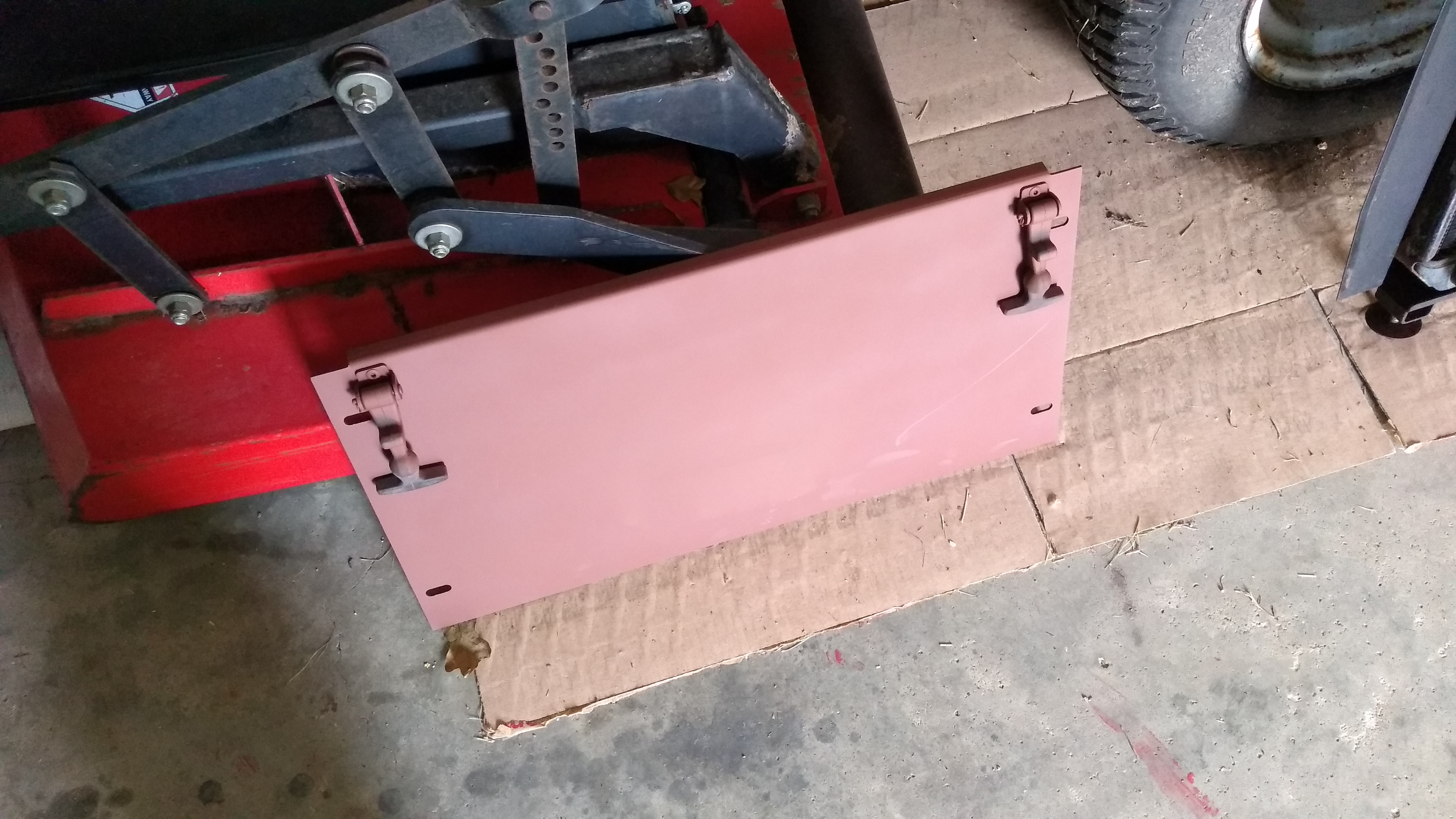

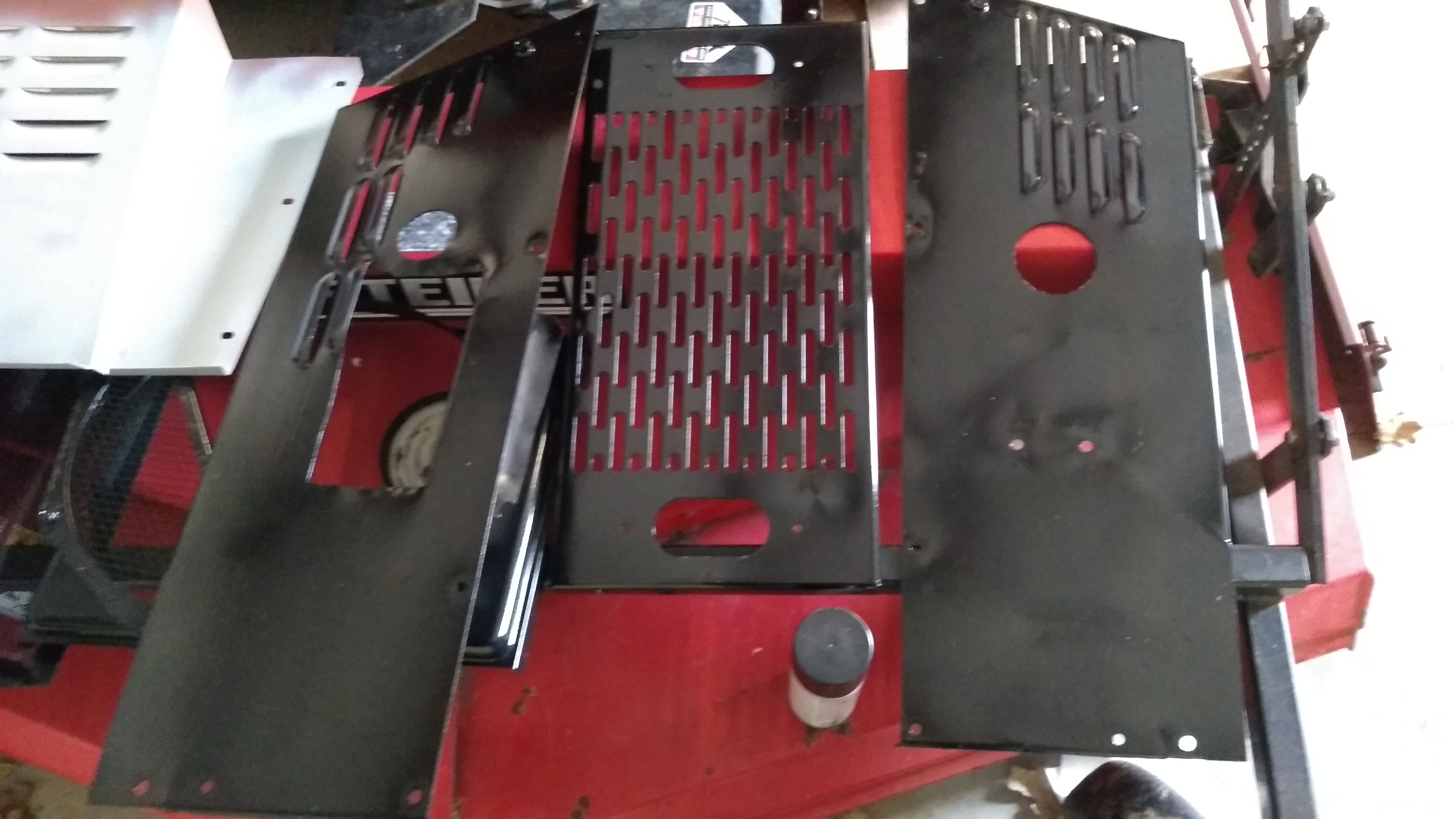

So while I'm waiting on the thermostat, I decided to do a little body work and straighten the engine compartment panels, prime, and paint them.
I bought a fresh belt for the engine's fan. The old belt was stretched and loose, beyond what I could tighten (adjusting the alternator outbound). So, maybe just a belt will help it run cooler, if the old one was slipping.

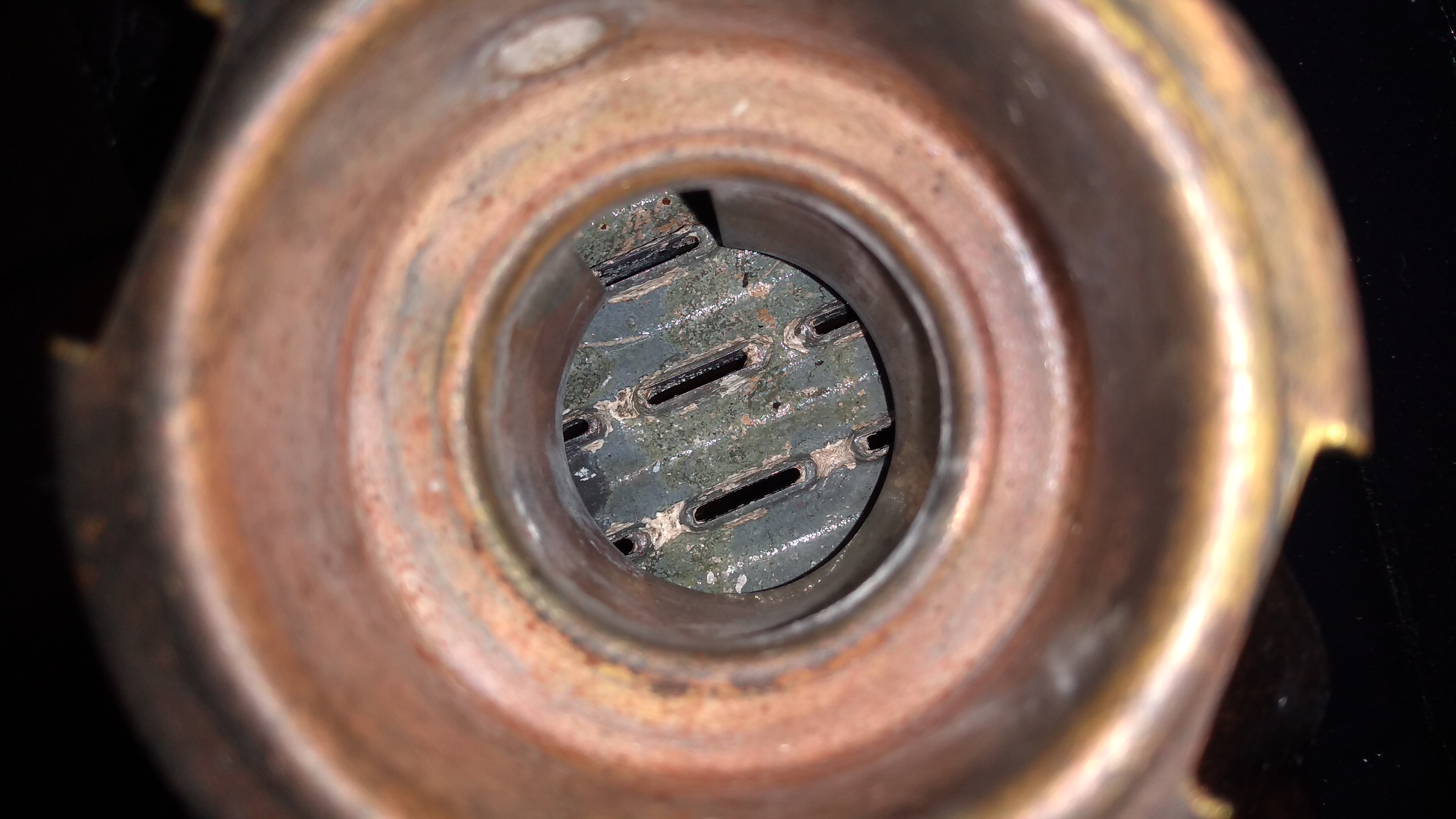

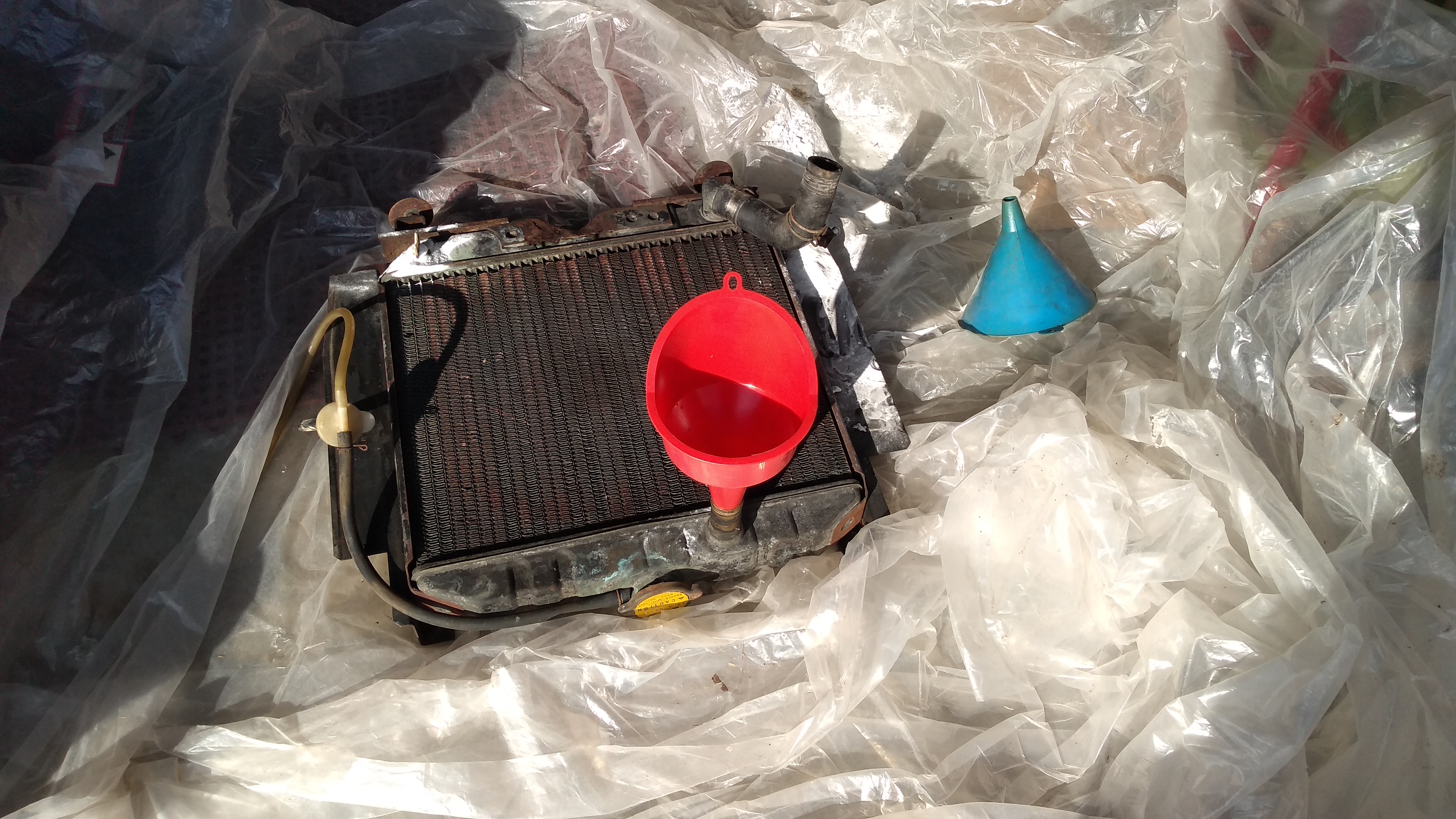

I will attempt to boil the radiator out with muriatic acid. The radiator is brass and copper. I talked to some chemist friends at work and they agreed that a 1/3 acid, 2/3 water ratio sounded about right. So I'm going to put the acid in the radiator for about 5 to 10 minutes and agitate it to get it to hopefully remove some of the scale buildup. I will then flush it by mixing some baking soda with water and running it through there before installing it on the machine. I was hoping for warmer weather, to boil it out to improve the acid's action, but the chemists said be careful, each 10 degree rise will make the acid attack that much more. And they said the chlorides in the acid will attack any cracks or imperfections MORE than they will attack the flat surfaces. So, BE CAREFUL.
View attachment 682550View attachment 682551View attachment 682552

Boiled radiator today. It was cool today about 54F, and I left the acid in it for about 15-18 minutes. Looks like I could have left it in for another 10 minutes.

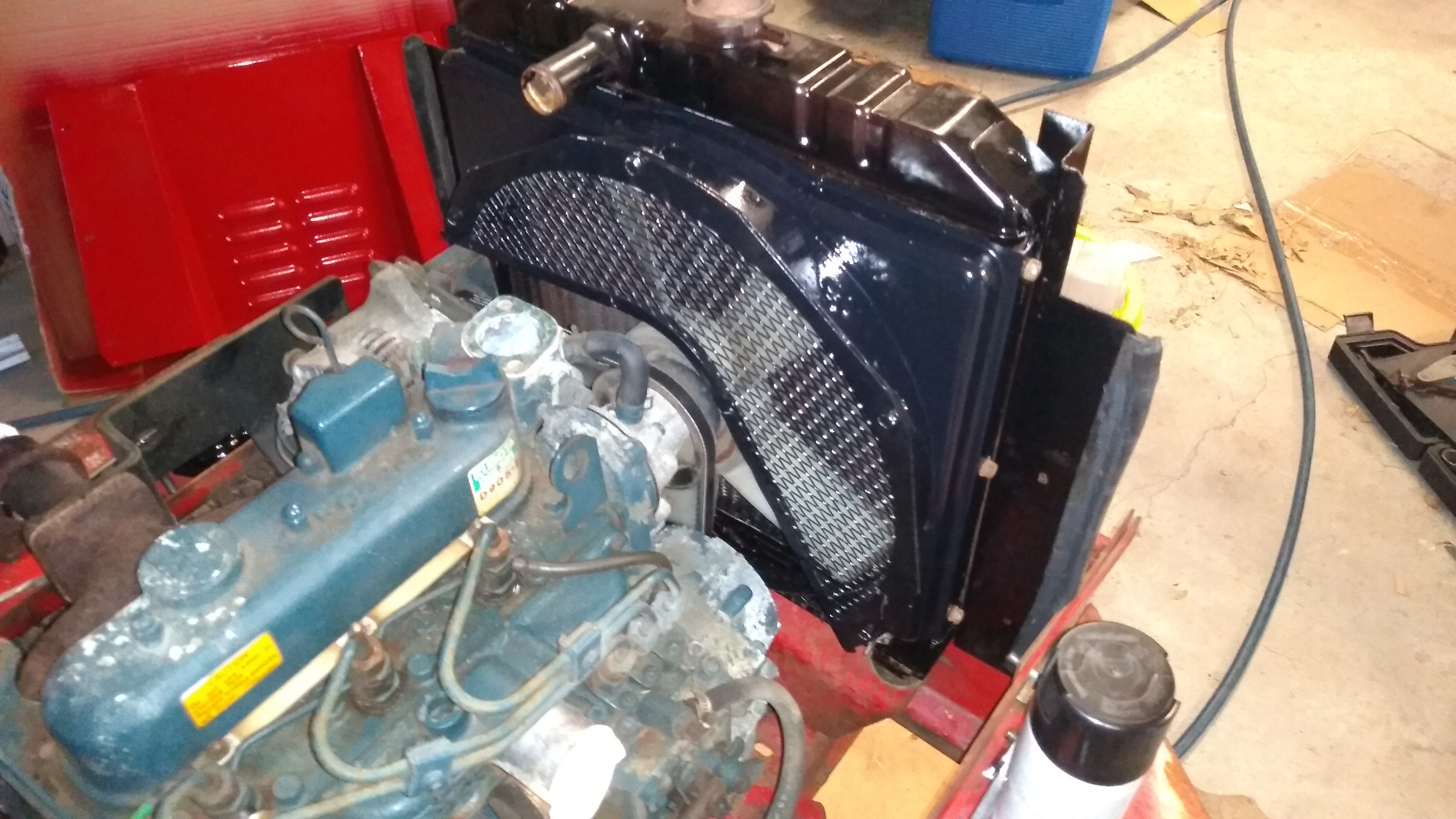

I went ahead and started mounting it back into the beast.
