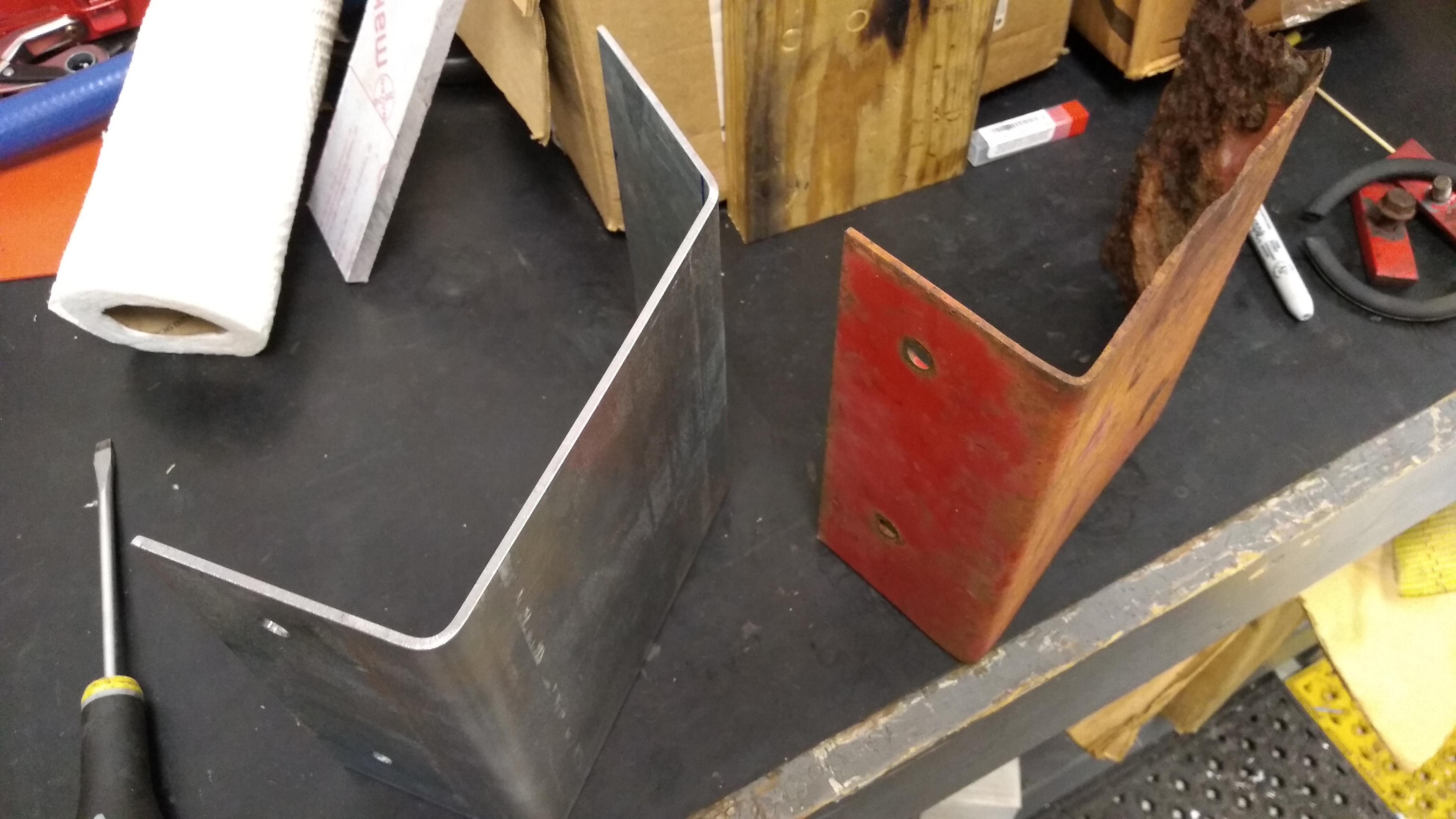

The Beast needs a new front grill. A new one costs about $200. So, I have a sheet of perforated aluminum at work. I might bend one up, but the sheet I have is kind of thin, I wish I had a sheet a bit thicker.

Sounds like excellent progress. Any pics of the old and new front girl?
