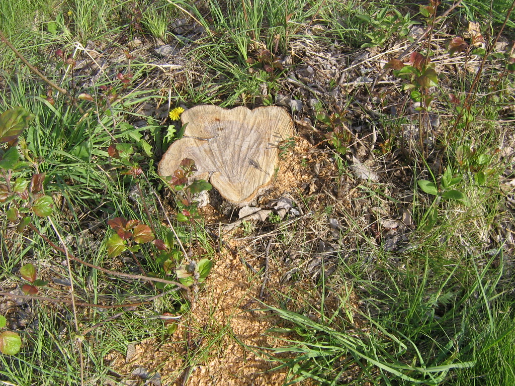

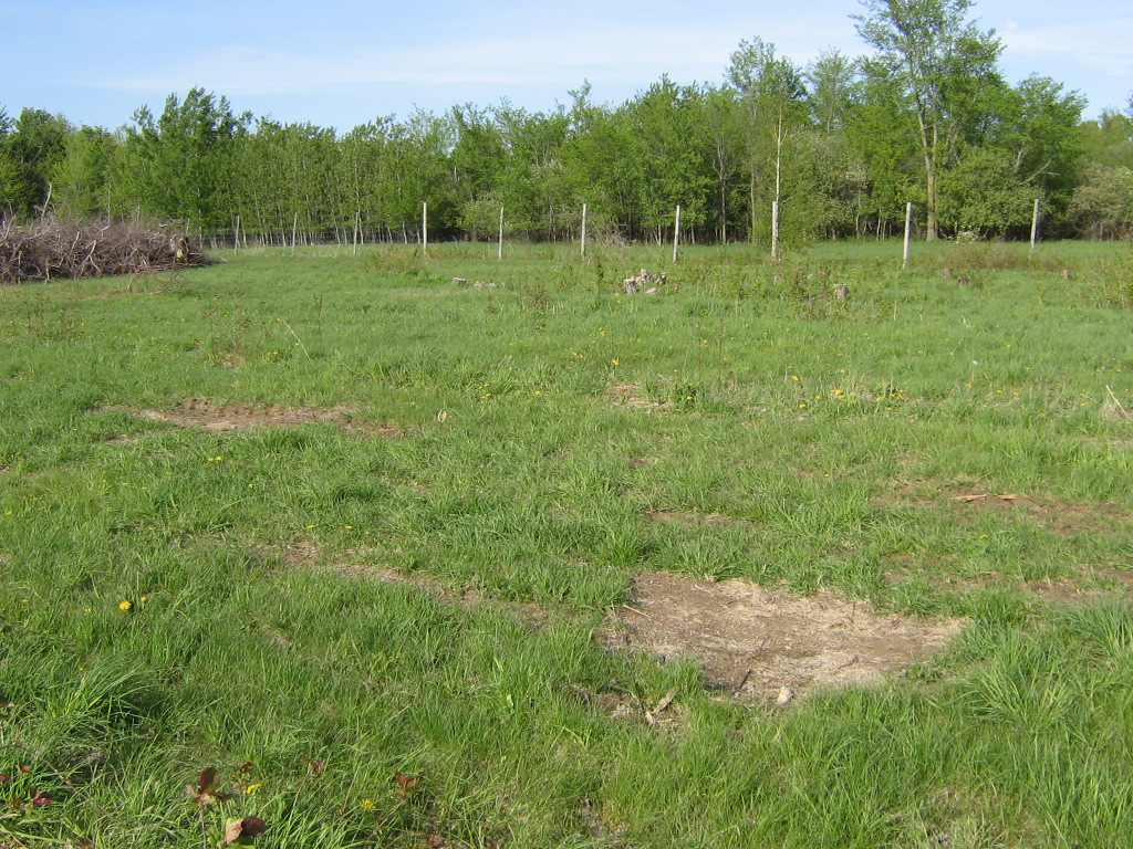

For those of you who are wondering how my orchard removing operation is doing is the update: all the trees are in a firewood pile exept for the smaller branches. I must have about 200 face cords to stack now. I pushed all the branches in a few big piles of branches with the FEL of the tractor. I am planning on buying a PTO stump grinder to get the stumps a few inch below the ground surface. My only problem is the big pile of branches. I am trying to find someone who can cheaply turn them into chips. If it cost too much I will burn them this coming winter. I have to tell you that it is not an easy task to turn apple trees into firewood. You have to have a sharp chainsaw chain and a good splitter.

I have to admit that is very impressive. That would be perfect for my stumps. I did not find much info on them besides that they are from italy if I recall. I don't know any contractor that has that setup near me.
