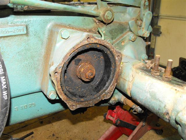

Just thought I would put this up. The brakes have never been under water since I cleaned and checked them about 3 years ago. Guess metal can rust to a great degree from just condensation and heat. This time, I'm going to leave out the drain plug in the bottom of the housing.
Maybe his tractor wasn't under water:confused:
I agree. Sealing a housing like that just invites that kind of problem.
