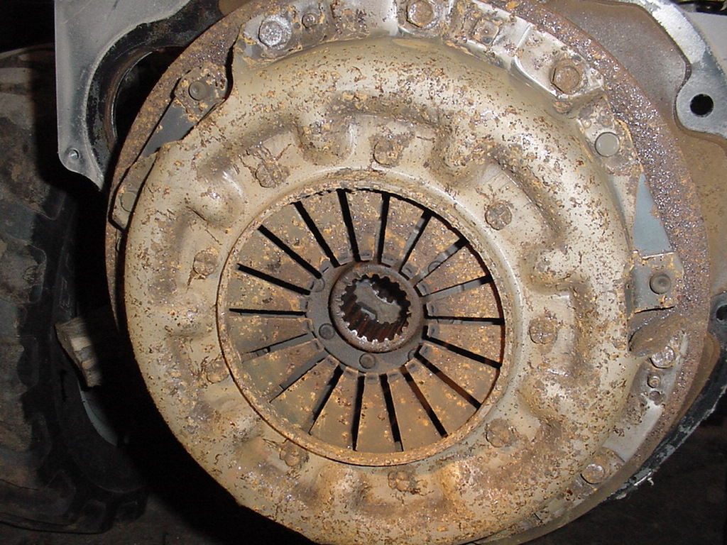

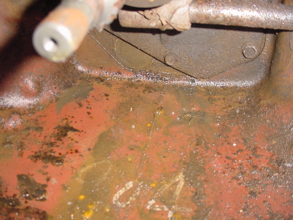

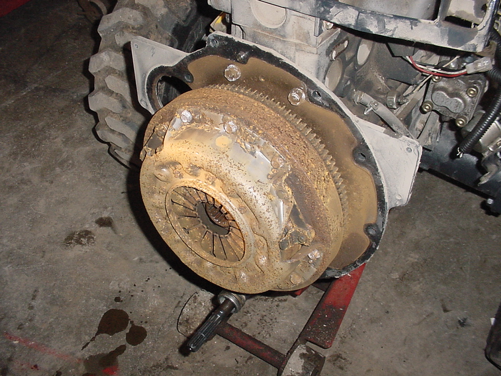

The tractor is 2 and half years old and the customer says he uses it everyday.It has 120 hrs on it, not alot for everyday use. I for one think its been under water. What do you think.

Sure looks like it...is he denying that it's been in the water?
Ask him if he's crossed streams or shallow creeks.

Unless it is stored in a very damp building, maybe. But I find that hard to believe.

Defiantly been submerged at some point, at least thats what i think.

I would say it's been wet and it was more than a quick dip. Any other signs of water in gear boxes or other hidden spots. Might pull a few drain plugs and catch what comes out first.

Ya-know He should be honest about it, It sure looks like Tractor has been through some high water or has been under some water at one time. Hard call maybe have him come to shop to view real time views of tractor after disassembly?

Yes im the dealer he bought this tractor from and im the one who sold it to him. He just bought new oil and hyd filters and all new oil about 3 weeks ago. He call my shop Tuesday and was complaining about the clutch sticking so we picked it up yesterday and spplit it this morning and that is what we found

G'day i would say that this machine has definately been a submarine, i would be checking the front diff/ final drives for water

Yes it was a new unit when he bought it. Yes I offered him the extended warranty but he declined it. I did check the front dif and it apears to have new fluid in it. He has already stated if we didn't fix it he was going to badmouth us. Ill wait and see what my rep says monday and go from there. If he says fix it then that willl be good although I don't see that happening. I will try to help the customer as much as I can but I wont eat the cost due to his negligence.

Not taking either side, but for sure can see why there is a clutch problem.

Its a MF1532. There are shipped from Japan but as soon as they reach port and are unload Massey goes threw them and finishes assembling them. When I receive them I have my guys go over with a fine tooth comb which involves pulling the plug on the bell housing and checking for water.
