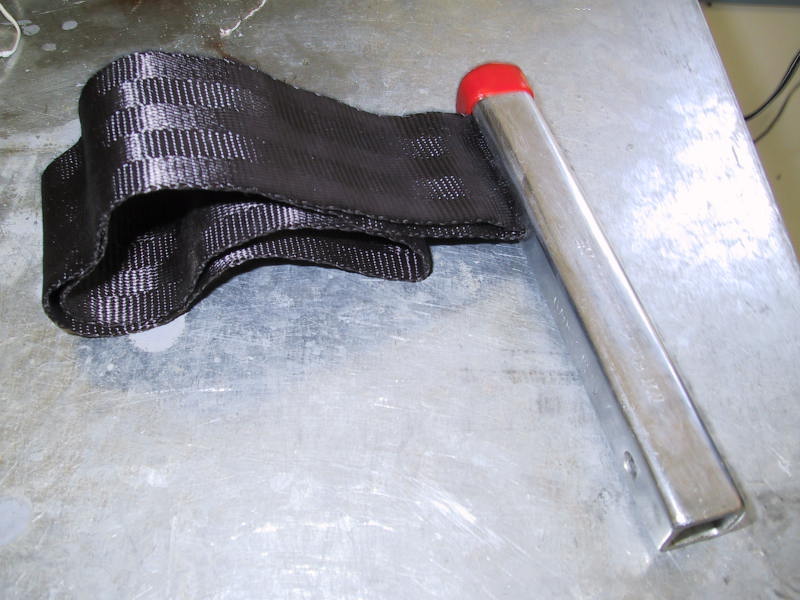

Sorry Mike, my apologies........ I just assumed that everyone here had the basic tools to service the tractor. Here is what I use. I purchased the band wrench at CAP (Consumers Auto Parts) and it works like a charm. Don't remember the cost, but if I had to guess, probably under $10. All the other strap wrenches in my tool box are for larger filters. I am a firm believer that if you are going to save the cost of dealer service, then you should at least purchase the proper tools to do the service. For those that don't know what size strap wrench to purchase, the Kubota brand oil filter is 3 1/4" in diameter. With this tool, you can remove the oil filter without removing the hood and side panels..... I am assuming, that almost everyone here owns a 3/8" drive ratchet and a 3" long extension to complete the necessary tools for the job. The oil filter is Kubota part number 70000-74034.

Here's the Tractor Supply Co. oil filter wrench I used - cost $3.85! A 1/2" socket wrench/extension can be used in the end, or a 3/4" open end on the outside. It works fine, but is probably harder to reset as the filter turns than the metal one shown earlier. My BX-22 took almost one gallon with the filter. I was on a nice level surface. I used Kubota's 15W-40, which may get changed to something else for the winter.
