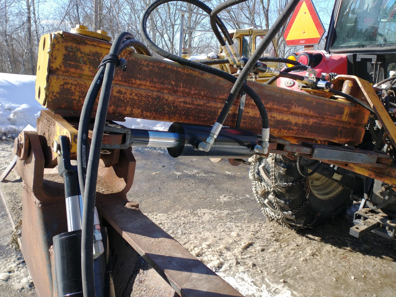

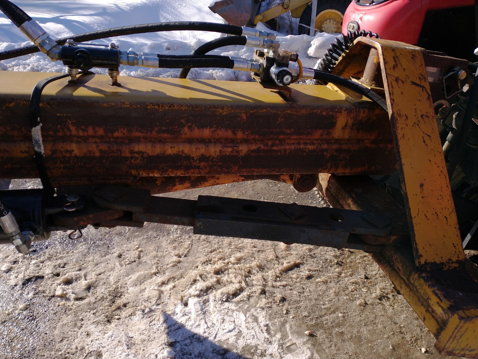

I was looking for the same features in a blade that you are. I lucked up and found a used Land Pride RB3784. I highly recommend it.
I have this same blade with hydraulic angle, very sturdy, haven't bent anything in 8 years! I highly recommend it also.
