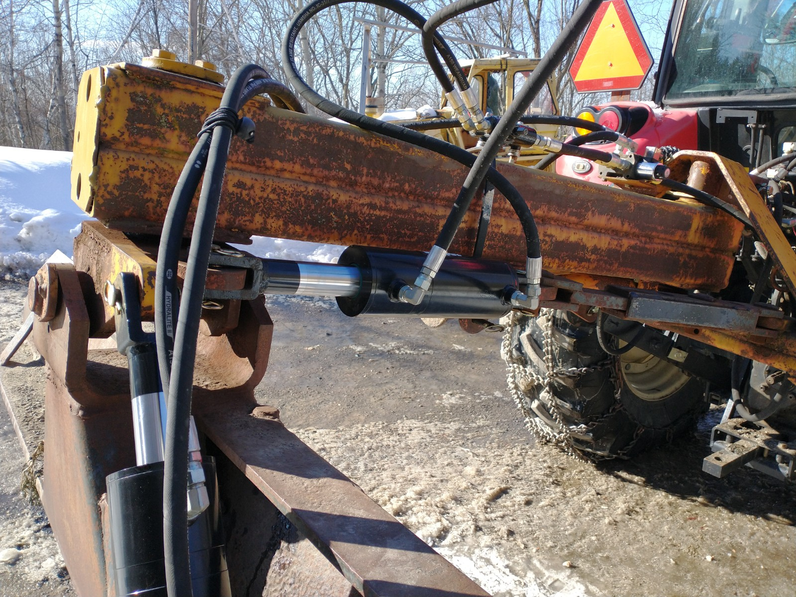

I agree EA makes a good looking blade but I didn't want to wait that long. I ended up buying a Rhino 70-07 and added hydraulic cylinder to offset it.
