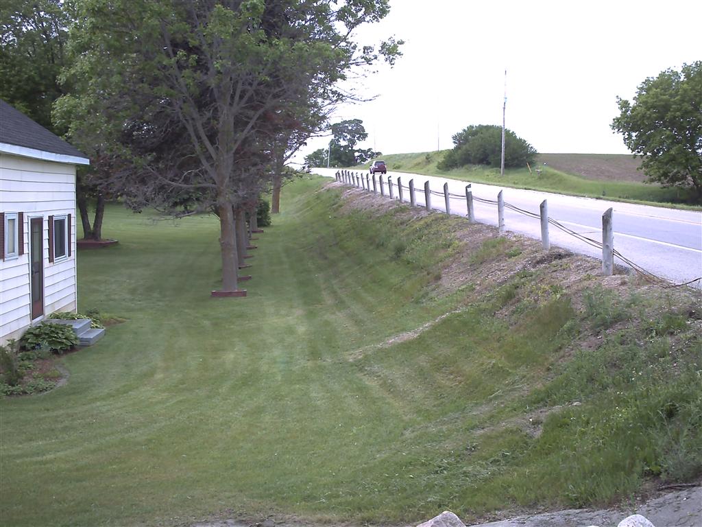

I also have an embankment on my property. Trouble is, it goes up to the road with a guard rail at the top......I am also a cheap SOB, so this is my solution...it also will go down into the ditches etc.
