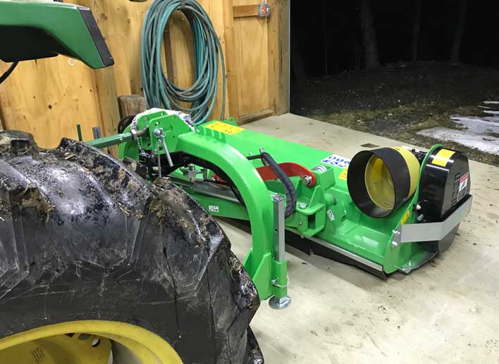

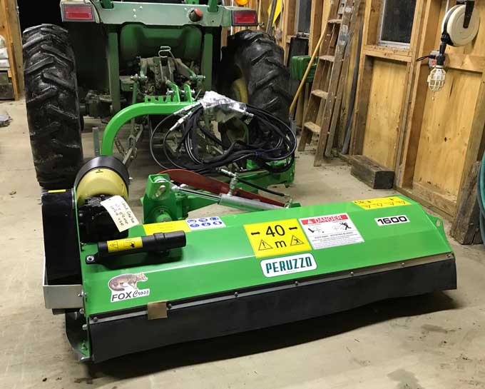

It arrived today. Not great timing, as the snow is only half melted and it didn't arrive until 5:00 pm as it was getting dark. Truck can't get to the house so had him drop it beside the road, and had to drag it off the liftgate with my tractor. Fortunately my neighbor came by with his side-by-side as I needed the help, and the lights, to cut it loose from the skid and hook it up to the tractor to cart it home.
Here's what it looks like once free of the packing:
Looks well made and nicely finished. They included extension hoses to reach my FEL outlets, with right-angle fittings and connectors, which I'll have to install.
Any tips on how to vet the air from the hydraulics?
It's going to be a while before I do much testing I'm afraid.

Thanks guys for the tips on how to deal with air in the hydraulics. It looks like the cylinders and factory hoses do have fluid in them and it's just the extensions the dealer put on that are dry, as I learned after draping the open hoses over my tractor overnight and finding oil on the floor this morning. It will be a few days before it's warm enough for me to play with it.

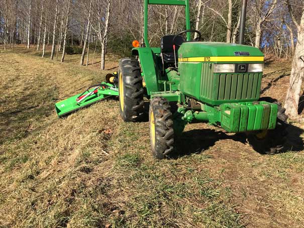

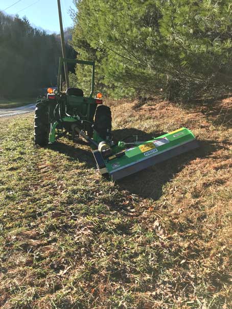

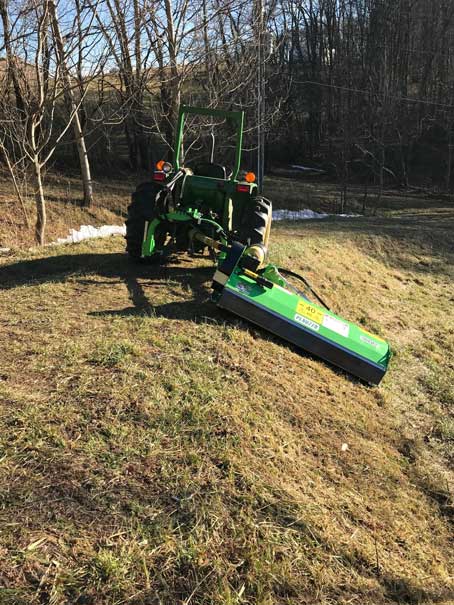

It finally got warm enough to put the mower together and test it a little. Figuring out which outlet was supposed to go to which hose was "interesting," but I lucked out and got it right the first time. I bought a set of JD color coded dust covers so it will be easy to connect them correctly again.
The tractor seems to handle the weight quiet well, though I've not yet tried it on the steep parts. I did extend the mower all the way and tried to see how much I could bounce it by putting my weight on the end of the mower. It seemed very solid even without the suitcase weights on the front.
Here's a couple of shots of it doing a bank:
It handles it nicely, even with my wide-set wheels. I'm sure I won't have any difficulty doing the rest from below. This bank has always been a pain - I have run the rotary cutter as close to the edge as I dare, then back up many times from below. I think I can now do it with two easy passes.
Here's a shot of doing the far side of a shallow ditch:
I'd given up mowing that with the rotary cutter since the trees have gotten to big to get the tractor up in there. I think I can get most of the rest of it with a second pass with the tractor straddling the ditch.
I think it's going to do well for this sort of thing. We'll see how it does with open field work once I have something to cut in the spring.

I have been using four suitcase weights with my RC. For this I bought two more to fill out the rack.
I didn't fiddle with the roller adjustment before this test, and I find it came set at the lowest height. There was no tall grass available - what I was testing on was mowed a couple of months ago with my RC but was not cut very closely because of the bank. I did find in one place it got very close to the ground and loaded up my tractor. I'm not sure that's a fair test. I clearly need to work on setting it to the right cutting height. The quality of the cut was super.
Beyond that, I'm very impressed with the quality of the machine. The finish is very nice. All the nuts you might have reason to remove are the type with plastic locking inserts. The grease fitting for the bearing for end of the shift inside the pulley has a hose to a fitting in location you can reach. The belt cover has a plastic guard on the edges where it contacts the end plate.
The only issue I've found is the plug for testing the oil level in the gearbox is behind the guard for the PTO shaft. I don't see how you get it out without removing the guard, which means removing the shaft first.
