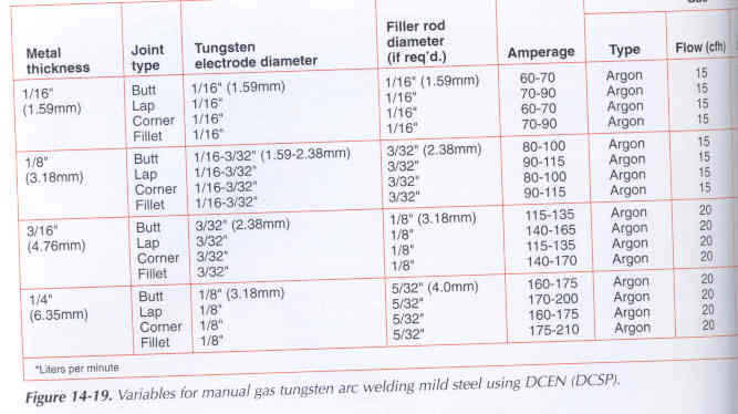

Charlie,
Here is a table from my "Modern Welding" text book. It shows the variables for welding up to 1/4" mild steel when using DCEN GTAW.
Good Luck!

   / Off-topic: new toy=TIG welder! #17
Great table. Thanks.

<blockquote><font size=1>In reply to:</font><hr>
3) You need about 1 amp for every 1/100th of an inch,
<hr></blockquote>
Dave a good post but you dropped a zero. Corrected this reeds: You need about 1 amp for every 1/1000th (thousandth) of an inch for steel or aluminum.
In general:
Start with 1 amp for each thousandth of an Inch of thickness (0.001").
For inside fillet welds, increase amperage by 30%
For outside fillet welds, decrease amperage by 30%
For steel and aluminum use this amperage.
For stainless steel, decrease amperage by 30%.
For copper, increase amperage by 100%.
For bronze, decrease amperage by 50%.
#19
Good post...you are correct. For 0.250", you need 250 amps (+/- 30-50% depending on the joint, metal mass, type of welder, type of filler, etc.) These really are just guidelines, though. I've lap-welded 1/4" thick flat stock to the 1" x 1.5" curl arm on the tractor with a 115V 85amp stick welder (6013 rods), so mileage really does vary...
