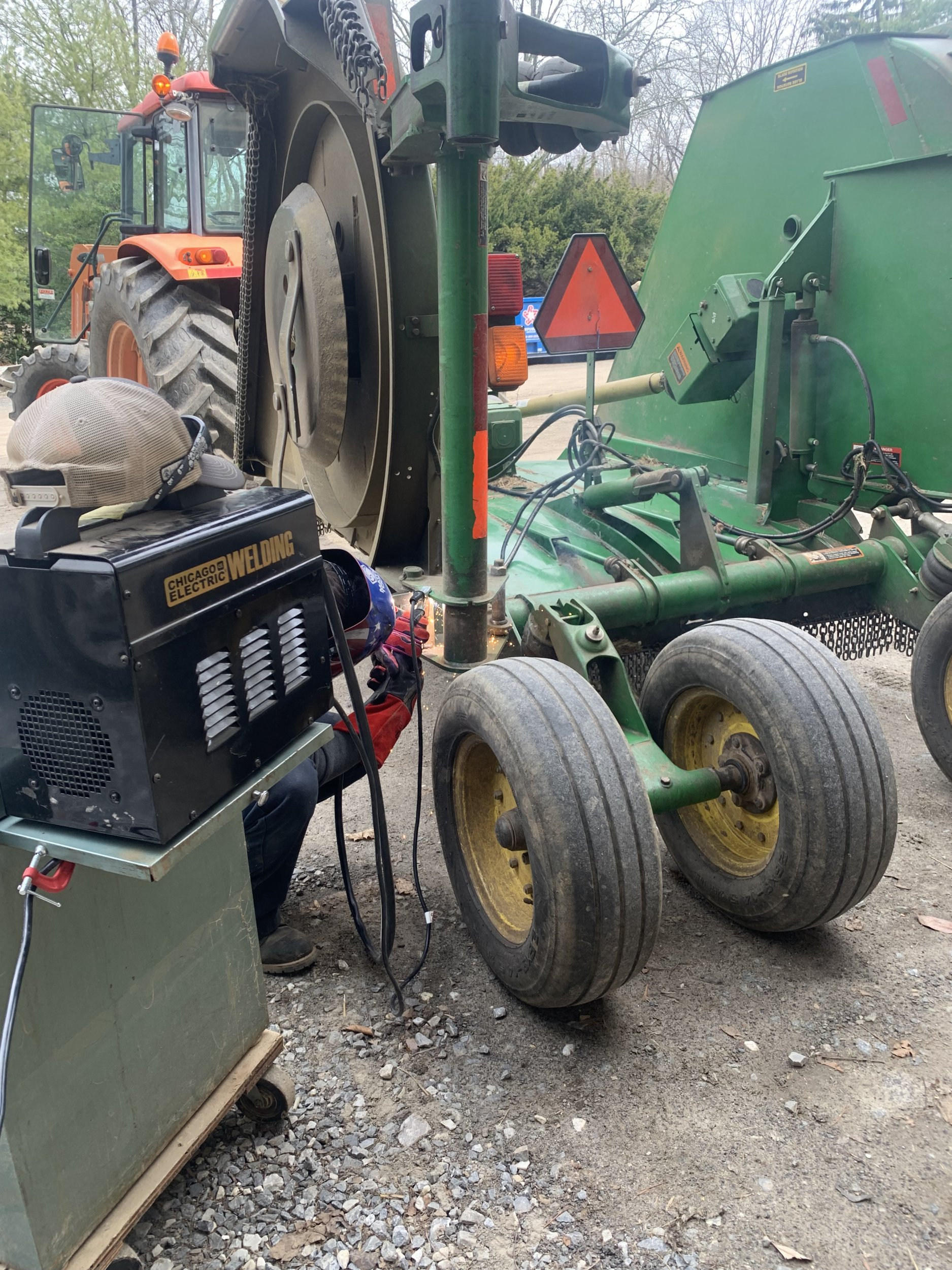

Well we had a little ”ooops” today. I caught my chain shielding bracket on a very immovable object and tore the metal bracket clean off the bush hog frame-mounts included.
Doing a quick weld. The shield was destroyed beyond repair. Pulled all the chains and ordered new chain shield.

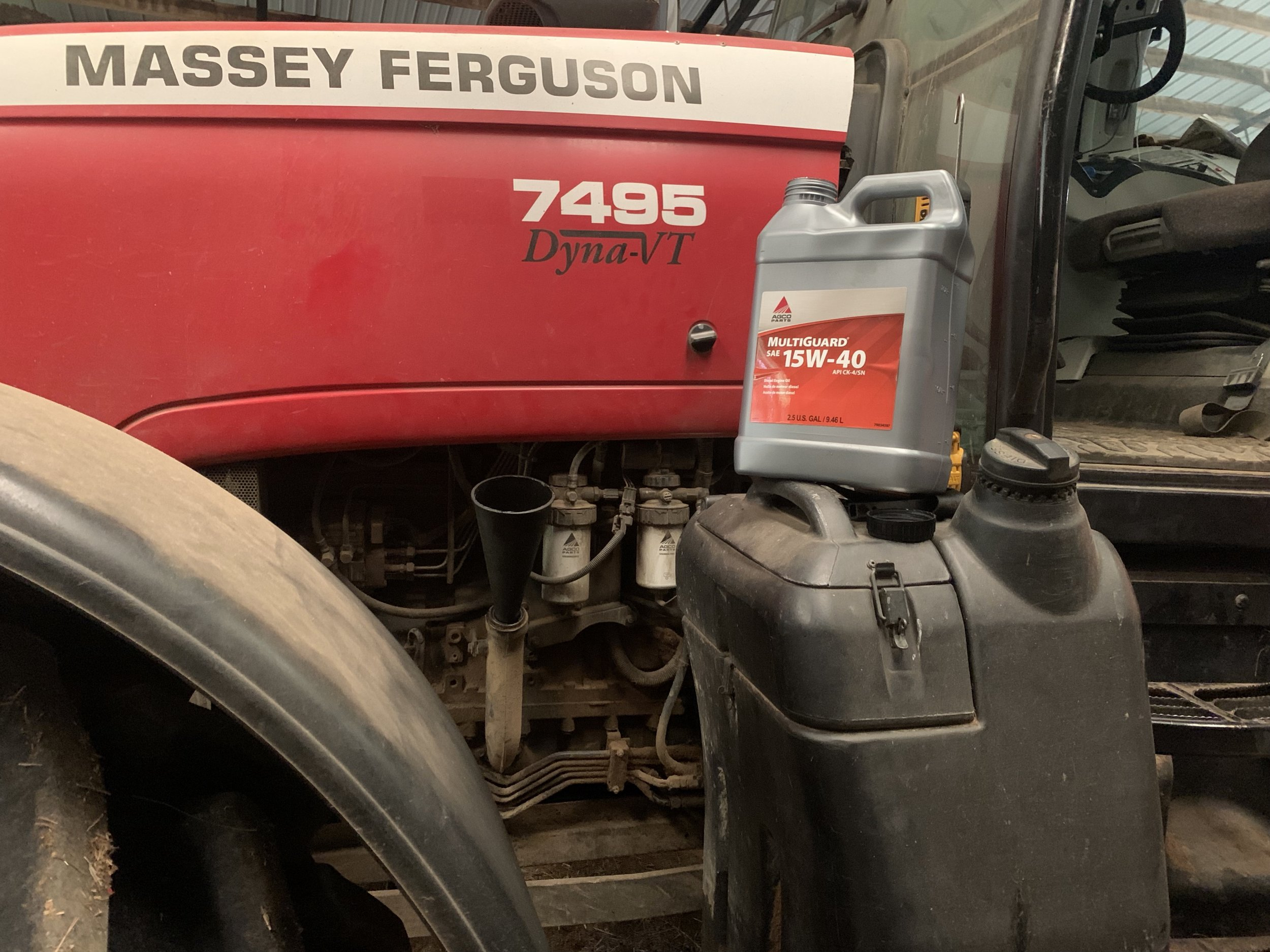

Anyone doing any rebuilds or major repairs?
Fertilizing? Field edge tree line clearing?

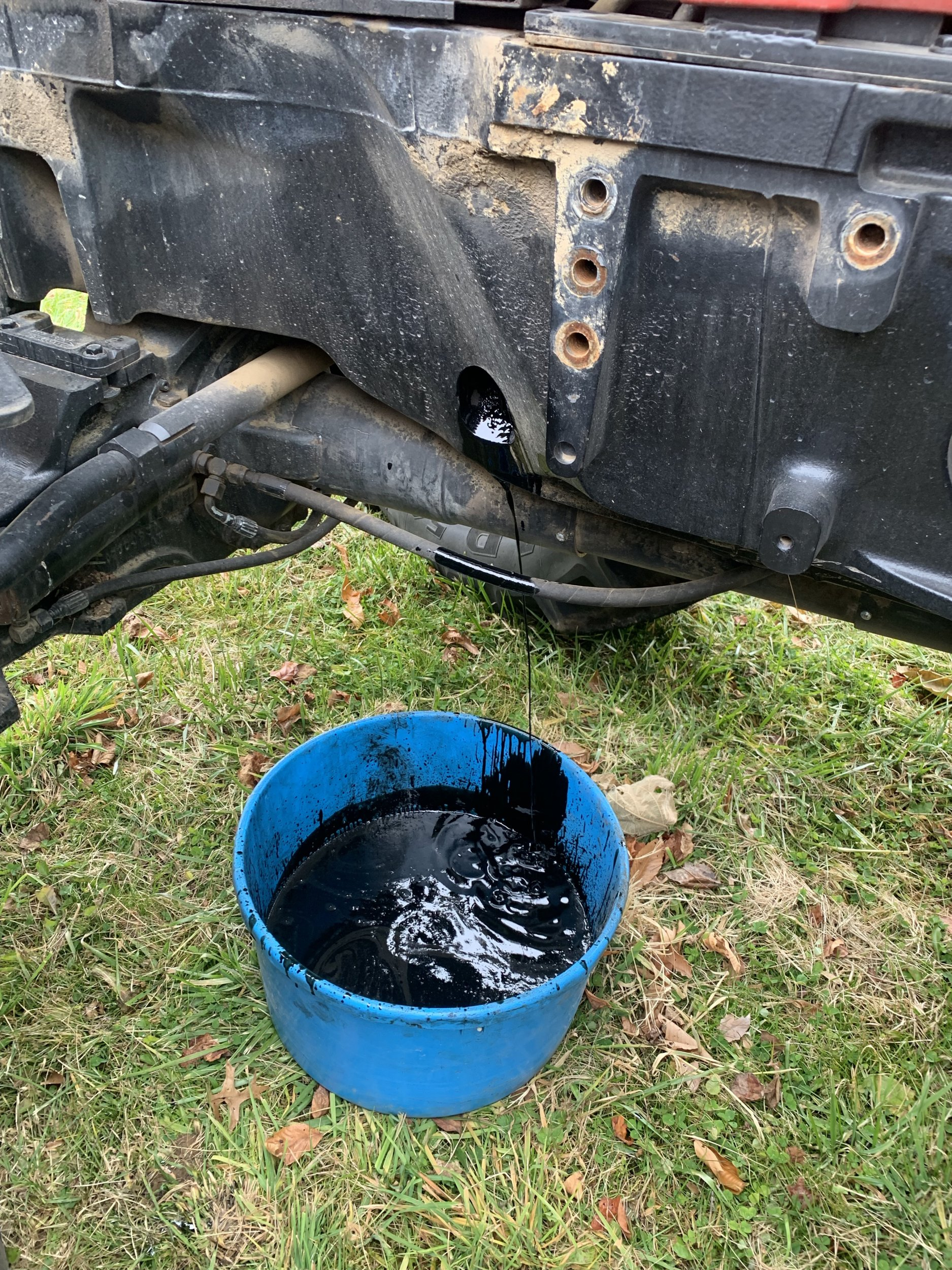

Im well underway on oil changes.

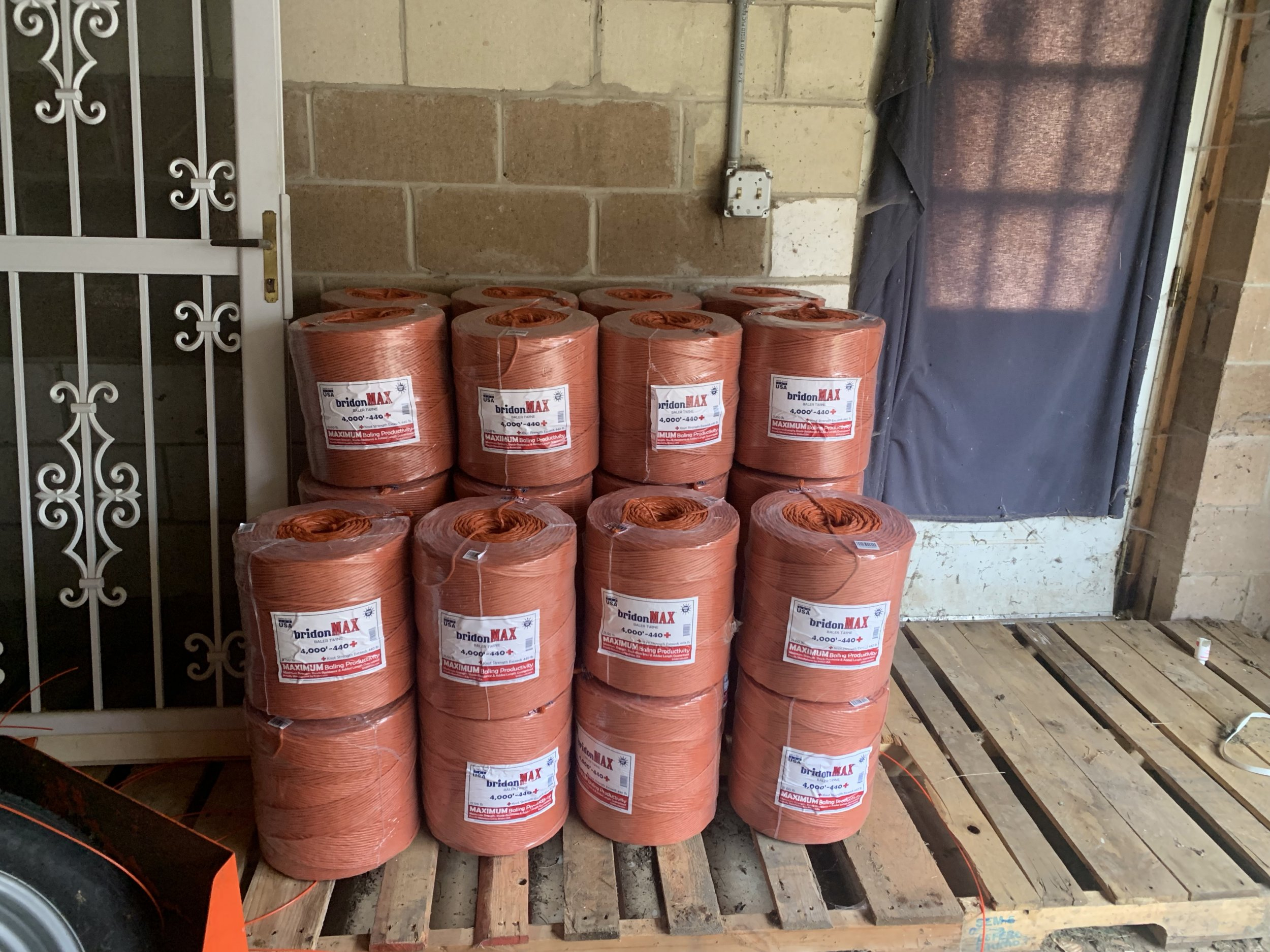

Stocked up on twine. Got this at the end of season pricing, before it goes to like $50/roll.

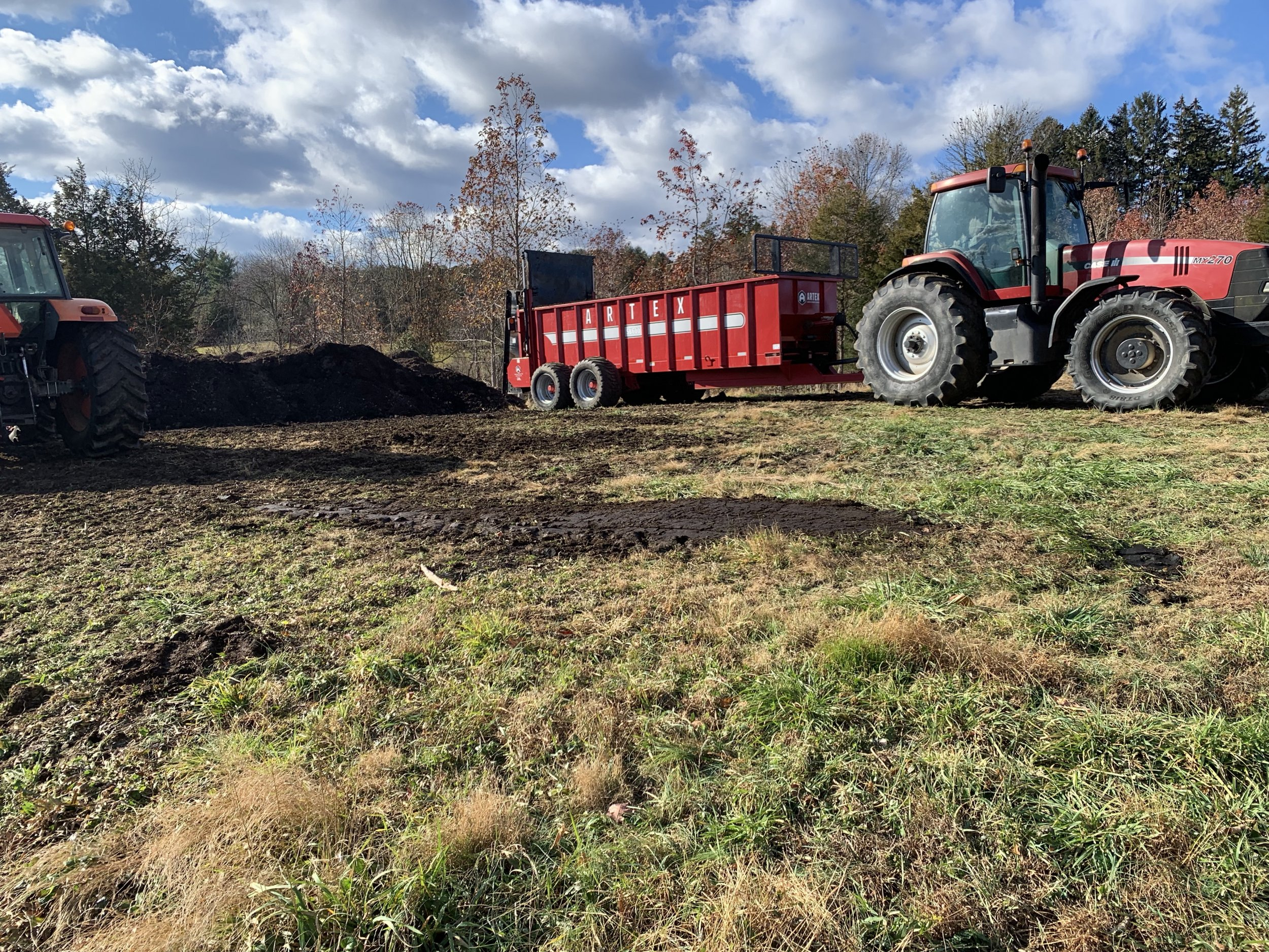

And of course, fertilizing

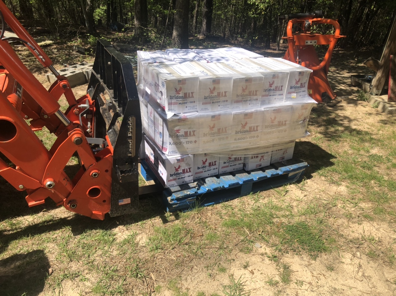

Good to see you have baler twine. I've talk to the major twine producers & they will not have enough to satisfy the market demand. Please buy early what you need. Baler belts sometime in MAY there will be Baler belt shortages even into September/October. Please buy early.

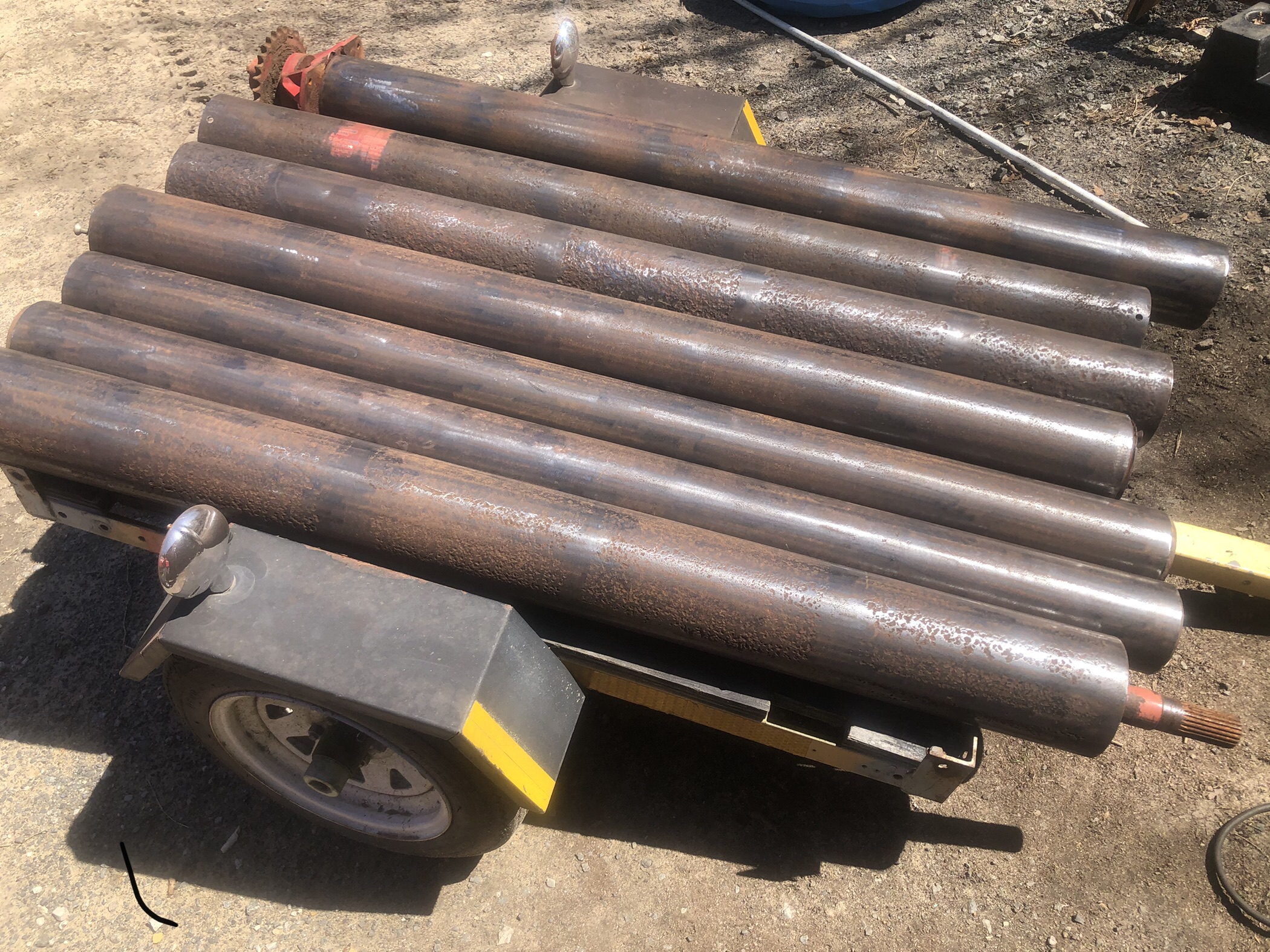

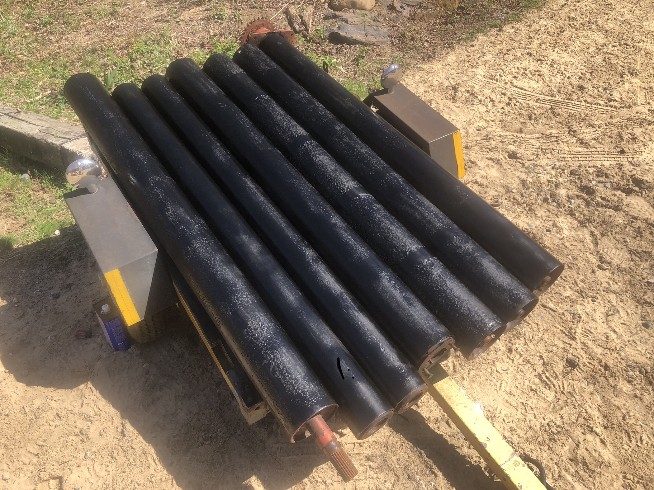

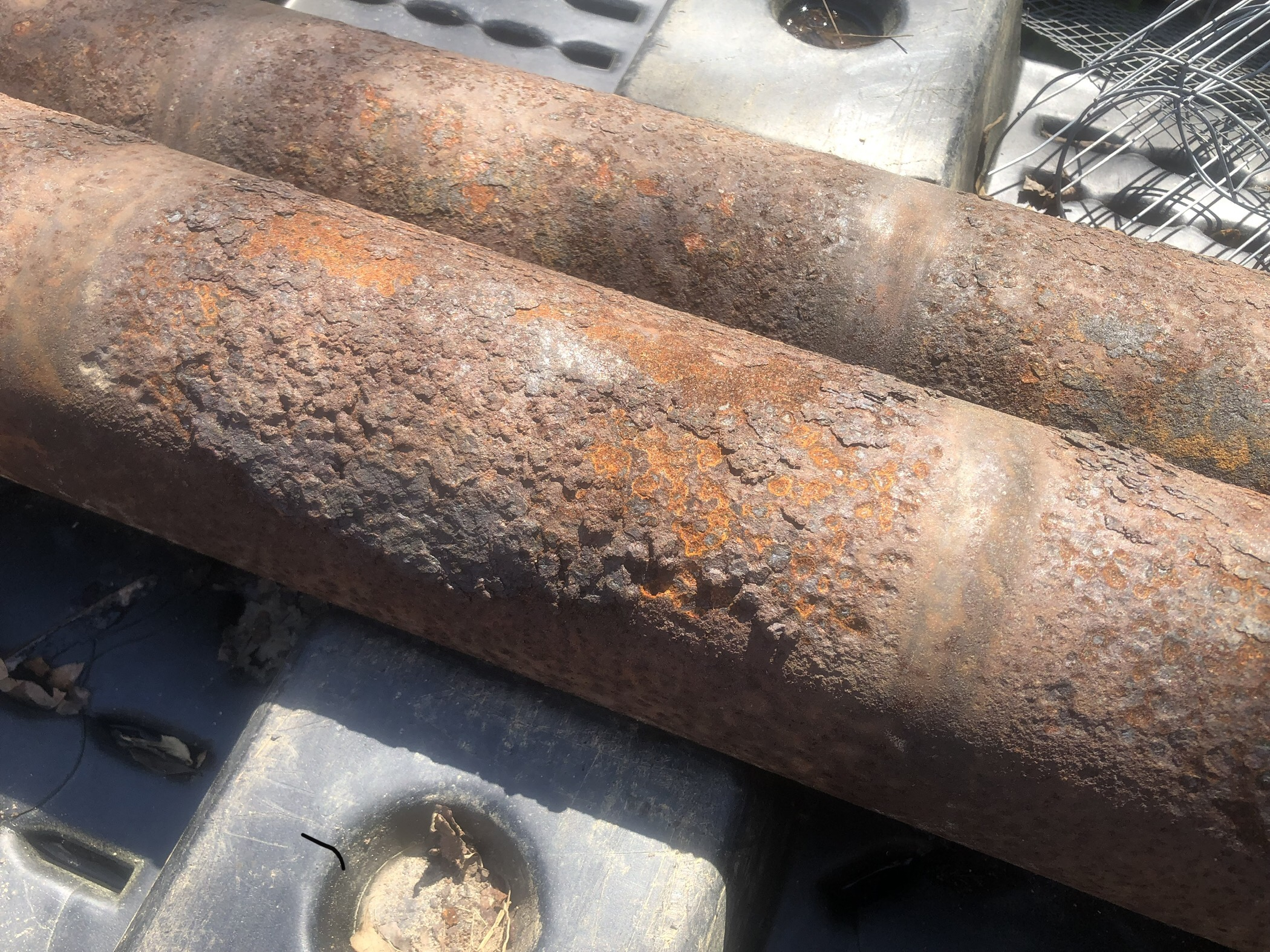

Well, all the rollers are hung minus one which is waiting on bearings that should be here Tuesday. Gotta tear down the pickup and probably put a new bearing or two in there. After that belts, gearbox flush, two hydraulic hoses and I should be done. Think the majority of the work/time is done it’s mostly just money now.
Also received a nice delivery of American made twine I’m pretty excited to try this year.

I’m using the same Bridon twine

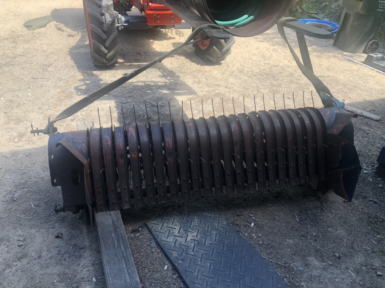

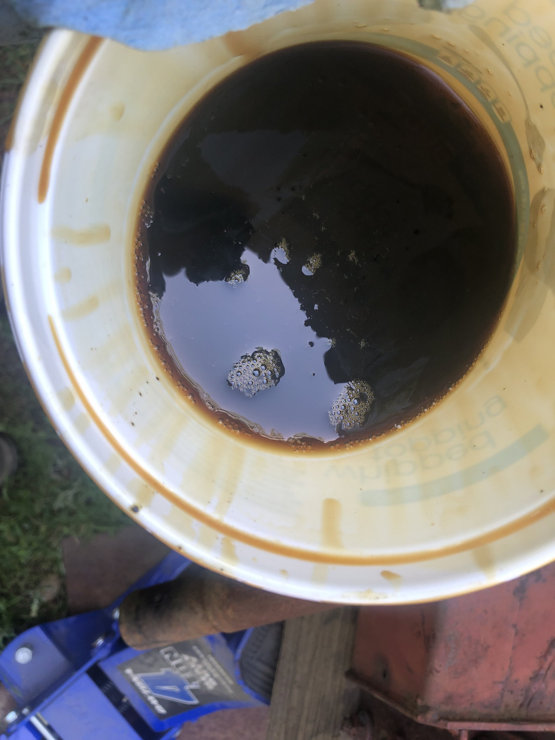

Last two roller bearings got in, hung all the scrapers, cleaned the remaining adjusters so officially all the guts are back in the baler.

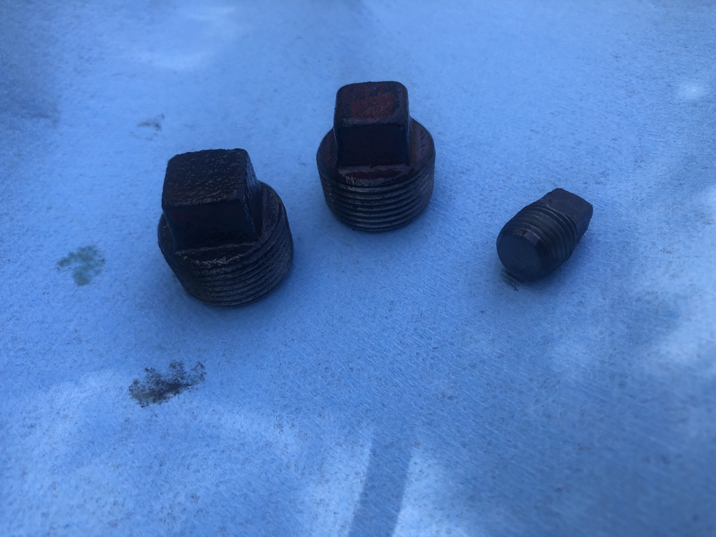

Hit the gearbox finally, was pleasantly surprised at how clean the oil was I didn’t see any water which shocked me as I expected quite a bit of condensation buildup over however many years it’s been. Plugs also looked fine with the top one having very light surface rust but cleaned up well. There was some rust debris in the oil so probably change it again after first cut. Gears appeared to be new, could see the machining on them but couldn’t see any indication that the box had been apart by the bolts holding it together so either a fairly new box or someone is really good with a wrench. Looking at the wear on other parts of the baler I’m betting a newish box.
Next phase…
When I got to this many bent and broken parts I decided it was time to call it a day and get an adult beverage.
Next episode will be seeing how many bearings are bad on this sucker and pull the rest of the broken times.
