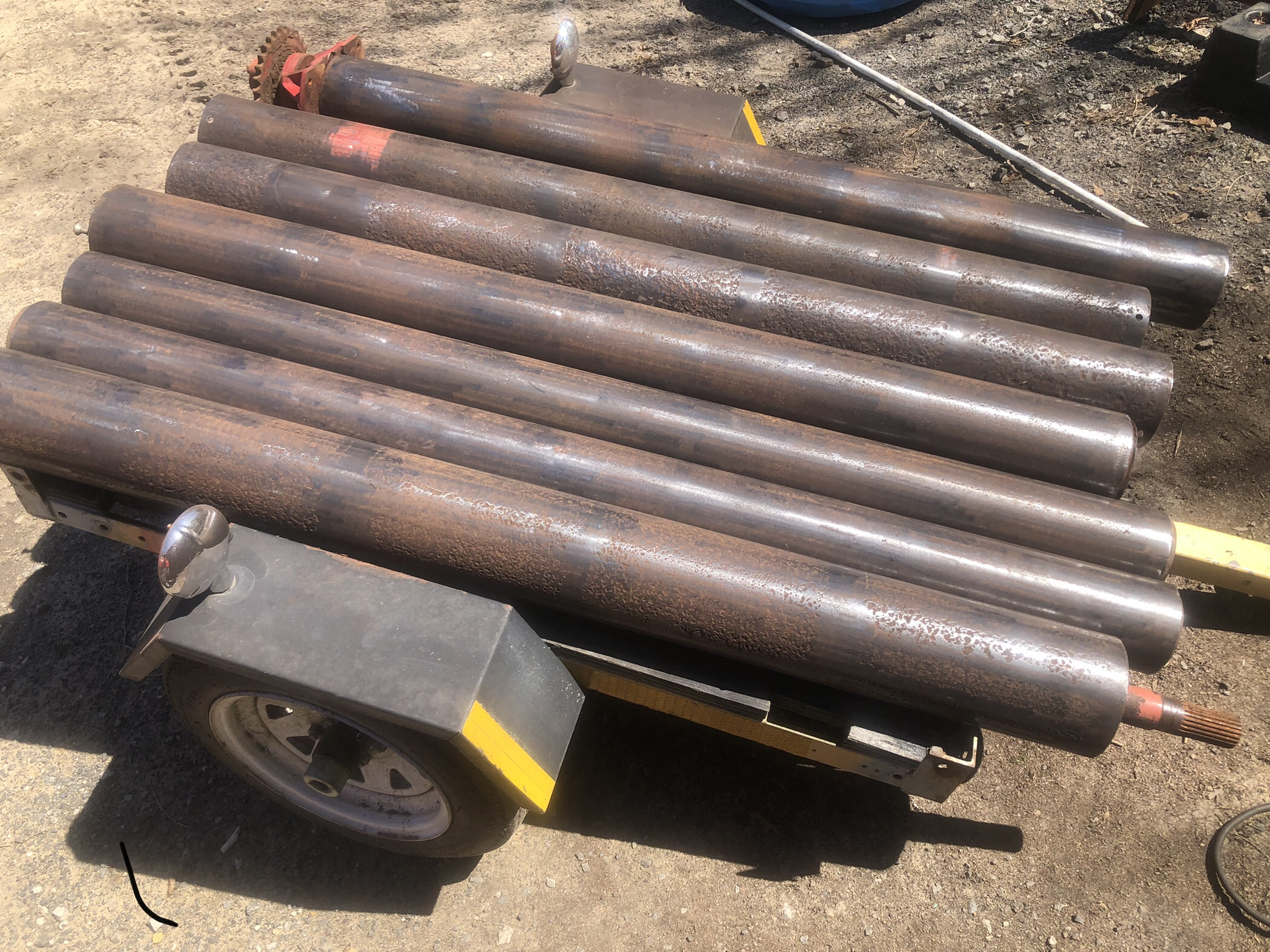

Not much progress but ready to start hanging parts back on it instead of continually taking stuff off.

Well, all the rollers are hung minus one which is waiting on bearings that should be here Tuesday. Gotta tear down the pickup and probably put a new bearing or two in there. After that belts, gearbox flush, two hydraulic hoses and I should be done. Think the majority of the work/time is done it’s mostly just money now.

Last two roller bearings got in, hung all the scrapers, cleaned the remaining adjusters so officially all the guts are back in the baler.
Hit the gearbox finally, was pleasantly surprised at how clean the oil was I didn’t see any water which shocked me as I expected quite a bit of condensation buildup over however many years it’s been. Plugs also looked fine with the top one having very light surface rust but cleaned up well. There was some rust debris in the oil so probably change it again after first cut. Gears appeared to be new, could see the machining on them but couldn’t see any indication that the box had been apart by the bolts holding it together so either a fairly new box or someone is really good with a wrench. Looking at the wear on other parts of the baler I’m betting a newish box.
Next phase…
When I got to this many bent and broken parts I decided it was time to call it a day and get an adult beverage.
Next episode will be seeing how many bearings are bad on this sucker and pull the rest of the broken times.
Anyone use the poly pickup bands? I seem to recall that you’re supposed to replace all of them if you convert to them? Is that true/necessary?
