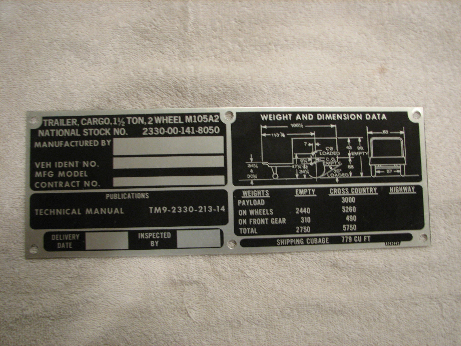

M105a2 data plate:

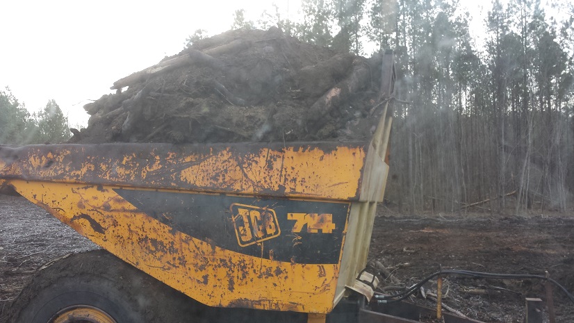

Bigger than what you are looking for, but dang it worked great!

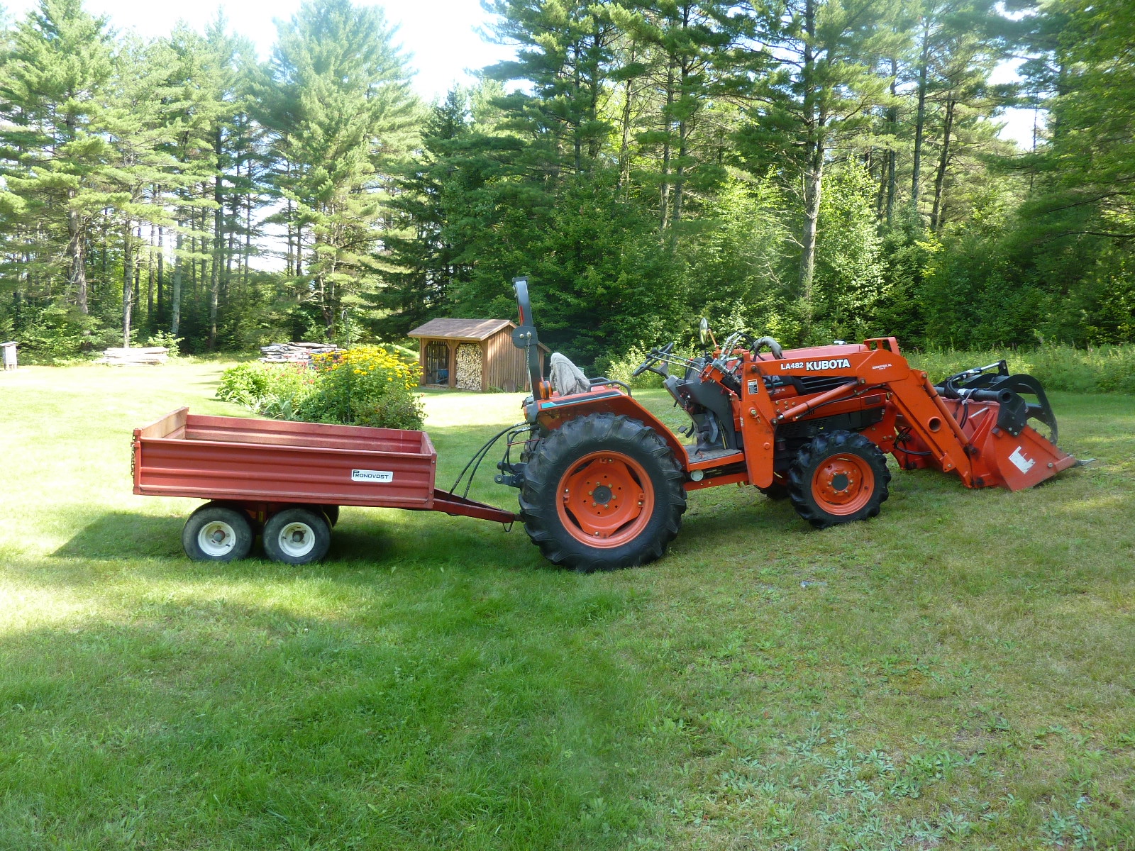

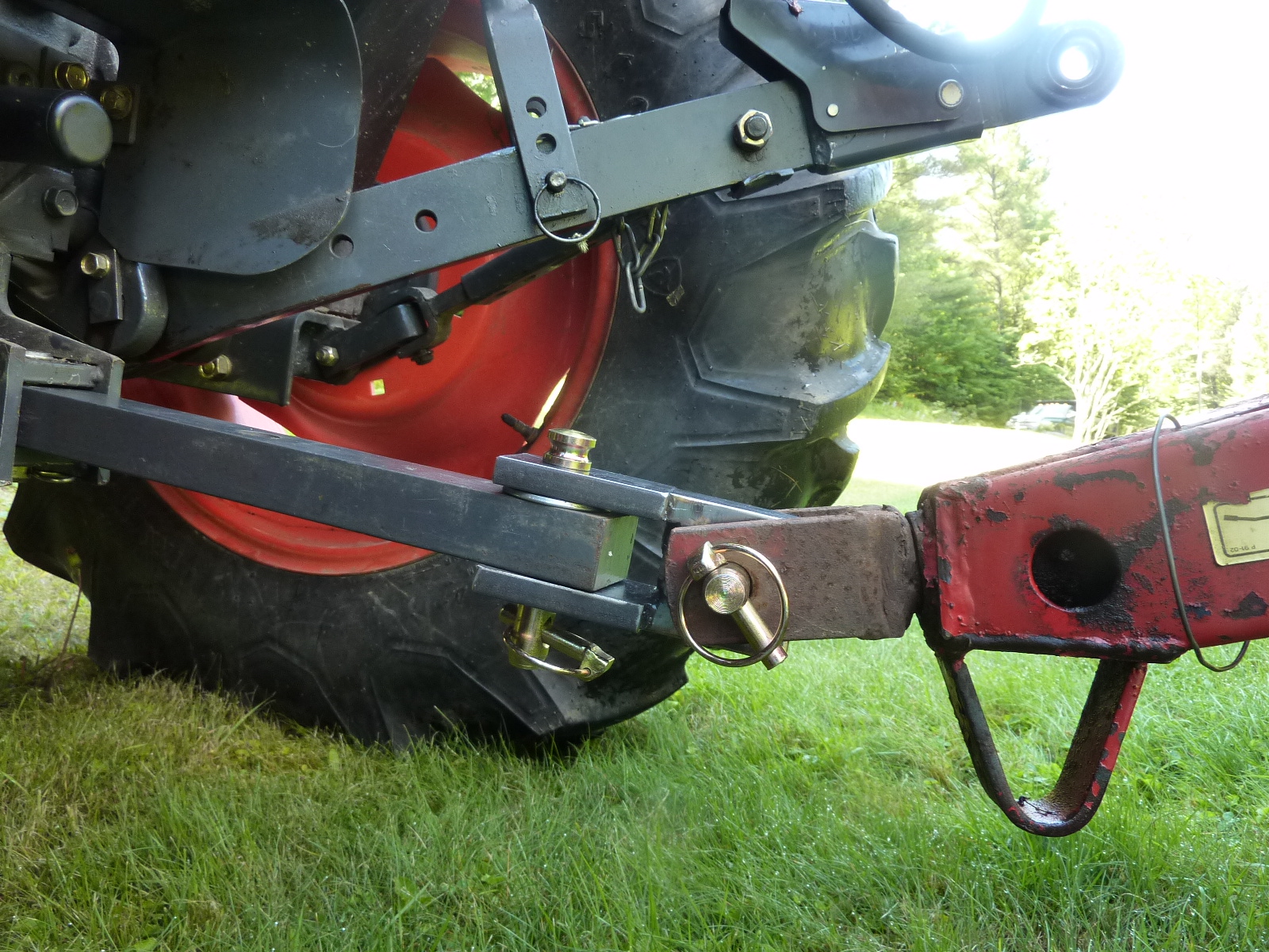

The day after I pulled my new to me dump trailer around the woods and told everyone how great everything was I unhooked the trailer and found some healthy divots in the hitch pin - a sure sign of some serious binding on the pin. The trailer had a clevis hitch that pinned to the draw bar and the clevis could also rotate. This is what it looked like.

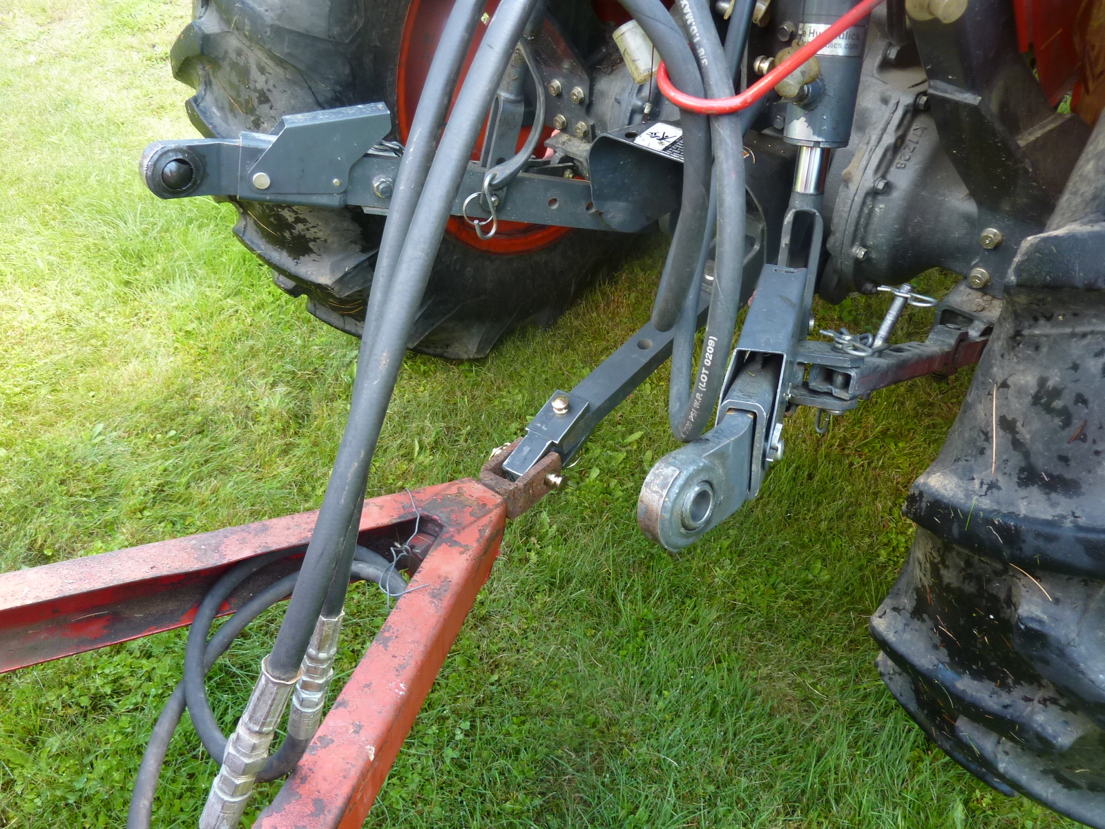

I had never pulled anything but logs on a draw bar before and never even gave the suitability of that hitch a second thought. But after seeing the cut marks in the pin I realized that the hitch could accommodate turns and a rolling motion but any vertical flexing was restrained. If I went through a dip or started up a hill like this something would have to bend or brake.
It needed to pivot in the vertical direction for hills and dips. That original simple clevis hitch is only good for fairly flat ground. I could have converted over to a ball hitch but made a double clevis instead with some scrap 1/2" pieces I had. Here is a close up of the hitch in the picture above. You can see how much flexing is needed on just that little incline. No wonder the pin was marked up - I am lucky something didn't brake.
I have been using the trailer to bring in wood to the shed. It works great. Going to make the sides a little higher though.

Nice solution. Less clanking than the pintle hitch I would've done.

Nice fix Gordon!
