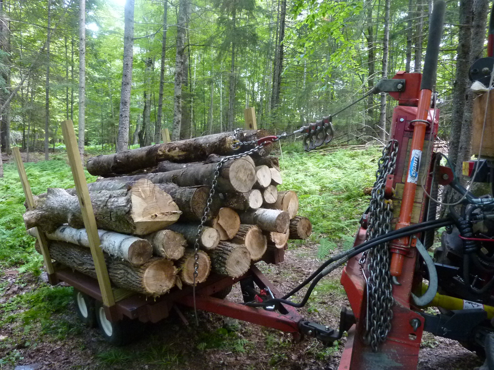

Gordon - I'll probably be looking at making something like the two-way clevis hitch you described in post #68 in this thread.
I'm curious how that has been working out for you. Has it caused any issues when you try to back up the trailer, or during braking while a heavy load is pushing you down a hill? I'm just wondering if the hitch "flips sideways" during these operations, and of so, whether that causes any issues for you.

On that hitch - it can't twist or buckle when backing or breaking with the set-up I have. The pins are 90* to each other like a U-joint and there is a loose but close fit between the two clevis type joints so they are held inline by that and the pin. It acts like a normal pinned draw bar hook-up backing and braking.
That's helpful. In looking at it now and thinking about it more, I can see that. My tractor drawbar has a fairly large hole in it, so I may have some slop around that pin, but I'm guessing that's not a big issue?
The receiver hitch on your winch looks similar to my set-up. Did you have to do anything different to use it with that? Any need to shim up with washers to fill the gap (I assume the insert's tab is thinner than your tractor drawbar), or do you just pin it in and go?

The receiver hitch had a 1" hole for ball bolt and was 3/4" thick. I welded on a 1/2" thick pad and with a 1" hole saw using the original hole as a guide made a 1-1/4 draw bar like end with a 1" hole. I bought a Cat 2 to Cat 1 (1" to 3/4") sleeve at TSC and cut it to length for a hole size reducer and used a standard Cat 1 3/4" pin like I use on the draw bar w/o the winch.
I kept the clevis fits close to keep from gouging up the pins. Shimmed with a 3/4 washer.

Does the joint rotate on the front of the trailer? It looks fixed. Doesn’t it bind up from the twisting when driving diagonally across a gully?

No it rotates freely. Even has a grease zerk. It is a common type hitch on off road trailers. If you run on flat ground you just need to pin it to the draw bar like this
