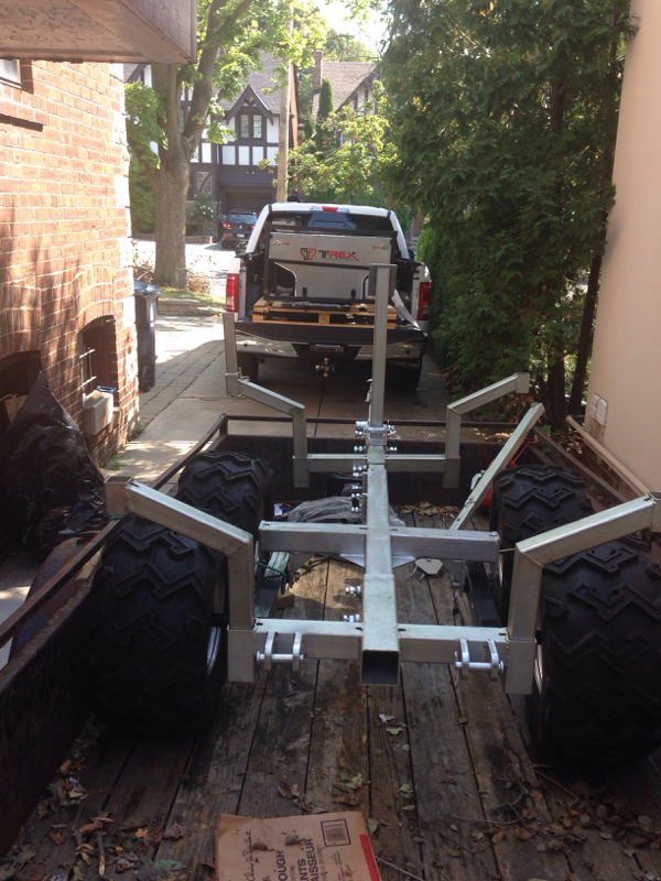

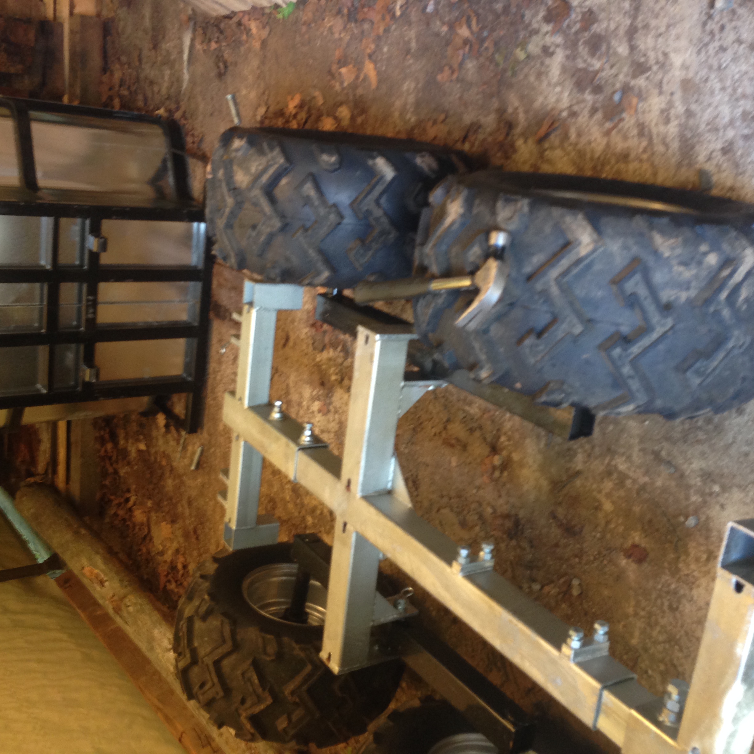

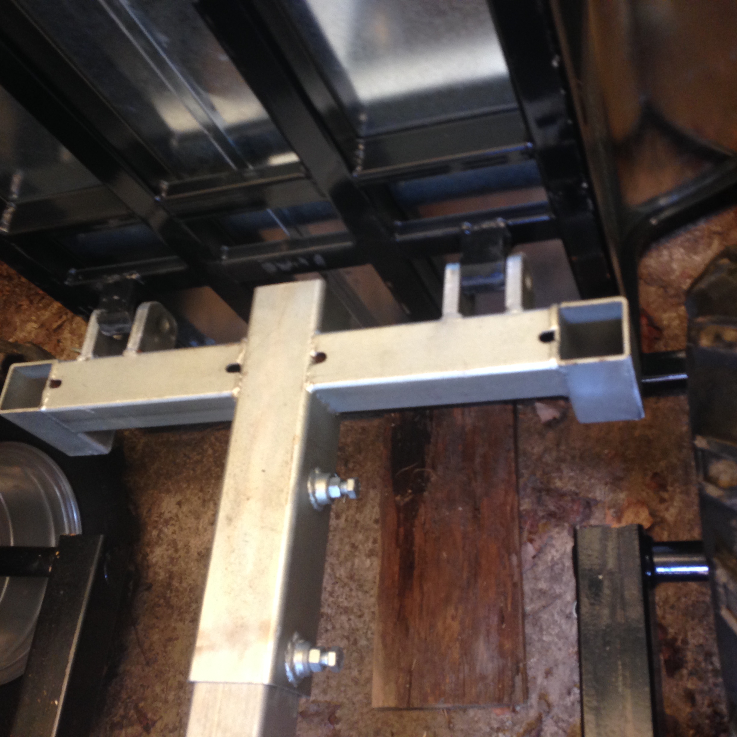

I had the dump box sitting to far back, and wasn't getting enough tonque weight, so I moved it forward. Piece of cake! You just raise the box all the way to vertical so that it sits on the ground, and then disconnect the two pivot pins and pull the trailer forward a bit. As you can see, the part that has the pivot pins on the undercarriage has two set bolts on the side, so you just loosen them and slide that part forward a bit, and then retighten. Then, using a similar procedure with their own set bolts, you slide the front crank tower and/or tongue jack forward as necessary by the same amount. (Or better still, just slide the whole inner square tube forward, which lengthens the trailer again.) Then, reconnect the box and lower it down again. Very versatile system, and you can make the trailer longer or shorter as you wish. So far, so good!
Haven't tried replacing the dump box with the logging-style side arms and tried that function out yet, but will keep you all posted. (See the first attached photo, showing the lower parts of the side arms, which I had on temporarily during assembly.) As I mentioned previously, it is unfortunate that you cannot leave these side arms attached when you install the dump box.

View attachment 479031View attachment 479028View attachment 479029View attachment 479030
T-Rex adjusts!
James

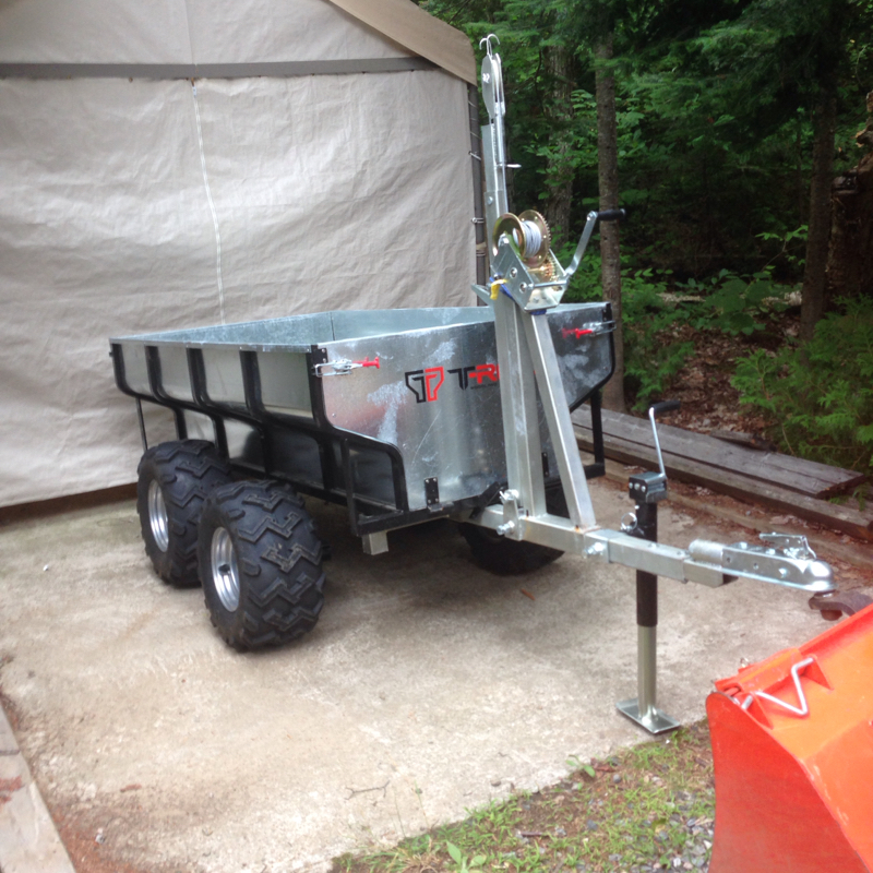

Another little update on the T-Rex: See those pins that go on the dump box pivot? One fell off somewhere, and I noticed that the other one is too small, really. (Too much play.) Will have to get some with a larger diameter, and larger clips for the ends so they don't fall off so easily.
Used it for sand on the weekend. No problem carrying it! And it seems to track along nicely behind the ATV.IMG_7260.JPG

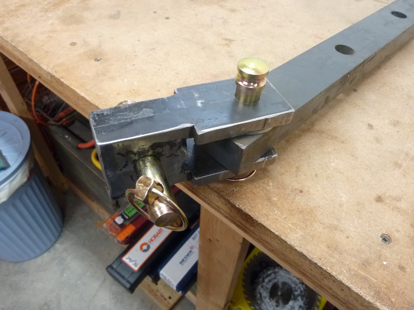

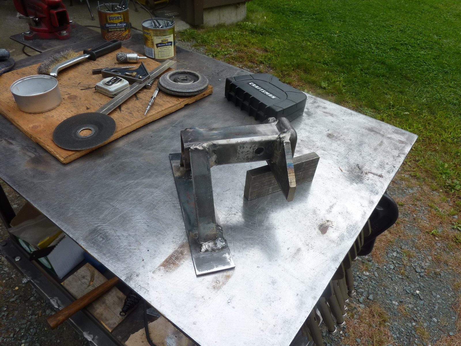

Added the trailer hitch option so I can bring the wood splitter along
gg
/ Off road dump trailer options
#132
Looks good Gordon! I'm planning to do the exact same thing to tote along my new Splitter. I might need to steel your idea.

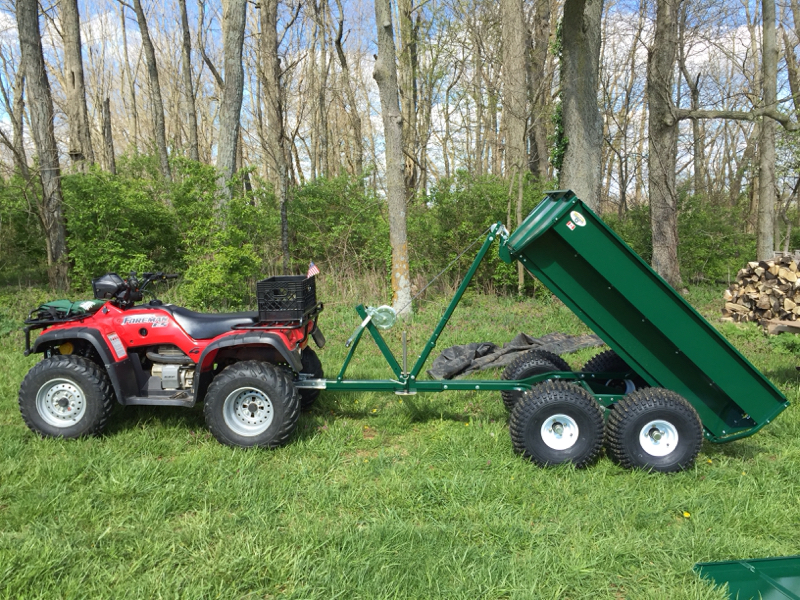

Hello, Good thread.
I have a MUTS trailer from Canada. Excellent trailer.

Hey ProjectKing.......you don't happen to know the height of the tongue when the MUTS is level, do you? I'm looking to get a draw bar for my UTV and I'm trying to figure out what I'll need for drop/rise. BTW.....I've watched your YouTube videos...very helpful, thanks. Anything new to add regarding your experience with this trailer? I'm hoping to get one soon.
/ Off road dump trailer options #138
Hello, I will measure it later today and post it. The trailer is excellent. It's perfect match of strength and lightweight. I really like it. I have a new L3301 that I have been using to load it with dirt. Trailer does great with a full load of dirt and floats over soft ground with the big tires.
You can see in the pics the trailer is a good size. It will hold a lot of dirt. Yet it is small enough to fit down ATV trails, etc. The front bucket on the L3301 is 60" wide for reference.

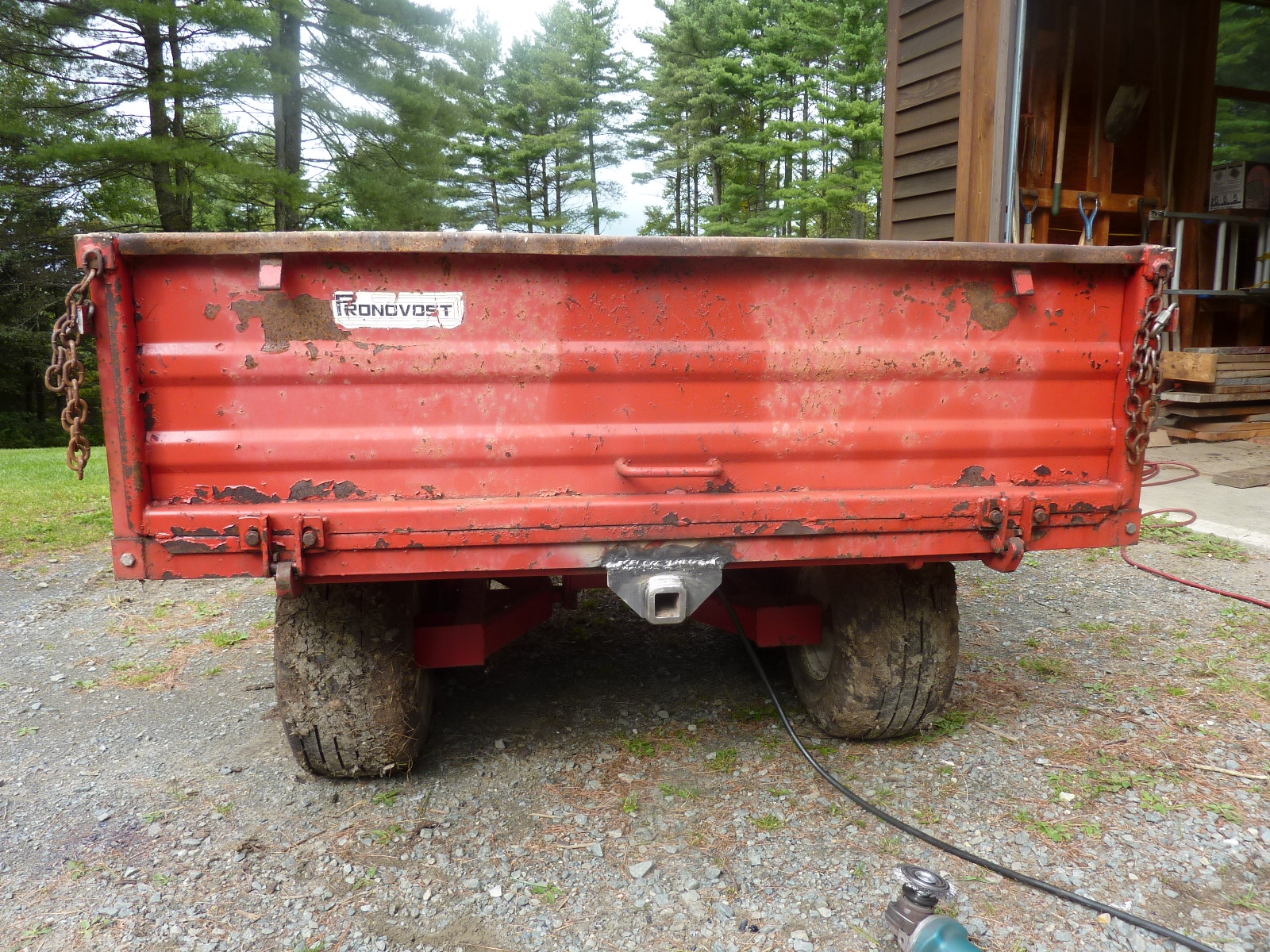

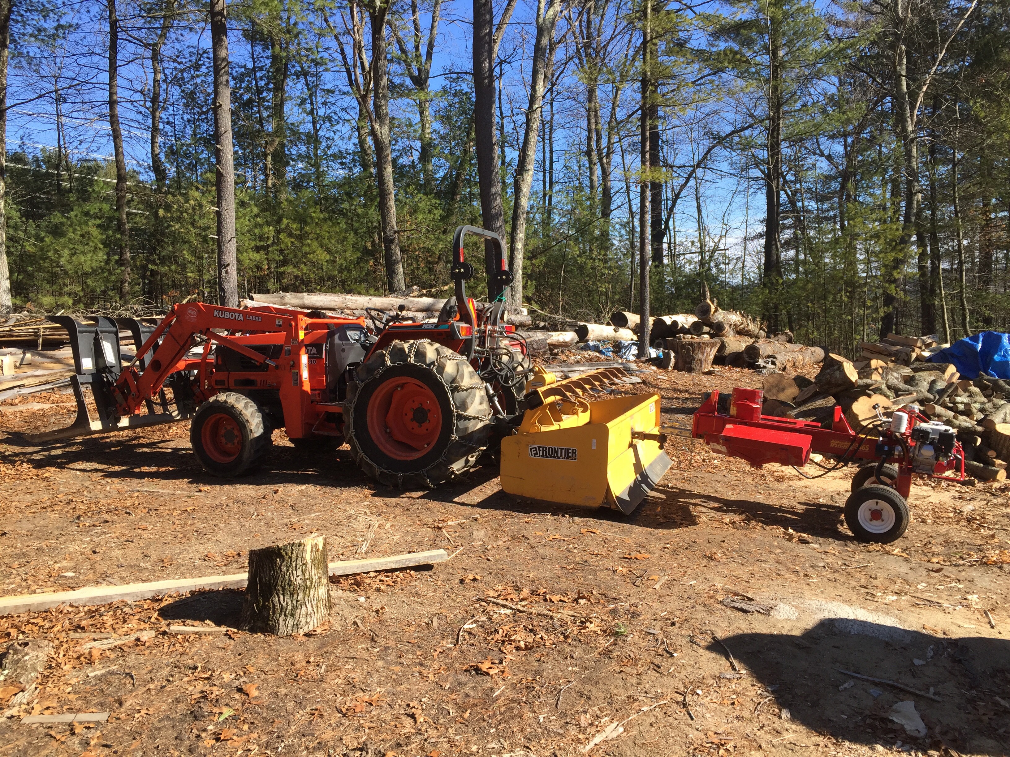

I took Gordon's idea and welded up a trailer hitch on my box blade, mostly to tow a wood splitter, but I'm wondering about the dump trailer?
Do you think that there is cause for concern regarding tongue weight of a loaded dump trailer with the trailer ball mounted so far back?
Since these photos, I've added an 8" drop hitch to get the ball lower.
