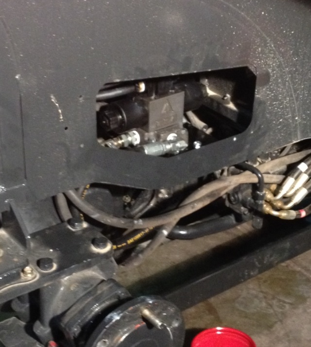

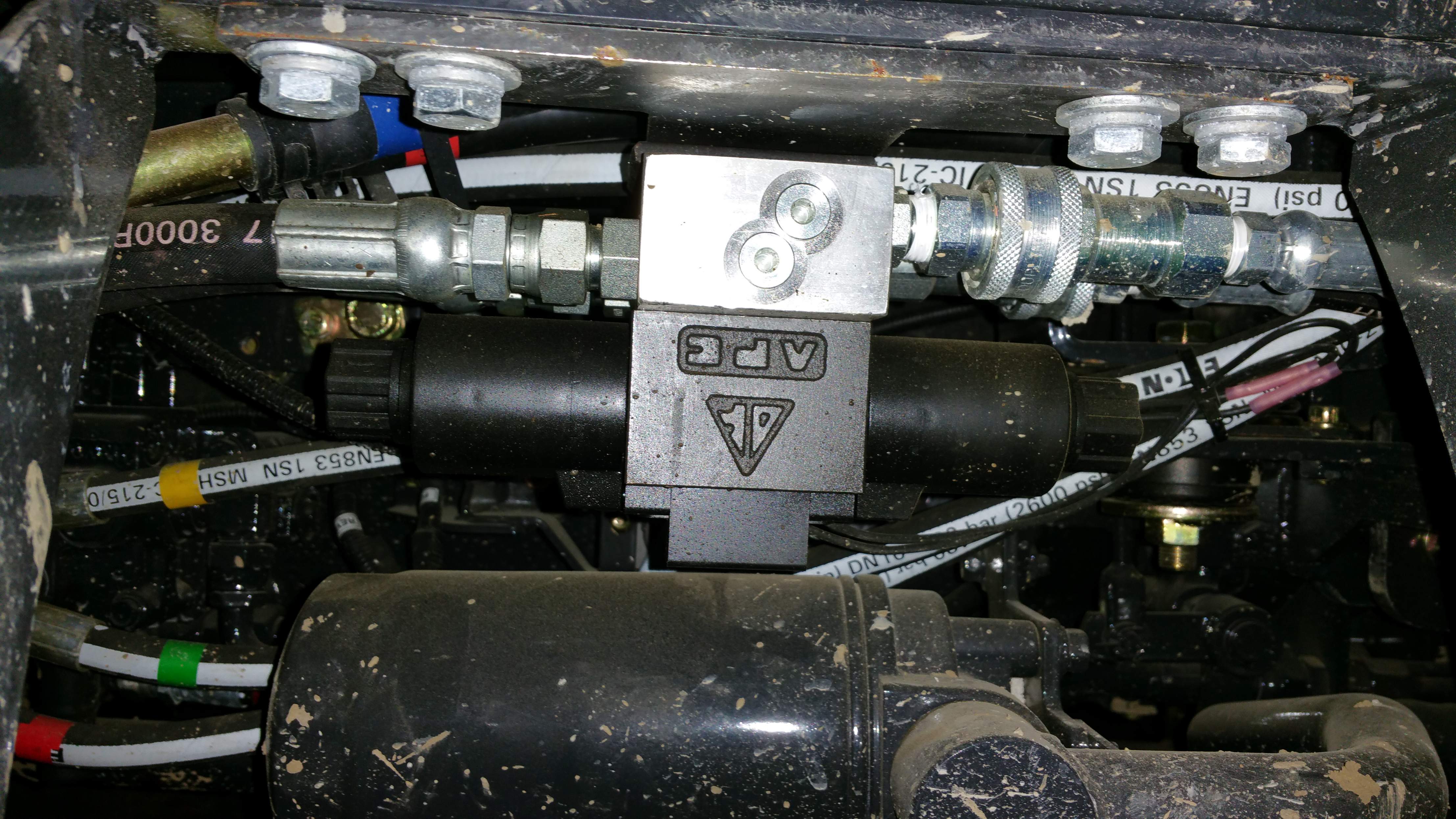

You have a sub plate that looks like it is a D03 size. Their mounting plate is pretty clever for getting it in there. Your entire system is sitting where I mounted a hydraulic "wiring loom" to guard the hydraulic lines and prevent them from getting into the HST pedal linkage.
My 3rd function requires three custom made plates, and four custom-length hoses just to plumb to the quick disconnects (not to mention the electrical harness that uses weatherpac electrical connectors) and is an order of magnitude higher in cost as a result.
Well, it is bolted down for sure. I guess what I am asking if the explanation and fix seem to make sense??
/ NX6010 hydro transmission issues #22
Makes sense IF the valve is restricting flow and the oil is getting hot causing the hesitation.

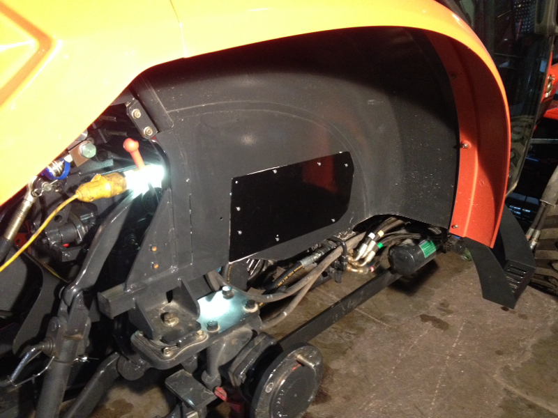

OK, from the 3rd function valve; the front hoses go directly to the 3rd function itself at the end of the loader.
The left/rear lines go into this box by the transmission. One line is in the pic as the lower left line, which is black. The other line goes into the back of that box.
