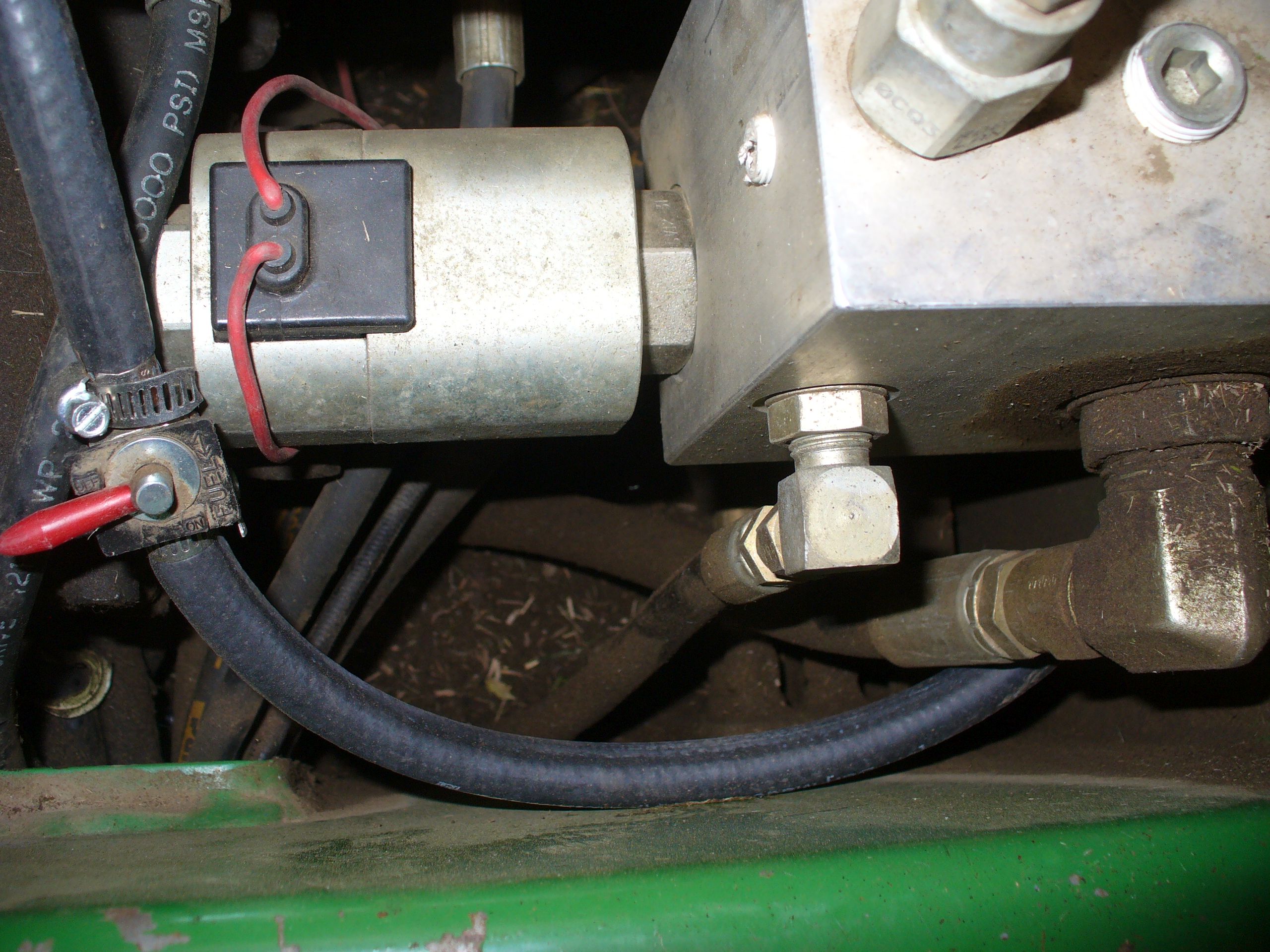

Sounds like you modded and got your tractor all up and running. Gives me encouragement so when i have to dig back into things for repair or modding. I've got to reroute my shut off valve too. Could you post a picture?

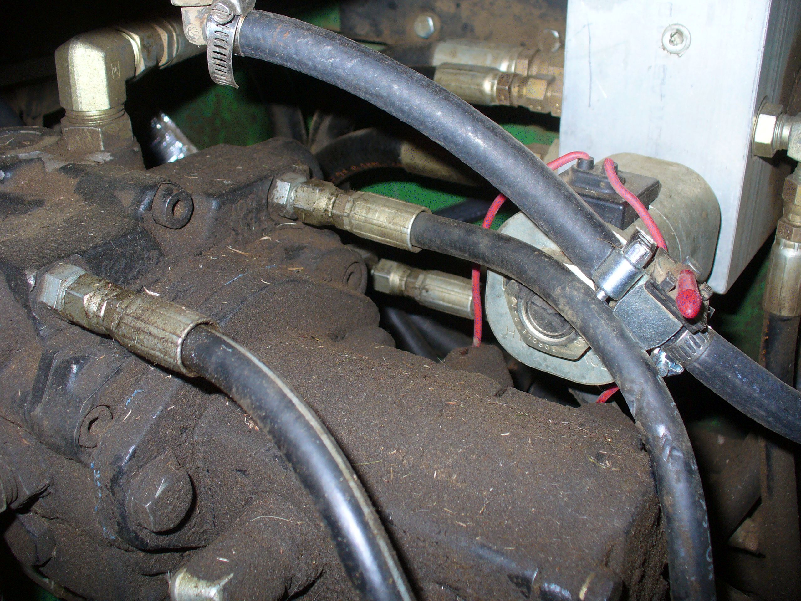

I'll try to get a pic later today but essentially I used a 3' hose and ran from the tank outlet towards the front of the tractor and looped it around the pump to run to the filter at the back of the tub. The shut off is now in front of the gas tank and easily accessible once the lid is lifted.
   / Now what's wronmg with my Robin engine?
#36
I took some pics so you may as well see them anyways. The first one is the gas tank connection and the second shows the route I took.

Yea Bob, I don't think this tractor ever ran this good! I expected easier starting in cold weather with the better coils but it seems to have a bit more power and certainly runs smoother. The coils are 13 yrs old so I'm not expecting much good from the tests.
