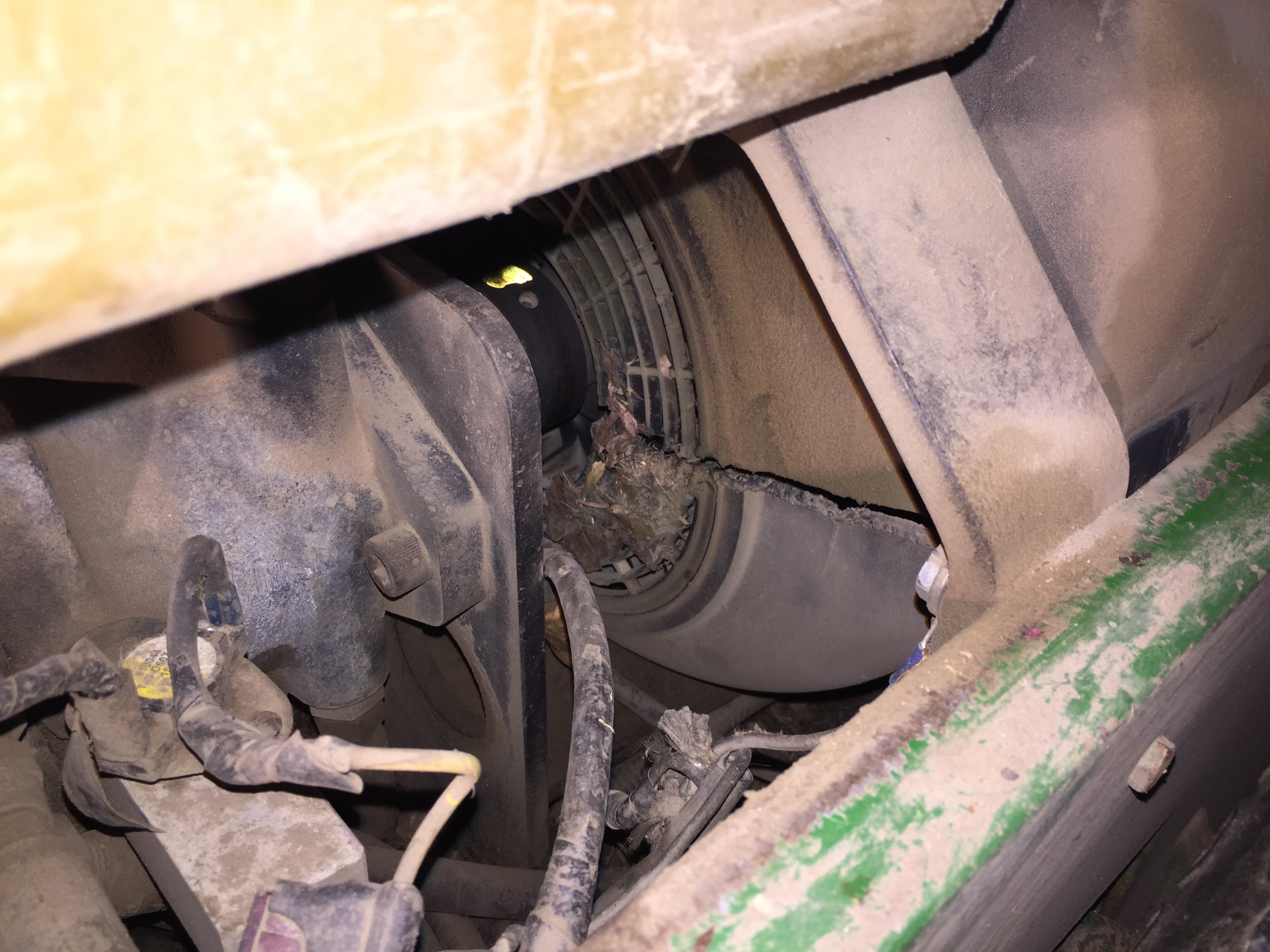

Looking at my Kohler setup with the variable volume pump ahead of the engine and the PTO pumps behind the engine, I have a stub shaft PTO on the blower cover side of the mower that powers the variable volume pump just like yours. I’d have to pull the gas tank, and move the VVP forward to get enough room to slide the blower housing out over the stub shaft far enough to get to my ignition coils as well. Bummer. If it ever comes to that, I’ll look at cutting the housing as well.

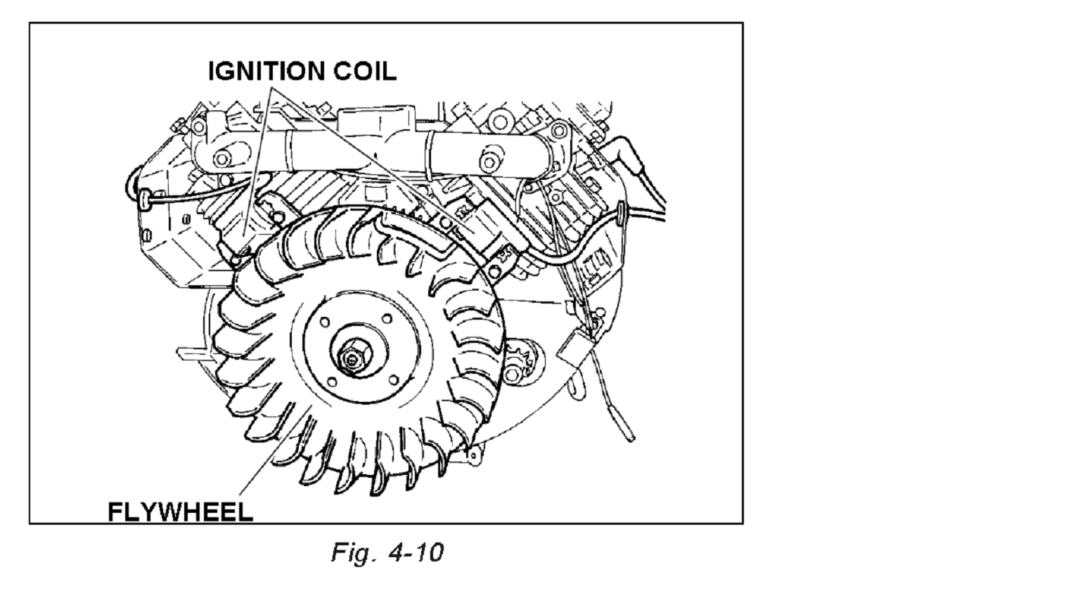

   / Now what's wronmg with my Robin engine? #27
I think there's a coil in the flywheel. And then there's your two ignition coils, one for each spark plug. Those two coils have to sit within +/- X distance of the coil on the flywheel. As the flywheel spins, it creates current in the ignition coils. Too big a gap, little-to-no spark. Too small a gap, your coils grind together like a lathe.
