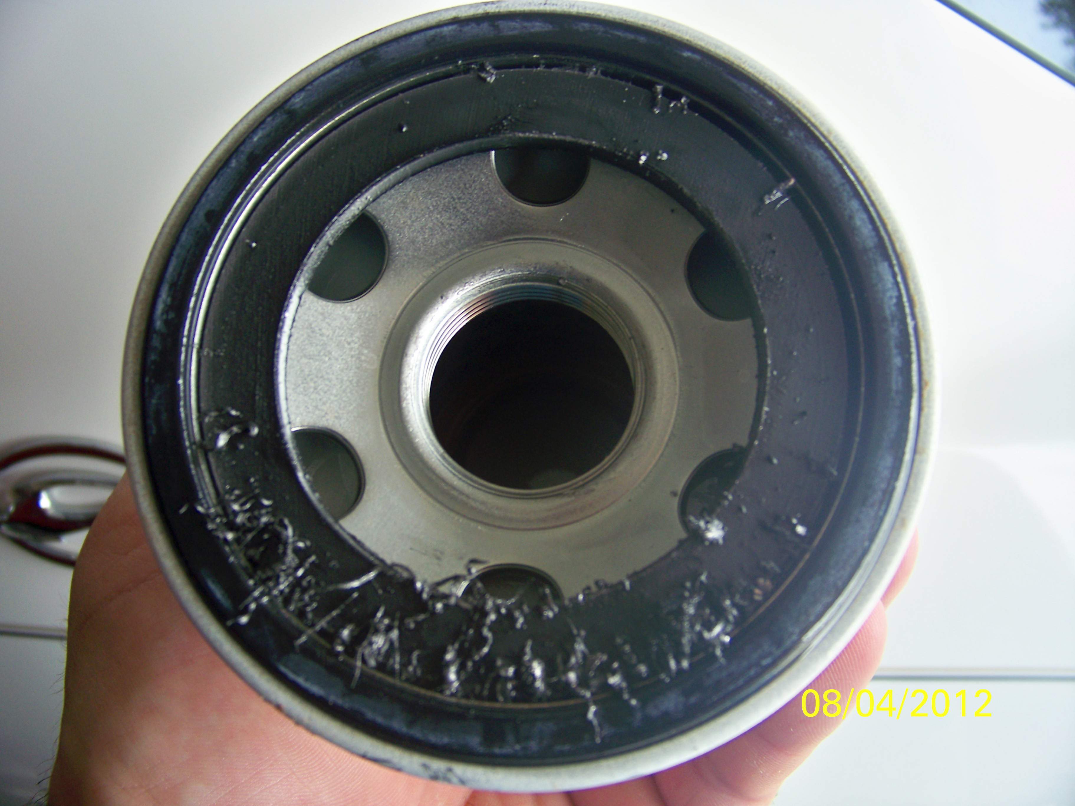

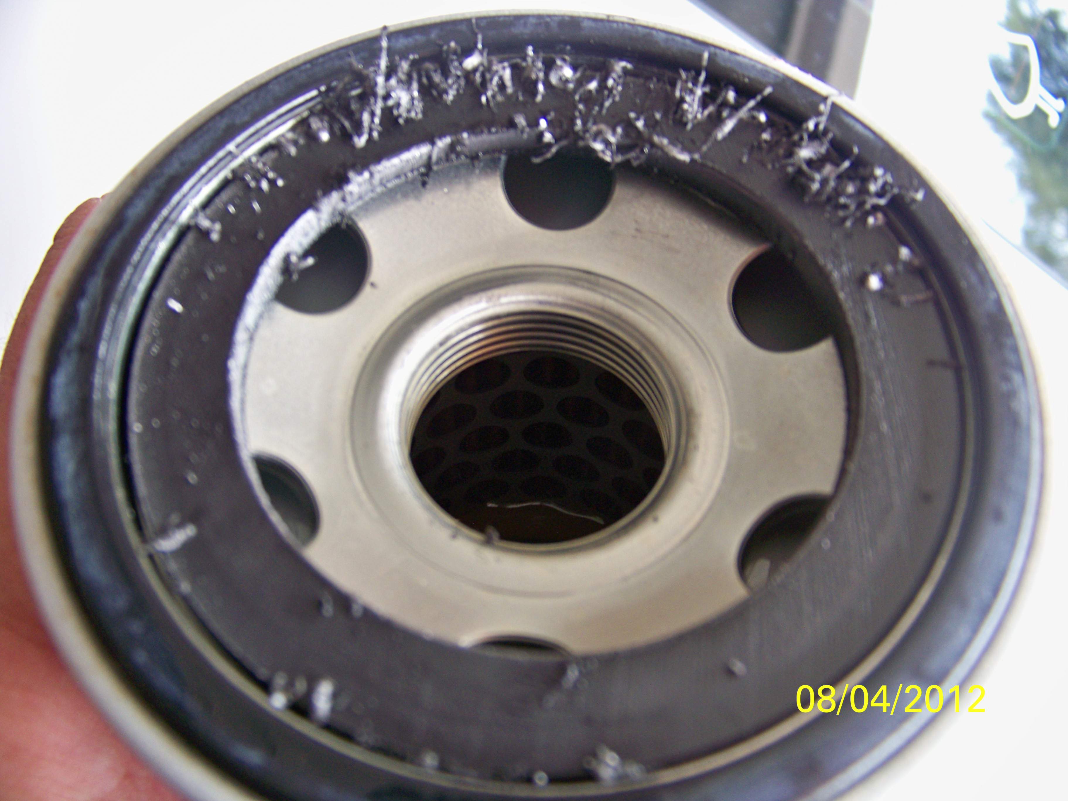

Just did the fluid and filter change at 53 hours. Still very alarming to me. Just emailed kubota and sent a few pics. Lets see what happens from here. Don't have alot to say at this point.
/ Not so sure this is normal? #83
Second time around now that's what I'd call abnormal...
/ Not so sure this is normal? #84
I'd say there's a lot more than there was in mine at the second change. Mine was pretty well cleaned out after the first filter change, my second filter looked a lot like bluegill's first filter. I didn't change the fluid until about 100 hours when I added a rear remote.
If nothing else, it seems you had more machining debris than usual left in the cases when it was assembled.
It would cross my mind to request they buy the tractor back from you at this point. It's not unreasonable.
If they suggest exchanging it for another one, well... is the second one going to be any better? That's the point I was making earlier. It seems the economy L's are plagued with both poor cleaning on the assembly line and poor 3-point hitch performance. That's two strikes early on in the game, I'd be quite seriously looking at a different model or even make if it was me. Mine's been a good machine so far, but it had/has the same issues to a lesser extent as far as the oil contamination goes. My 3-point doesn't work well either.
I guess the long-term question is, did this do any damage that'll crop up in a few year's time? After warranty is over? I still think the answer to that is probably no, but it's impossible to be sure. I've got over 300 hours now, no sign of issues.
Speaking of oil and such, have you checked the oil level in the front axle since you got the machine? They're notorious for being low.
Tough call to make if they give you some options, good luck with it.

UM.. yeah, not good, I would be concerned too. I would be looking for help from the dealer..
You know that saki can give you a case of bust-head (hangover) like you wouldn't believe.
I think the guy whose job was to clean out the casting after machining.. well lets just say he was not feeling
well that day. That there is what you call a "manufacturing defect"

Sean, after thinking about it a little this afternoon, asking them to buy the machine back from me isn't unreasonable at all, or to me anyways. Chances are, nothing will happen to the tractor BUT if it weren't for bad luck I wouldn't have any luck at all it seems. I am mostly worried about a year or two, even three years down the road. I bought this tractor for the long haul and now my mind feels different about it. After taking the filter off, the tube that is about an inch or so and runs from the filter towards the back of the machine, I checked it. I took a flexable magnet and pulled out alot more metal chips. I guess I should have placed them on the filter since that was where they was going but I didn't. There was a longer shaving holding the pile back I guess you could say. I was gonna try and take a picture of it but it was a bad angle. It probably would have been about the same amount of shavings as the first filter had on it if I would have added what I had on the magnet.
As far as Kubota, I like the set up of the unit. I personally can't complain about one thing other than the metal chips. My 3 point hitch has not been jerky one time. Smooth operating anytime I have used it.
When I did the oil change earlier, Kubota paid for the change. The gave me super UDT 2 to go back in it and I do have to say this.......the whine of the hydrostat was cut in half. I did hear that first hand. So that did make a believer out of me. The first time I changed the fluid I tried the Shauffer brand which was compatable.
Only thing left to do is wait and talk to the fella from kubota now. I'm sure they'll try and take the easy road out. I will update soon as I hear something.

Do you have proper pump operation? The filter in the 2nd set of pictures looks awful dry. I know the shavings wouldn't get there without the pump running at some point neither would the tractor operate normally, but I wonder if there isn't some other problem going on.

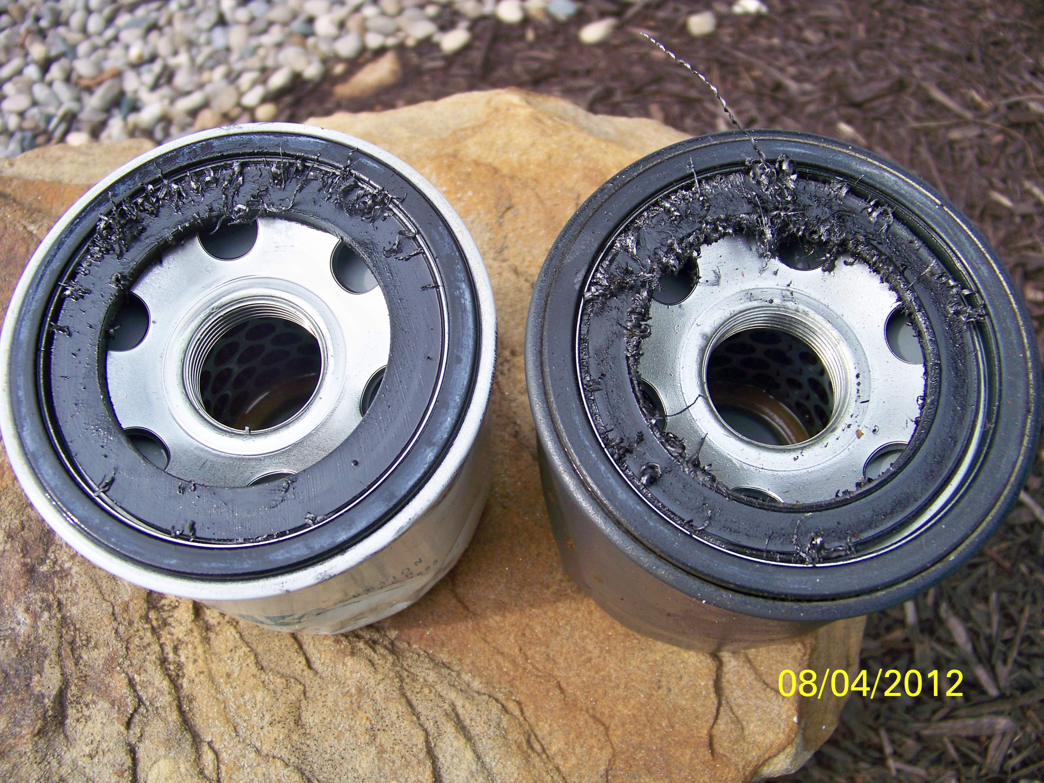

Here is a side by side camparison of the first filter change (grey filter) and the most recent filter change (white filter)
At this point there is no extended warranty deal they might pull out of their hat that would satisfy what I have found. I realize not everyone changes their own fluids and filters but problems like this make me glad I do rather than letting the dealer. I have read sevral good ideas on here from all that have posted. I do appreciate it.

Well I spoke with the fella from Kubota today. He was quick to point out that the amount of chips from the second filter was less than the first which was what Kubota was expecting. He also stated that I have a "laundry list" compiled on the unit so far and I need to keep taking pictures of the filters and sending them in to be documented.
As far as anything being done right now...........it's not happening. He said there has to be a failure. I brought up the possibility of some chips getting into some open bearings and although he didn't deny the possibility, he said we have to wait for a failure which by the way he is almost positive that if something serious hasn't happened yet, it probably won't.
He mentioned Kubota bought this last filter and fluid change because they thought it would "make me happy" He basically put it out there and said that I still have a year and a half left on warranty, and if I keep up on ducumentation, they will warranty it for longer, depending on how the near future turns out with debris on the magnet. He suggested to change the filter again somewheres between 35-50 hours but it would be on my dollar this time since the amount on the second filter was less than the first. I'm ok with that, I'm not looking for someone to pay my way. Lord knows a filter ain't gonna break someone.
I was somewhat supprised by what little they offered, but I do see it from their side to kinda..........being failure of the unit is the next step. On a side note, I did strain the fluids both times I changed it and found not the first bit of any foreign material.
He did offer to pay to have the unit busted apart and power washed to see what else might be inside, if anything but didn't really think breaking that new of a unit down to be a good idea.
At one point after hearing him go on for awhile, he paused, and I asked if it is normal practice to assemble different tractor parts without thoroughly cleaning then and having some type of Quality control double check. All he added was Kubota does clean parts after processes but it was impossible to expect every part to be 100% clean all the time, everytime. I'm still thinking about that one.....
SOOO......now we all know how Kubota is handleing this case to date. At this point and time, I'm still shocked by the amount of metal on 2 filters. I don't dislike the L3200 one bit. It has done alot for me at our new property as well as our current house. I'm not necessarily ticked at Kubota, I just feel somewhat let down if you will. Hopefully the future with us and the tractor goes well. Might not have another problem from it. This is all I have for now on the matter.

/ Not so sure this is normal? #98
Thanks for the update.
Good thing is the magnet ring is doing it's job and no problems so far.
