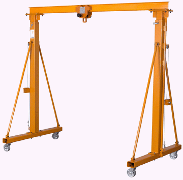

FYI, a gantry crane works best, even outside with heavy plywood to roll around on.

Hey Bob Rooks :)
Well I got it apart used the mini ex it was nice and easy with no problems, just took my time. I'll probably try to get some help lining it back up, the mini seemed to do okay. Well things didn't look horrible just rusty and covered in clay film{expected it}. I did get some pictures hopefully I'll get them on here in the next couple of days. I believe my problem was that I tore out the throw out bearing, the clutch didn't even look that bad. I did order all new parts{allmost $500.00} rather do a complete job and have piece of mind.
