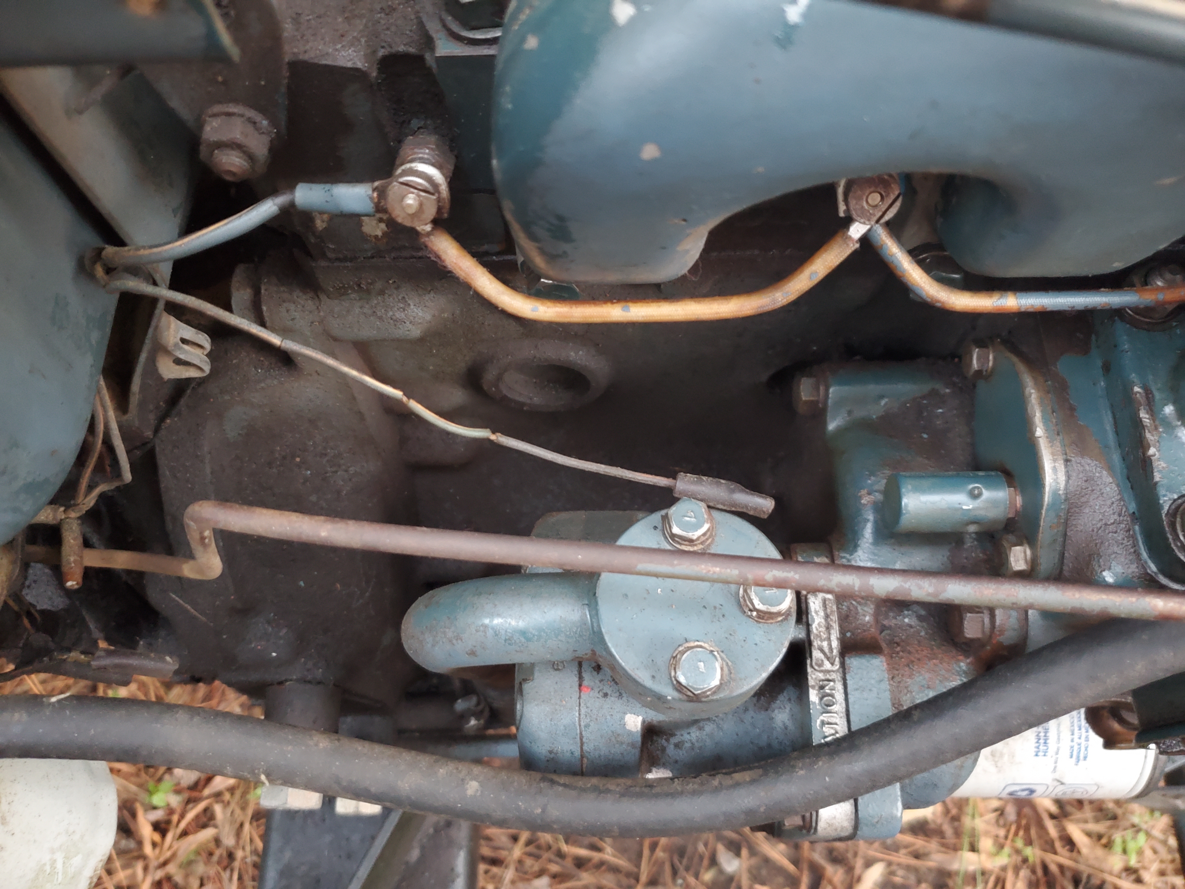

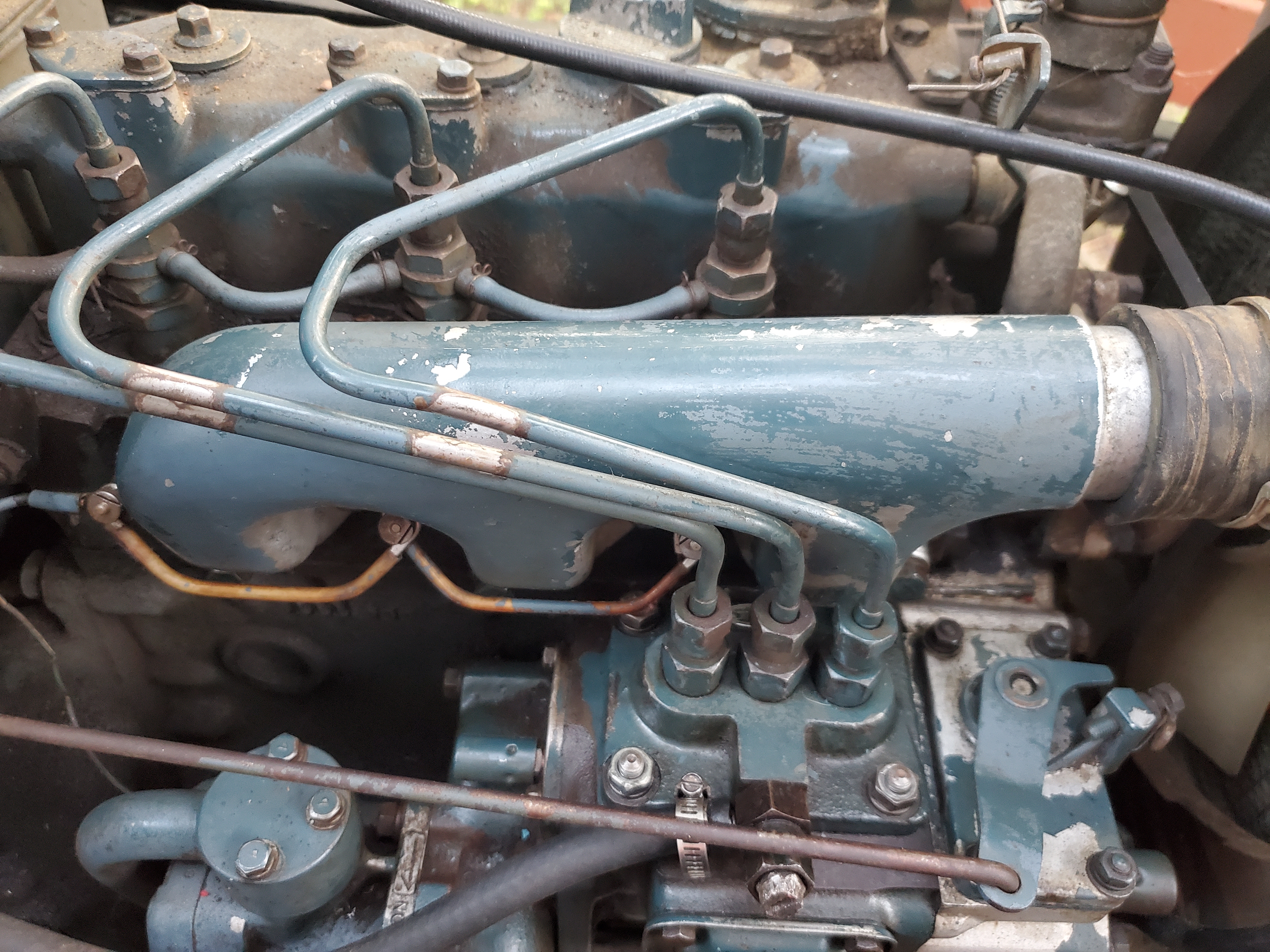

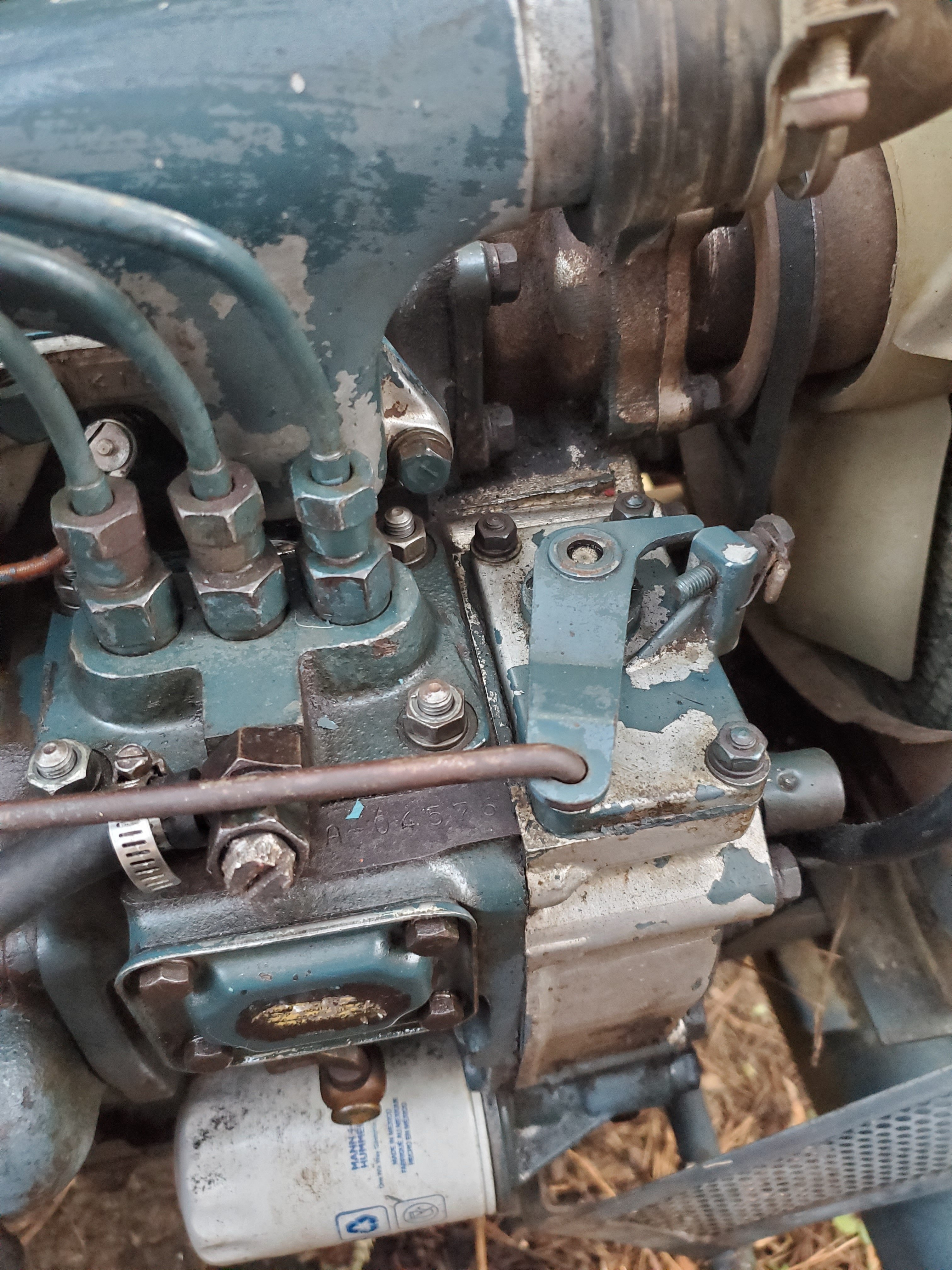

Hey there folks, It's been a while and this old L245 has been running very well,, until recently.. and it may be something I messed up... grrr.
So it a few weeks back I was running the brush cutter (not a Bush Hog Brand) and doing some general work with the front end loader. Had been going at it for a few hours and out of the blue, throttle control was sporadic. It would drop to idle speed and I would have to push in the clutch to prevent killing it, pump the foot speed controller a few times till it became responsive again, then I could go a few more minutes and it began again. After a few cycles of this behavior, I figured it may be running hot, so I limped back to the shed and let her idle low a few minutes then shut her down. I waited a bit and checked the fuel level, coolant level, and oil level, and all where fine. I then pulled the fuel line off the injector pump to make sure fuel was flowing, and it was flowing very well. Then I pulled the injector fuel feed lines, opened the petcock and fuel rose up through the injector pump openings. I figured it may be the injector pump, so I went to work removing the pump and doing some research.
I found that most folks agreed, that if the pump was functional, and it's rare that injector pumps completely fail, that you should not try to rebuild it due to the complexity and cost. So I decided to replace the brass delivery valve gaskets, the delivery valve holder o-rings, intake manifold gasket, and an injector pump shim. Jumped on German Bliss and ordered the parts. Put everything back together, primed the fuel lines, and cranked her up. She started right up but was running wide open like the throttle was all the way open. The throttle lever had no affect and the little kill lever didn't shut it down, so I closed the petcock and it shut down. I figured I must have missed aligned the pin on the control rack to the slit on the governor fork lever. I think I'm using all the correct part names.. Took it all apart 3 times, double checked everything, and it looks correct. Put it back together and it still runs wide open with no throttle control.

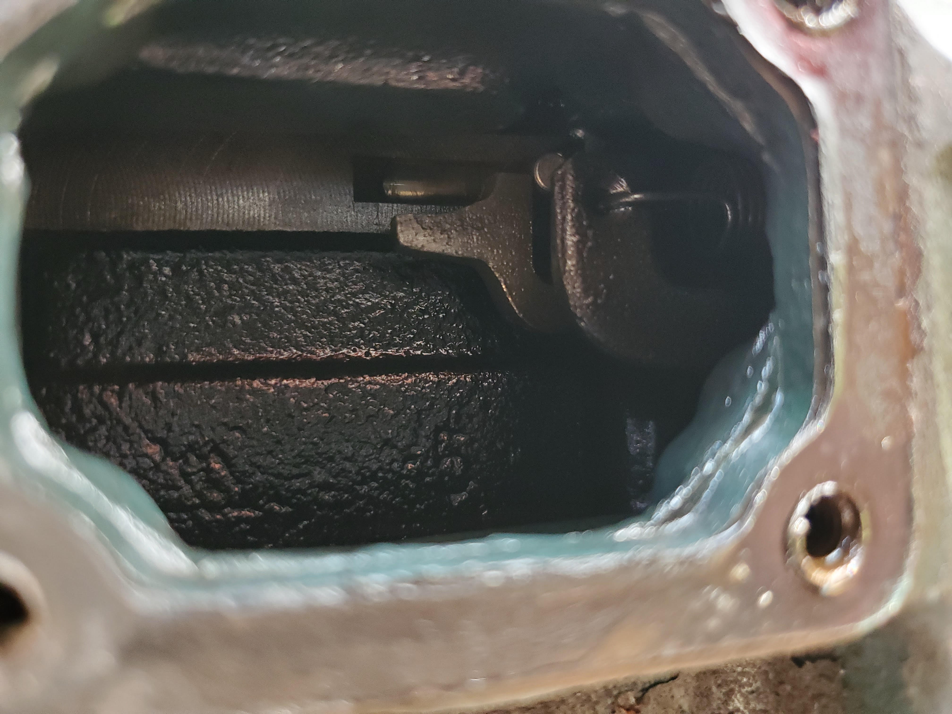

I took off the little cover to see inside and the pin is in the slot. So now I'm just confused. Did I just not reassemble it correctly, or did I break or bend something with the governor? I'll go snap a few pics and post em. Maybe you guys can see something I missed.
Thank and sorry for the long post..
/ Kubota L245F No Throttle Control High RPM at start up maybe governor? #2
Just see if the rack moves left and right..
If u have an electric shut off solenoid that screws into the left side of the inj pump “block” and u didn’t remove it FIRST.. now would be a good time to take it out and inspect it.. along with the inj pump rack..
It’s hard to tell from here if u sheared off a locating pin.. but it’s highly possible..
Just remember, after your done with the inspection, the rack should move VERY EASILY left and right..

I was able to get the injection pump out and the speed control plate off, without loosing the springs, and I tied a string on it as advised.
The good news is that I was able to get the pin out and the shaft removed. The bad news is I'm having a really hard time finding the replacement part #15221-56020 LEVER, GOVERNOR. I did find a used plate assembly but not sure if it's the correct one. My engine plate says it's a DH1101A and the engine is blue. The part I found came from a DH1101 and it's orange. Other than the color, what's the difference in the 2 models?
Have a question about the governor. I'm having a difficult time uploading a video so briefly: Looking straight down into the speed control plate opening, I see, what looks like a bell inside the gear, that moves back and forth when I work the governor fork. It's a bit slow to move from front to back. Is that normal or should it snap back quickly?

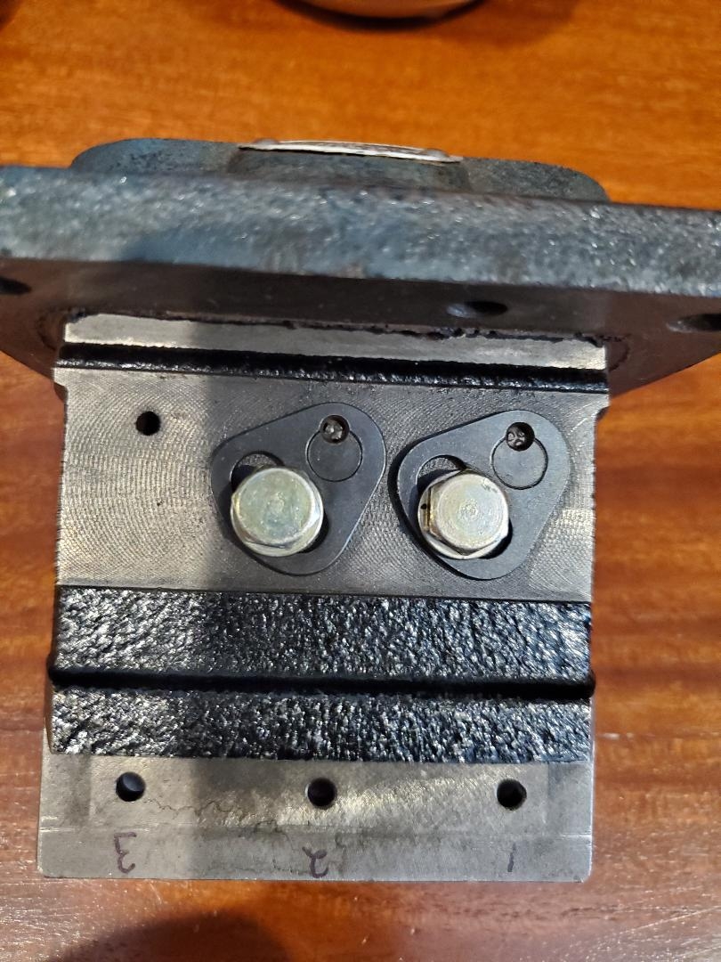

I was inspecting the main body of the pump and noticed there is no pin in the whole to the left of the 2 adjust plates. I'm assuming that pin is to keep the element from rotating in the cylinder. Am I wrong?
/ Kubota L245F No Throttle Control High RPM at start up maybe governor? #9
Yes and no.. but for this conversation, yes, u r correct.
It’s actually a locating pin.
There should be a pin there..
U can use the back end of a drill bit to locate it while u TORQUE the delivery valve holder..( top nut) THEN REMOVE the bit.
Good to know. I thought the "element" would be able to rotate once everything was assembled and the pin prevented that. So once that delivery valve holder (#2 on the parts drawings) is torqued, that element (#6 on the drawing) stays put.
