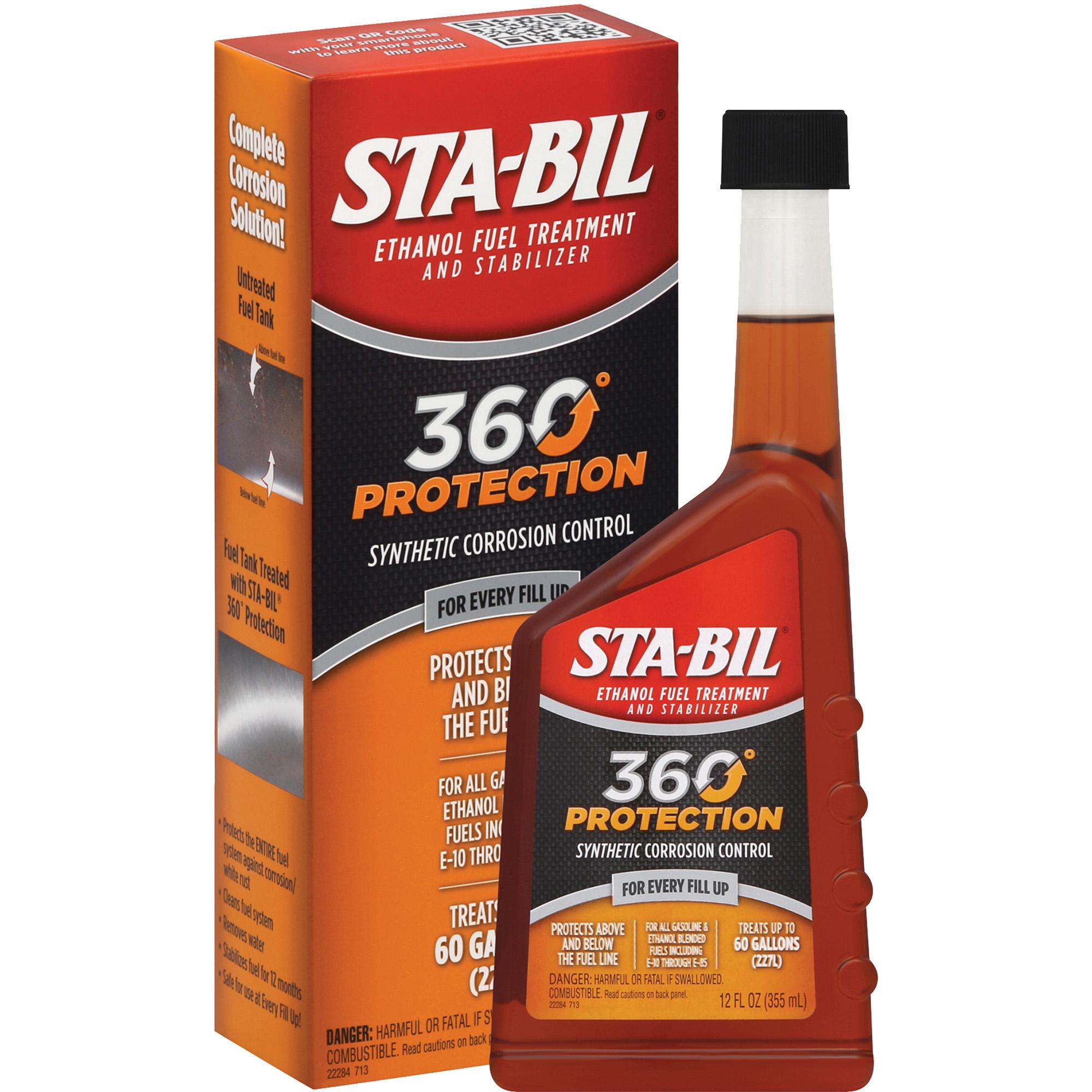

I've been using Stabil Protection, now known as Stabil 360 Performance. For the past 3 years or so in all of my small engines, not one system issue, perform regular maintenance yearly on all of them without one issue with the fuel system on my Stihl BR600 blower, Husqvarna string trimmer, Mantis Tiller, Stihl MS 290 chainsaw, or Husqvarna lawn tractor. Everything runs as it should even if the gas sittings around for longer than 6 weeks.
