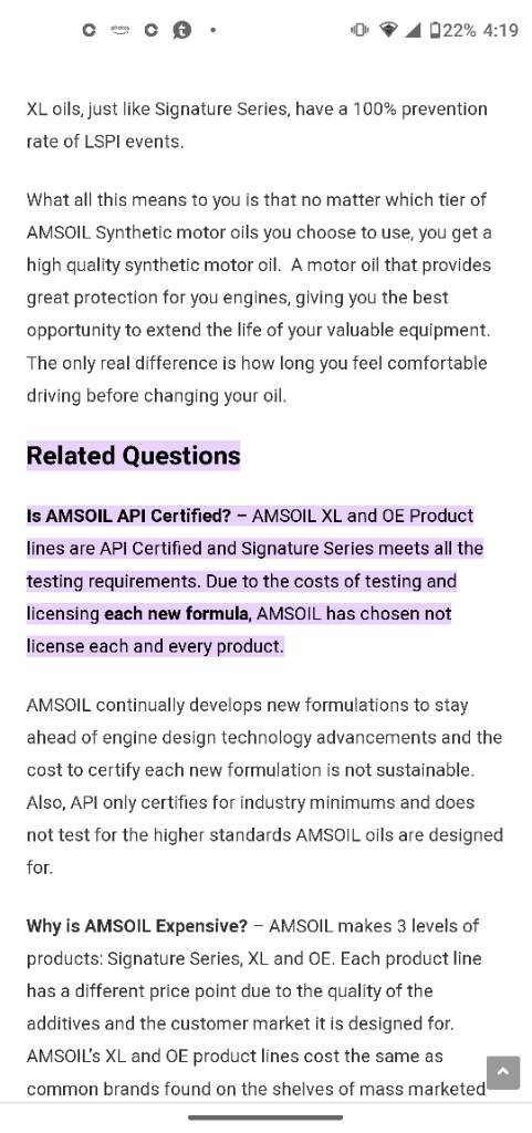

I think my Kubota states required minium API Certification is CJ4. T6, if I remember correctly has both CJ4 and Ck4 which is the improved new classification.
I can't say much about Amsoil. Always thought it was good oil and have not read any complaints about it. I do not see the API classification for Kubota on the links.

I went to the Amsoil site they want me to
play gotcha I'm too old to play games to
enter a site.
I removed the web site but you know its
on the internet it's gotta be TRUE?? :unsure:
