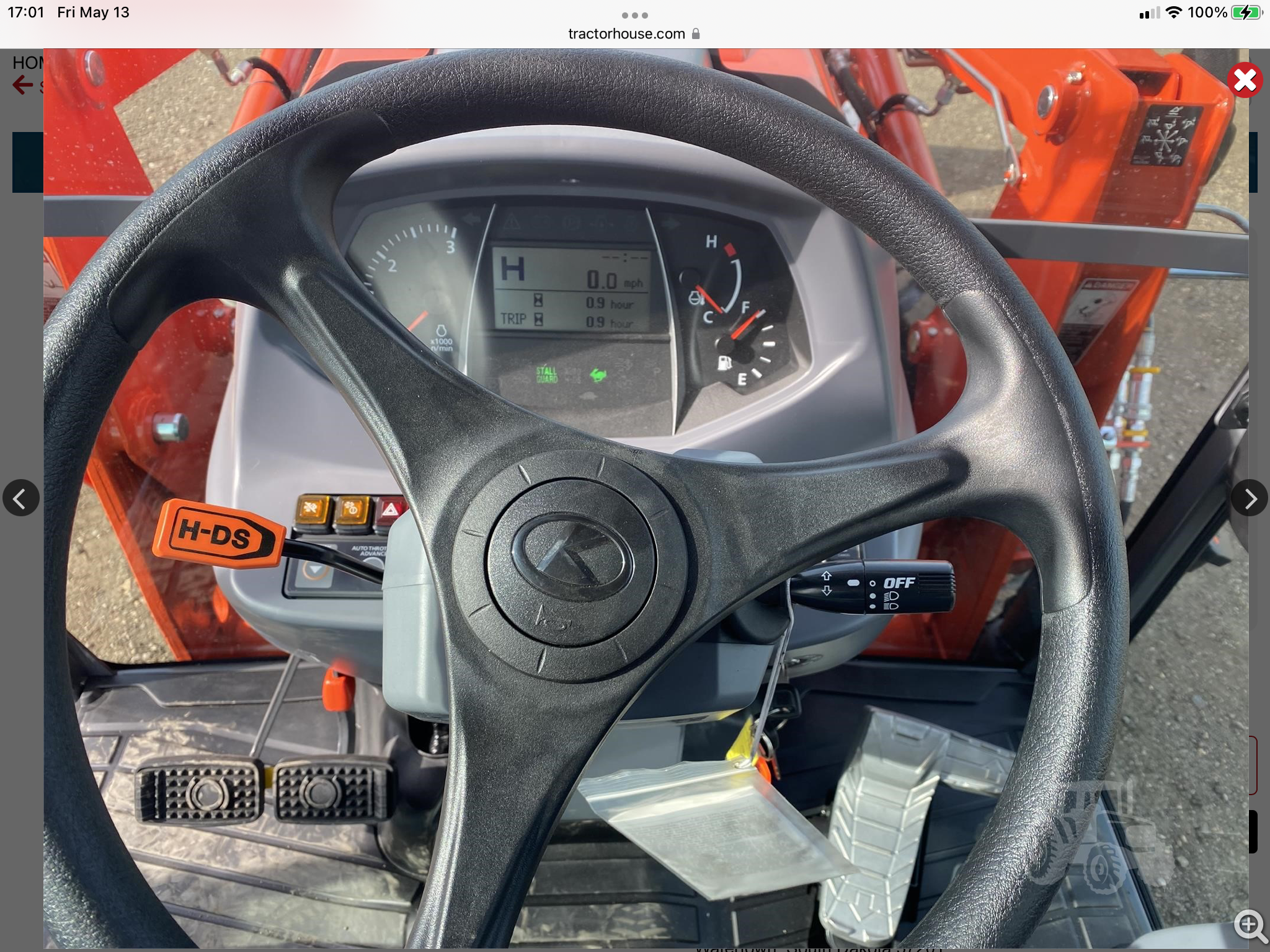

The newer style pedal is also available on the Grand L series as well, the L3560 has it, I read somewhere that it's fly by wire (solenoid controlled), not cable operated as mentioned

Solenoid would be on or off controlled by an on or off switch. The hydrostat control would probably be servo control where a potentiometer on the pedal controls a servo electronically in a linear manner. I don't know this for fact, just guessing.

I have a Kubota Grand L with the smaller all metal wired pedal (below). My heel stays on the floor at all times when going forward and with just light toe pressure on the right side to advance. Yes it does involve shifting the entire leg & foot backwards for me to ’toe‘ for reverse. No biggie. Placing your entire foot on top and rocking is doable but only for short periods of fine manevouring for me. Chevy vs. Ford. It’s likely what one gets used too. I like it.
