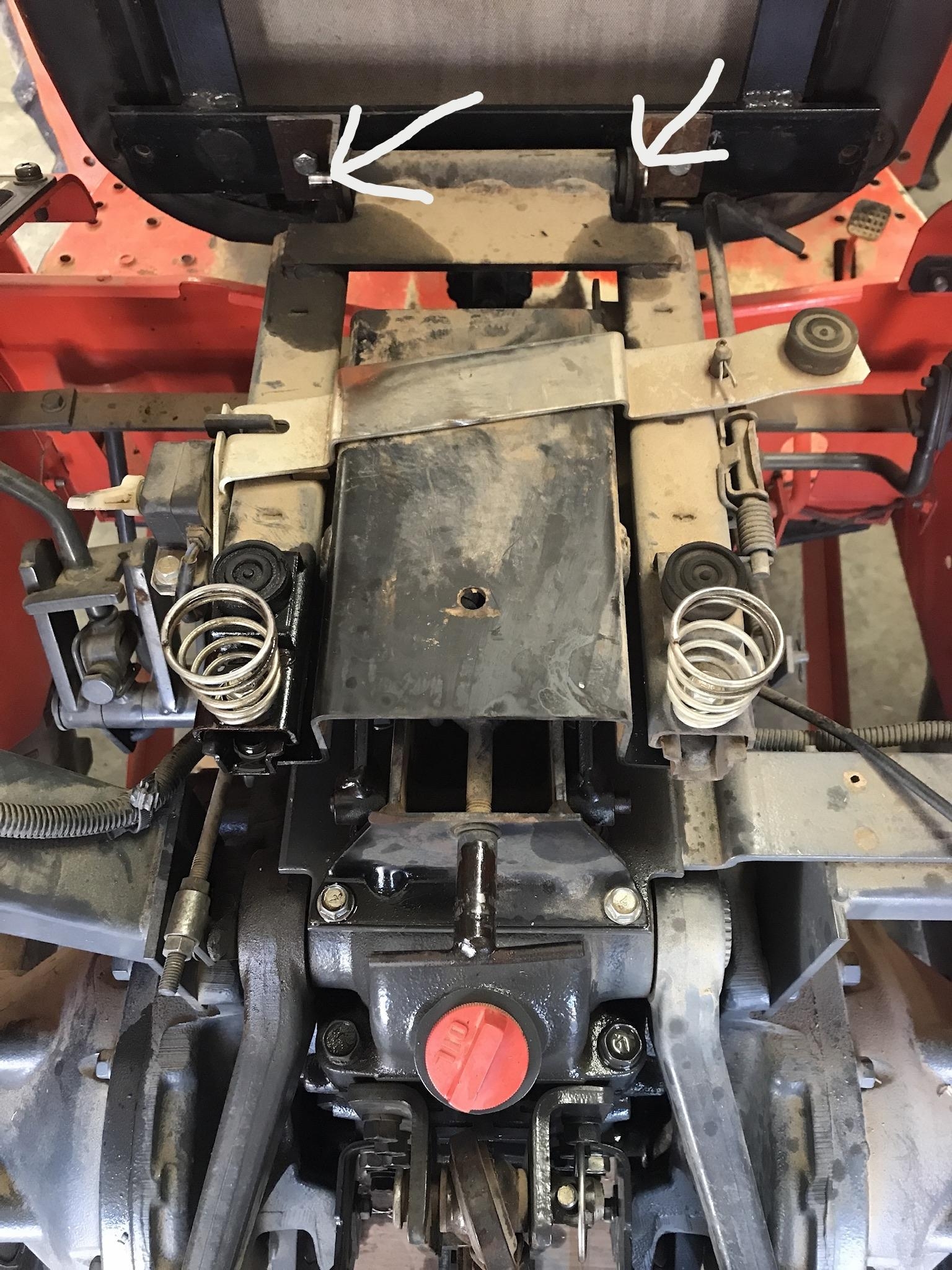

I have a 2012 Kubota L4400 and I’m upgrading the factory seat because the original one isn’t very comfortable. My nephew gave me a replacement seat, and mounting it wasn’t too difficult. However, the new seat is noticeably heavier than the factory seat, and now I’m getting excessive side-to-side rocking.
The original seat had a small amount of play, but it was controlled and never felt unstable. With this new seat installed, there’s significant lateral movement in the suspension/base. When driving the tractor, especially over uneven ground, it rocks side to side enough that it feels unstable—almost like it could make you seasick.
I’m assuming the extra weight may be overloading the factory suspension or pivot points. Has anyone run into this when upgrading seats on an L4400?
Any advice or recommendations would be appreciated.

Did you find the solution? To me it seems installing heavier duty springs below the seat would fix this problem, or doubling up with same type springs
/ Kubota seat upgrade.
Yes I did, I took everything apart and found there were some of the welds had broken on the suspension part. I beefed a few things up one being the front pivot.
I removed the rubber and made it a solid mount up front plus removed the 2 springs and bolted the back down solid.
What I did made a big difference there’s a little wobble but not much at all.

Stuffing the spring centers with "firm" upholstery foam is an easy way to up the spring rate.
heck, I've rolled up suitable strips of inner tube, secured the roll with a zip-tie, to stuff in a spring so as to increase the load capacity.
