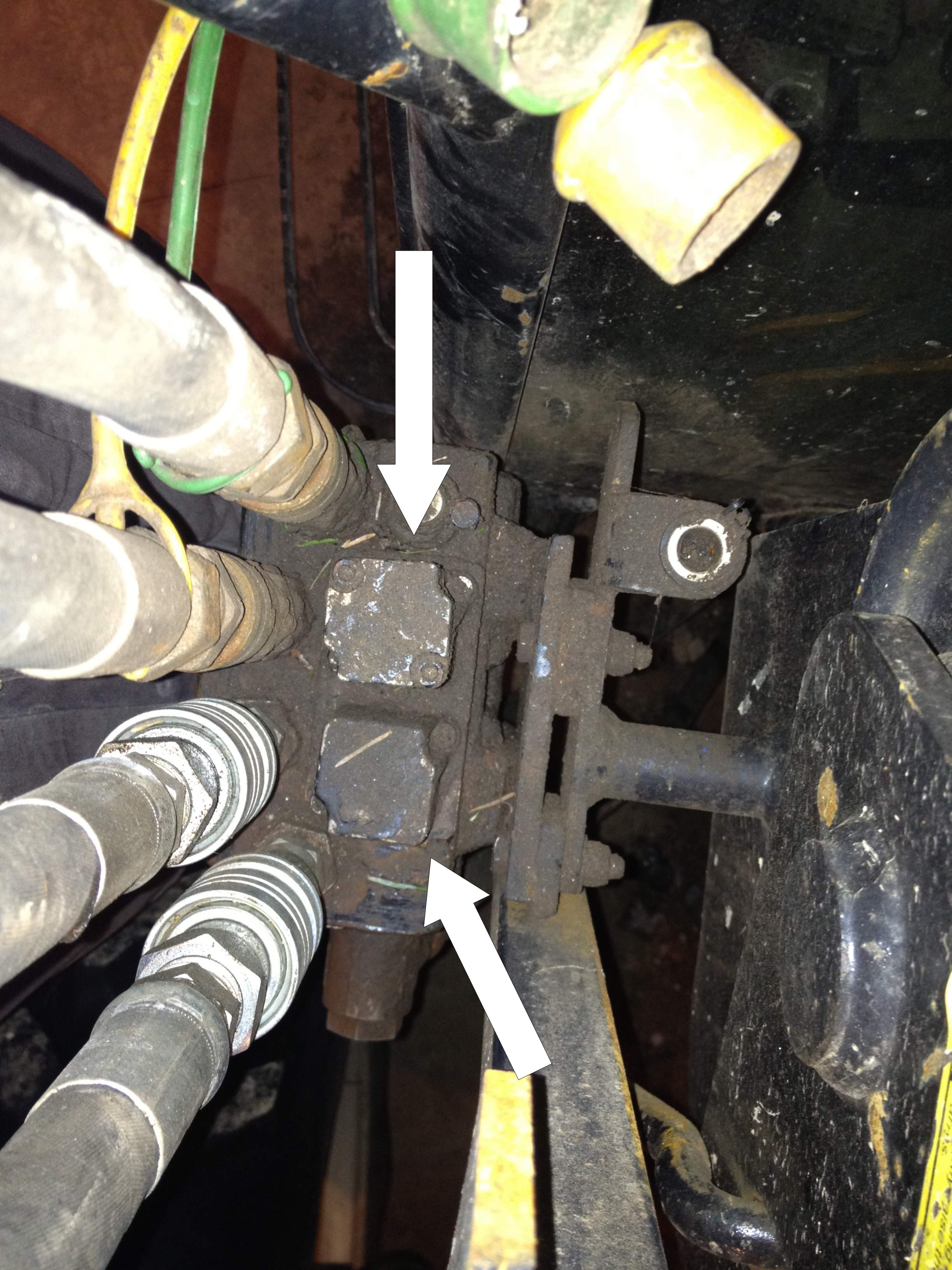

Here are some pictures...
IMG_0216.jpg[/ATTACH]
I didn't notice until now but in the view from the top there are what look like 2 caps, one over each spool. Should I remove those and check, clean, etc? Also if I want to remove the cable does it fasten directly to the spool?

/ Nimco Controls freezing #14
The most common problem of valve freeze up is moisture under these caps. See arrows on your photo.

If I am to remove the caps for inspection is there any pressure on them. I am assuming the springs, etc are under the caps?
