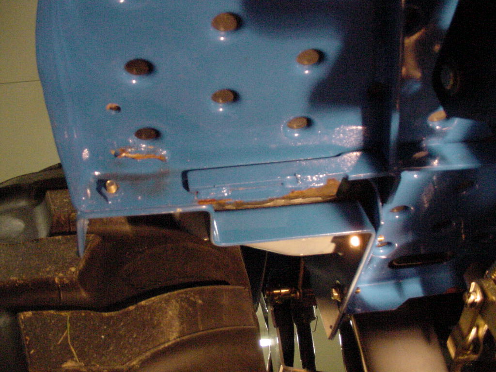

While i was under the tractor i noticed some rust on the bottom side of the platform. Is this common for a 5 year old tractor? Is there any way of preventing this? I suppose removing the rubber mat would help cause it wouldnt trap the moisture.
It doesnt seem like it should be rusting away already

On the platform, I don't know. I have a 18 year old Ford and it's not rusty under the platform. Probably pretty hard to clean up. I would check under the mat to see what the top looks like, and at least clean and protect that if it's rusty. Do you know where this thing spent it's baby years?

Concerning the deck--Mine is starting to rust on the bottom also. 10 yrs. old and has had a rough life. And it never saw any salt. I plan to remove the deck (if that's possible) and have it sand blasted and then repaint it. I need to catch mine now before I put my foot thru the deck.

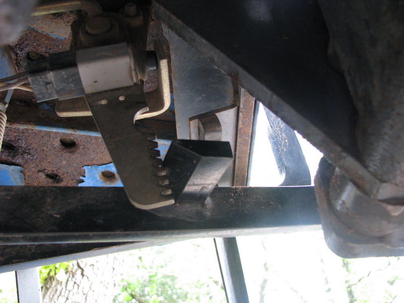

Deck - there are countless reports of the Class III boomers having paint and rust problems on the underside of the platform/deck. In the early days of TBN, I think I even recall where someone got a new platform from their dealer as a result of it being so bad on their tractor. Mine, a 2001 model, started chipping/flaking, with rust underneath the paint, after the first year. My tractor has never sat outside overnight, nor left wet. I attributed the problem to poor metal prep, maybe even painting over rust, or problems with all these low VOC paints used now, which maybe don't have the same rust inhibiting nature as good old oil enamels. I guess if water where to get under your rubber mat, and stay there for some time, it contributes to the problem, but for most of us, that is not the real problem. In fact, on mine, the flaking started on areas well away from the rubber, on the bottom, and typically on the bracing. I've attached a few pictures taken when the tractor was only about a year.
Differential Lock - yes you need to keep your foot on it, or else it disengages. This may be a bit awkward, but I don't think you'd want it otherwise, less you forget it's on and damage the tractor. The older Ford 1310/1320 - 2120 tractors had the pedal in the exact same position and I think it was thought to work OK, so the design has just continued. Probably the thinking is that you are only using it on rare occasions, so keep it out of the way. I personally like it there.
I noticed this rust about two weeks after buying my tractor. I think the factory just paints over the rust and lets it go. Huge sheets of paint flaked off my platform, but it is so thick that I don't ever expect it to be a problem. Is sure looks nasty though. Here is a picture of my parking brake pawl and you can see the rusty platform. I've had the rubber mat off the top and it looks fine. I have no idea why the bottoms of so many platforms are rusty like this.:(
