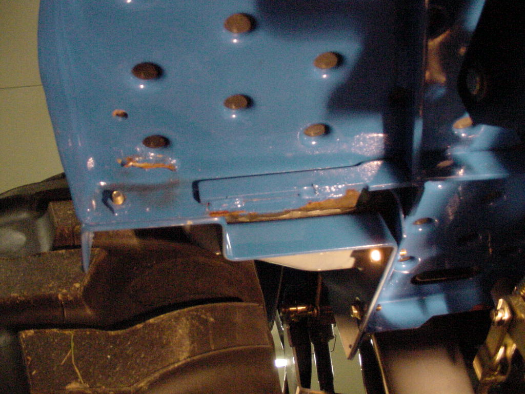

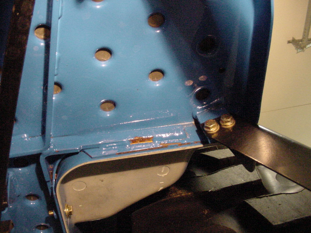

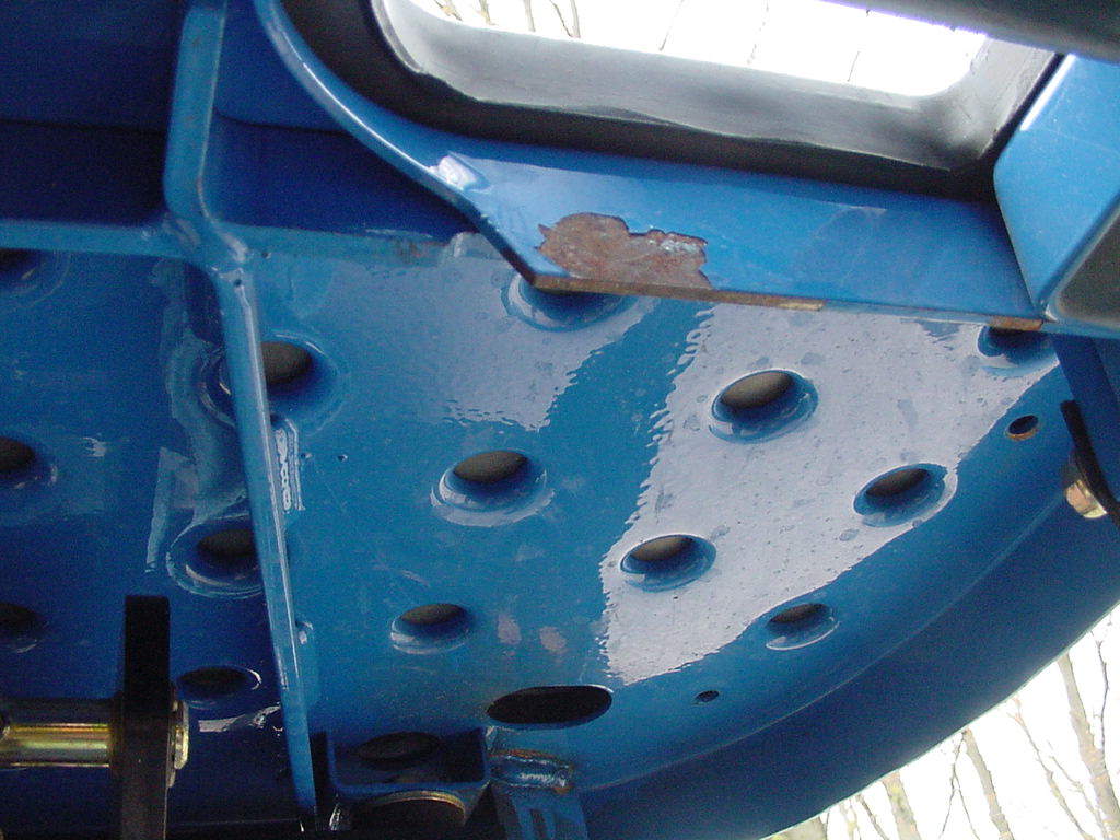

Deck - there are countless reports of the Class III boomers having paint and rust problems on the underside of the platform/deck. In the early days of TBN, I think I even recall where someone got a new platform from their dealer as a result of it being so bad on their tractor. Mine, a 2001 model, started chipping/flaking, with rust underneath the paint, after the first year. My tractor has never sat outside overnight, nor left wet. I attributed the problem to poor metal prep, maybe even painting over rust, or problems with all these low VOC paints used now, which maybe don't have the same rust inhibiting nature as good old oil enamels. I guess if water where to get under your rubber mat, and stay there for some time, it contributes to the problem, but for most of us, that is not the real problem. In fact, on mine, the flaking started on areas well away from the rubber, on the bottom, and typically on the bracing. I've attached a few pictures taken when the tractor was only about a year.

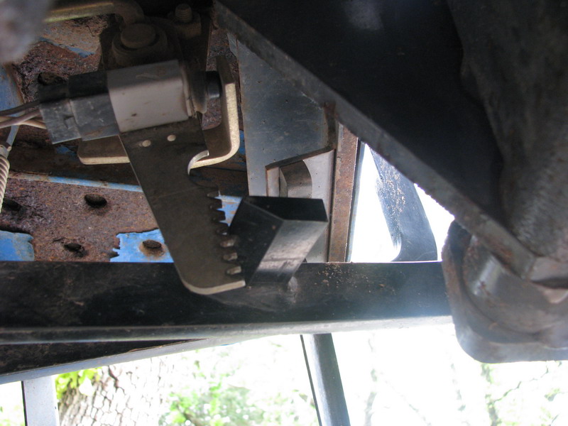

I noticed this rust about two weeks after buying my tractor. I think the factory just paints over the rust and lets it go. Huge sheets of paint flaked off my platform, but it is so thick that I don't ever expect it to be a problem. Is sure looks nasty though. Here is a picture of my parking brake pawl and you can see the rusty platform. I've had the rubber mat off the top and it looks fine. I have no idea why the bottoms of so many platforms are rusty like this.:(
