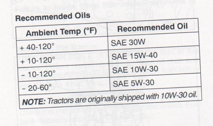

I was at the NH dealer and the chart they printed out recommended 10w30 i was thinking 15w40 Is there an oil weight that the op manual recommends?
One more time. . . read my last post. The chart lists 15W40 and the NH part number for quarts and 2.5 gal containers.;)

The chart is confusing, Your chart shows the first engine oil as 10w30 2.5 gallons. It also lists 15w40, SAE 30 and 5w30
I wonder why the dealer printed out a capacity sheet and it said 10w30
   / NH TC40DA just bought ????? #33
This chart shows which one to use based on conditions.

It looks to me according to the chart the 10w30 would be the best all around oil?
Repowell what do you use in yours?
   / NH TC40DA just bought ????? #35
15w40, same as my pickups. It does not get that cold in East Texas but it does get hot.
   / NH TC40DA just bought ????? #36
ND, try whatever you think is best based on the chart, but I think that unless you use full synthetic 10w-30, you will find that 10w-30 is still a little heavy for the winter if your tractor sits in an unheated space. Based on my own experience of almost 30 years of having 3 similar tractors stored both in and outside of heated spaces, I found that it took 15 seconds or more just for the oil light to go out if the barn wasn't heated. This essentially means no new oil was getting up to the upper portion of the engine during that time. Oil on the NHs must travel up a very small tube on the outside of the engine (right side, about midway back) to get to the upper portions and the pressure sender. Maybe not a big deal, but not what I wanted to see. When I switched to 5w-40, the problem went away. Easy cranking and the light went out in a second or two. IMHO, I definetely would not use 15w-anything in the winter in ND in a TC-series, heater storage or not.

I would agree 15w-40 is not for use up north, I do believe it gets cold up there. If it gets below 32 degrees I am not on my open station tractors anyways. For those that wonder, yes, I do tie kerosene rags around my ankles to keep the ants off my candy a--.
