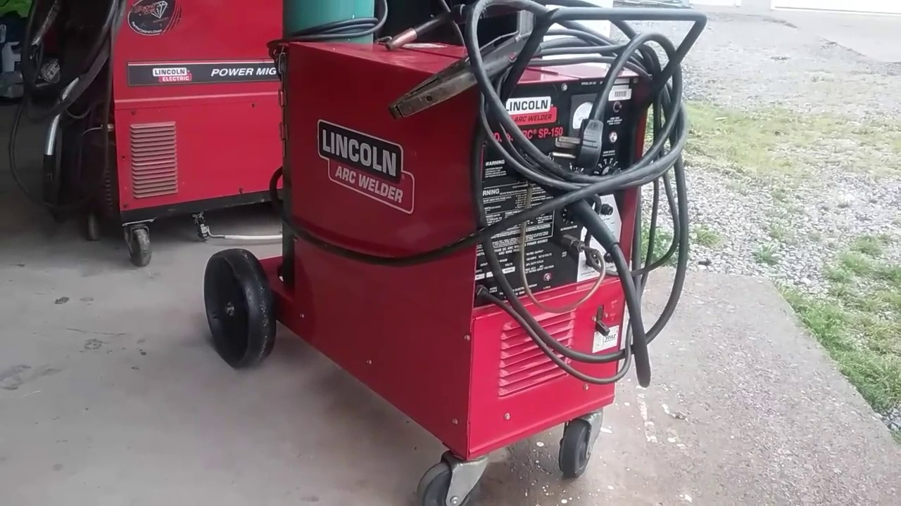

I bought a used Lincoln Idealarc SP-150 back in 1990 and it has served me well on all kinds of car, tractor, trailer etc. projects.
It's obviously not a current model, but used ones are still available.
Totally trouble free Professional machine, bought used 30 years ago for hobby use.
It is excellent for welding thin sheet-metal and can do up to 3/8 inch in one pass.
Photo from online, my cables are not a mess like that:
I had an SP200. So smooth it seemed like it was low on power ( high inductance ) Great welder. You could flip open the side door and actually remove the feed system which was the same as an LN 7 feeder. You could go as far as the cables you chose to install. One of the best. I'd like to have your 150 which is as good or better than most posted on this run.
