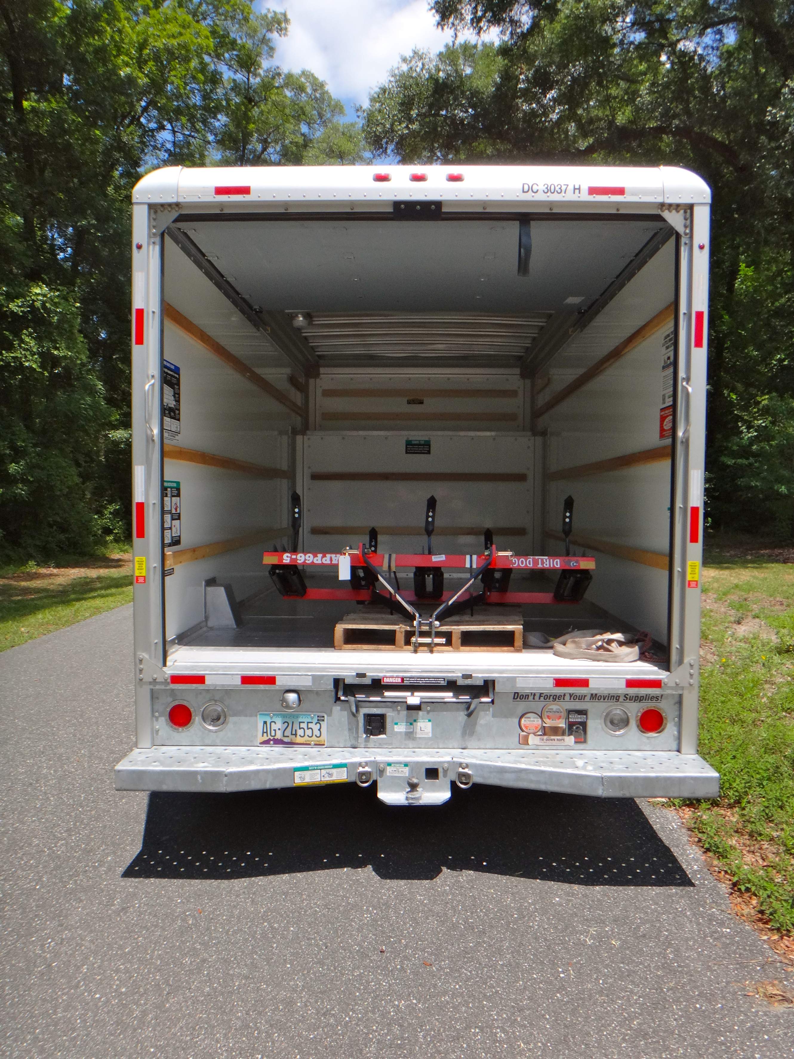

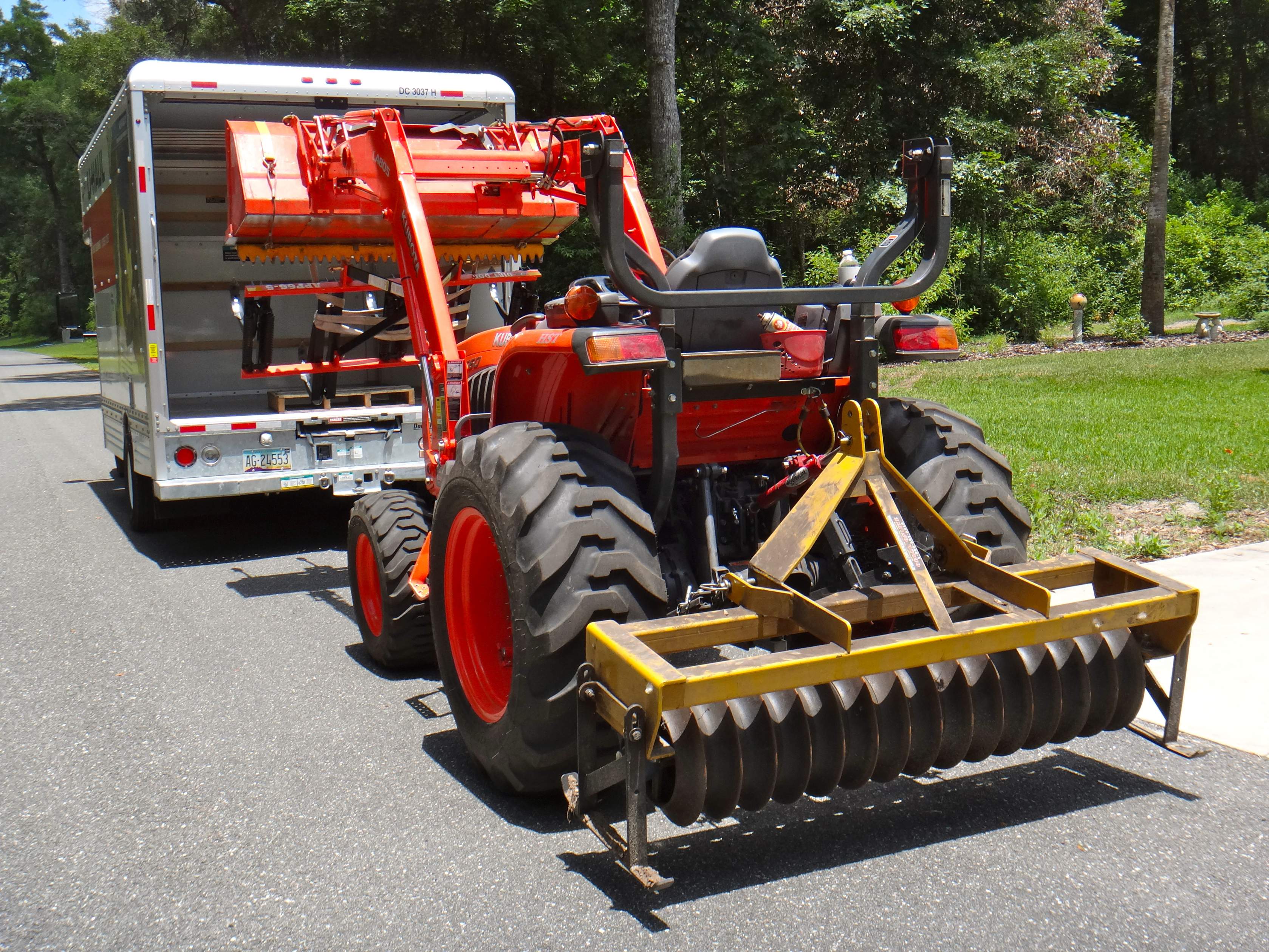

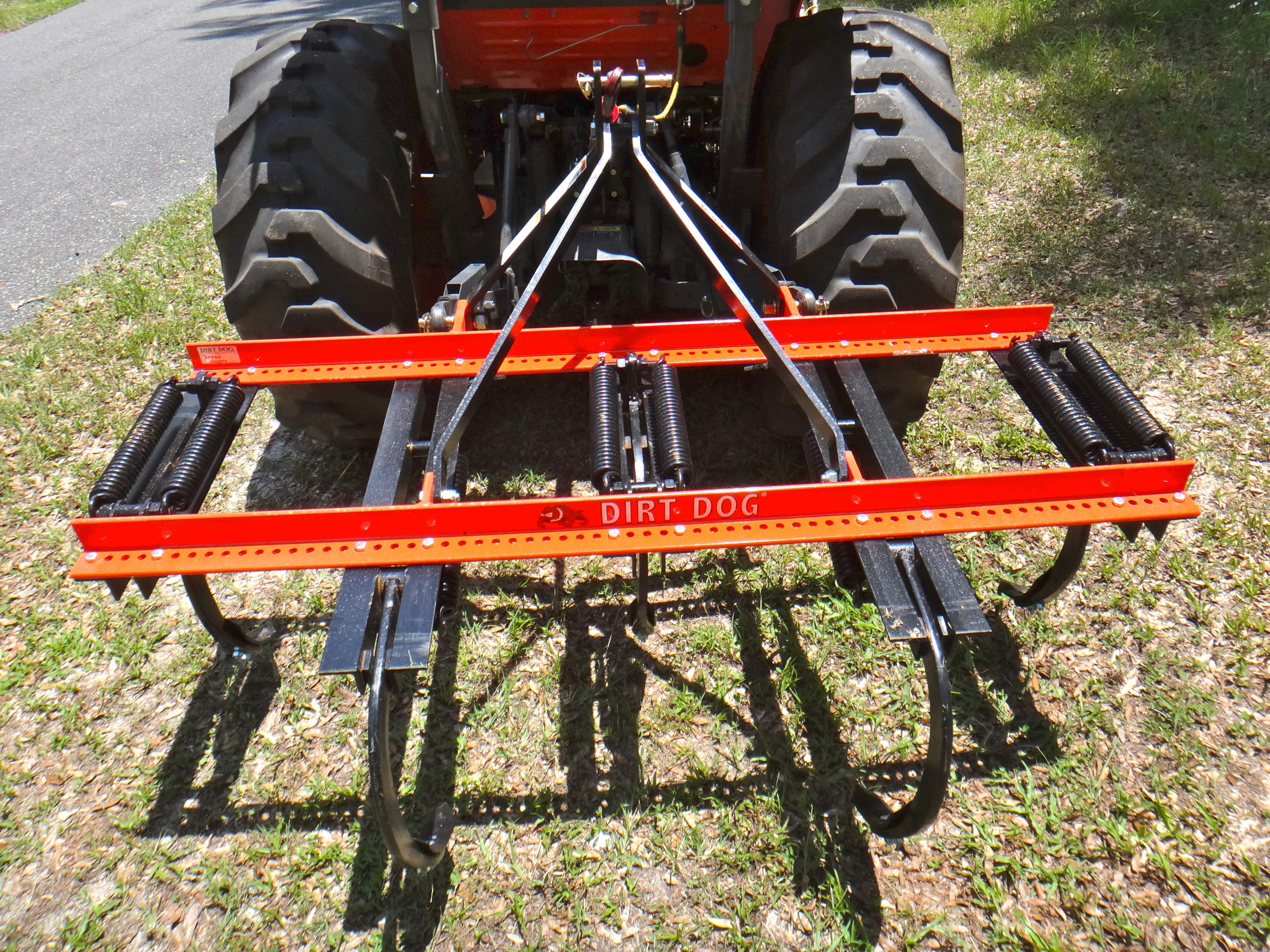

When you order tractor attachments online (say Titan/palletforks(dot)com), do they come on a pallet?
YES/SHRINK WRAPPED. Implements typically change trailers several times at freight depots before reaching final destination. Without pallets for protection few implements would arrive undamaged.
With Bucket Hooks and chains you can unload some implements up to 500 pounds. I always tip drivers delivering implements $20.
PHOTOS. NOTE 600 POUND COUNTERBALANCE.
