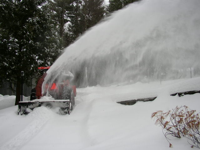

I'll chime in on the side of 50 hp and a rear blower. I have found that a rear blower will chew up whatever the highway plow builds up at the road - even alternate "crusty" layers from freeze-thaw cycles. The layers are not very thick so it all breaks up and the auger/impeller handle it just fine. If it's really deep, just go slower. For a gravel road, the bottom skids can be set to hold the blower off the ground a little. Or, if you have one gravel and one paved drive, I saw a rig with each skid on an eccentric with a lever - so each end of the blower could be quickly jacked up a little if needed. I find that at the beginning of the season some small stones get scraped up, but after the ground freezes the problem goes away. Rocks generally need to be 2" or bigger to hurt anything - and then its usually just a shear bolt on the auger chain drive.
