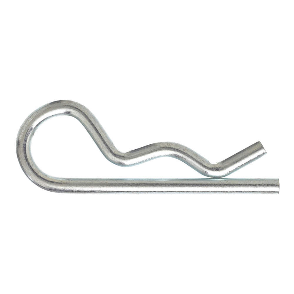

Perhaps cotter pin was the wrong term. I was thinking more like this style.
At least 3/16”
I figure 3/16” would be sufficient to keep the arm inward. Maybe a flat washer between the pin and lift arm ball. View attachment 649995
I fear that even that style pin in place of a cotter pin will not hold up to the force that can be placed on the lower lift arms and pins holding them. Realize the size of lynch pins that are used to secure your lower lift arms to the implement pins. My tractor uses a similar pin with lynch pin to secure the lower lift arms at the differential housing. Also keep in mind that lynch pins are harden.

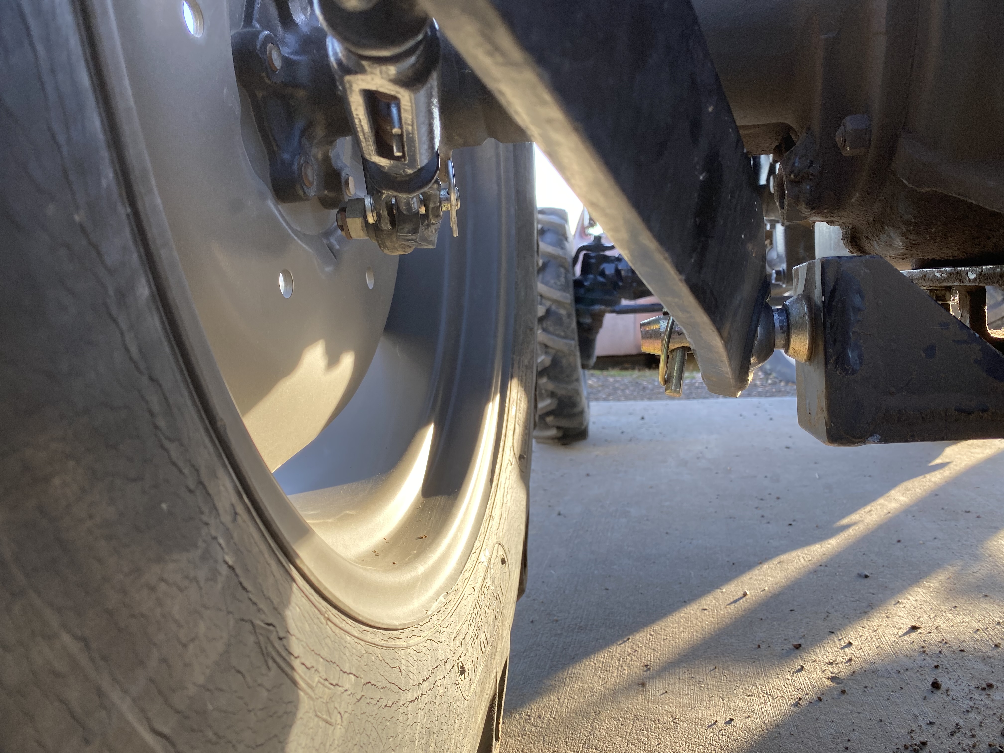

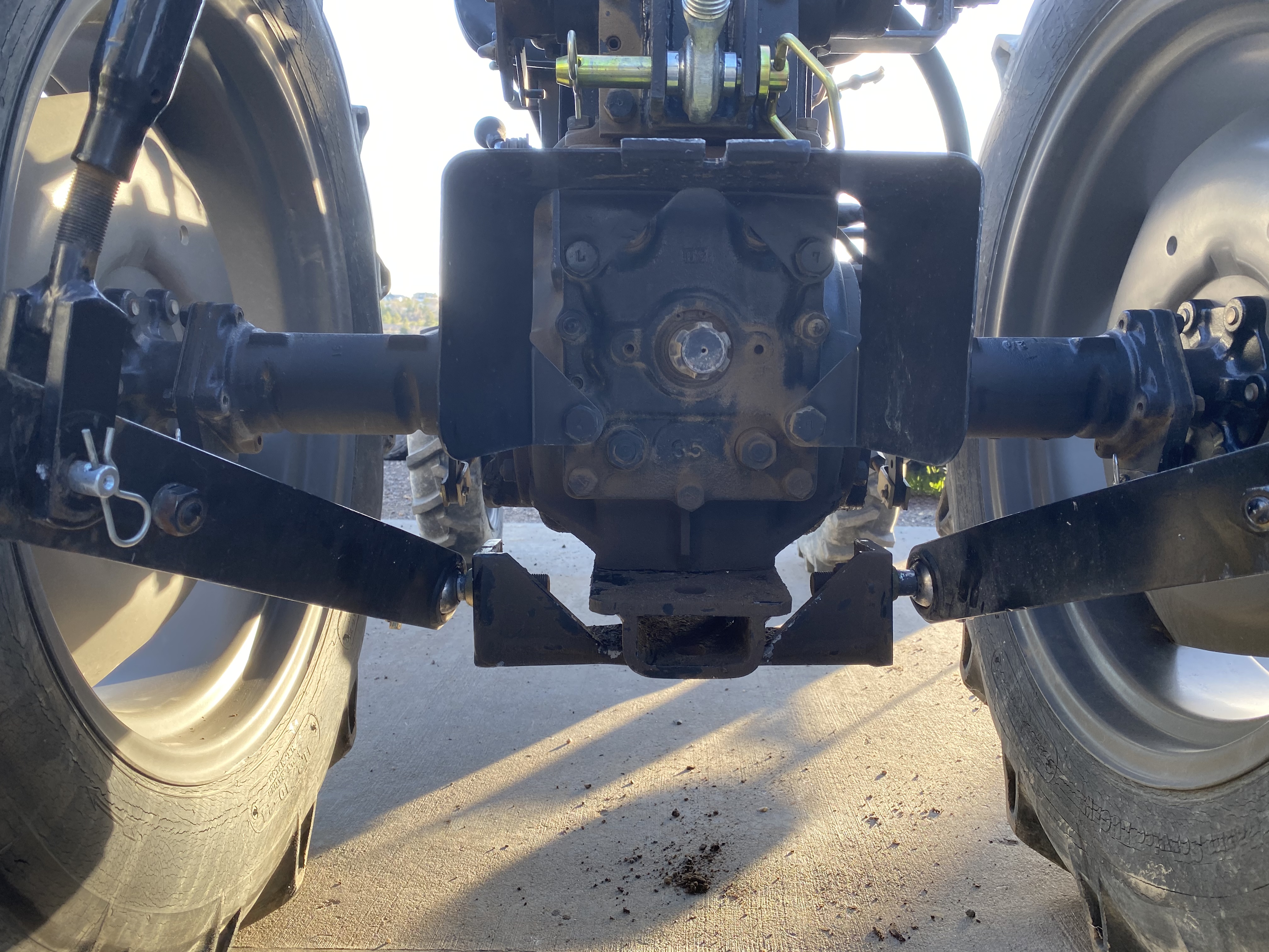

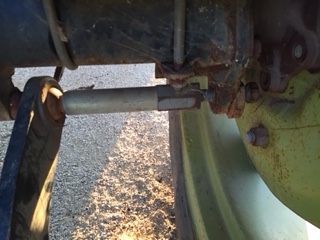

I decided to mess around with the lathe today and built some pins to relocate the 3 link bottom links back in the proper location.
Problem with the way the guy before “fixed” them was the slack adjusters and bottom links weren’t on the same plain. So the slack adjusters would bind up 3/4 of the way up, and be completely loose down low.
I also didn’t have but 50% range of motion on the 3 link.
I basically turned down a chunk of hot rolled bar to match the factory hole in the rear end, then continued with 7/8” for the bottom link to slide over. The outer portion I turned down to 5/8” which was what the internal diameter of the coupling nuts were when I removed the threads through half of them.
I left the other half threaded and drilled out the slack adjuster plates and ran a bolt through them.
Seem to be a viable repair. Time will tell. I figured having the bottom in double shear would be a lot better than the original single shear pin.
A9702C3E-0416-4CD6-A926-E93D527B4B43.jpeg35AF3631-5B97-4A5B-B328-6DAE77262A63.jpegA846AC73-7B79-40CF-90E3-A611BC6552B5.jpegBBD52F5D-C443-452A-9FDD-17CC6DE73249.jpegF5AFEBDC-FD1C-4FAD-986E-296AE69F06A7.jpeg
Best part is Ive regained full range of motion and the slack adjusters remain consistent all the way up and down :)

Those pins look pretty much identical to the factory ones in my 240. I would caution to make sure the bolt is tight each time. If they work loose they either get snapped off or take out chunks out of the hub. Ask me how I know! :)
/ New ym240d owner
#55
Hum. Solid advice!
I used red lock tight on the bolts. Hopefully they won’t go anywhere ����
I would have preferred factory pins, but I doubt I’d find any.
Plus the previous owner welded the broken piece back on the rear end after he broke out the original pin so the threads were all messed up internally. Figures this would do the trick.
/ New ym240d owner #57
Looks very good. Always good to have things in line with the original design. The red locktite should keep the bolts in place.
