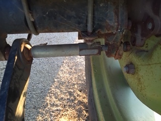

/ New ym240d owner #22
Here is a pic of one of the pins installed on my 240D. They are really tough to find however and if the casing is broken may not work anyway. This pic was taken before I filled the gap on the right with a link for a limiting chain.
Ahh yes. I’ve heard of those. Sounds like the original “single shear” pins are prone to breaking the case.
The solution was this.
While I like this idea, I think I’m going to straighten out this bracket contraption, and then add dons additional bracing that utilized a couple bolts that attach the axle housing to the differential housing. My hopes is that I’ll provide some vertical bracing, and perhaps a little horizontal bracing as well.
I like the idea of it being made of mild steel, which would hopefully provide some movement under heavy load instead of breaking a hard solid point.
I think that is the legendary OEM long pin!
Does it look original, or shop-made? Where did you find it - or was it already on there?
The busted out part on mine (shown in that post I linked) is on the front side, indicating the original damage was done crashing into something going in reverse. When I bought the YM240 the right side pin was one of many sloppy loose threaded connectors, and it already was missing a piece out of the casting. The nut on that side was missing, somebody did that to let it thread in deeper. I applied red (permanent) Loctite and threaded it back in until it bottomed, which again, didn't leave any threads for a nut. That lasted ~12 years until it needed a similar repair again but this repair came loose after a couple of seasons.
I couldn't find a long pin like you have. I had to replace the right axle assembly complete.

They were on the tractor when I got it but they do look original. The tractor was really abused before I got it. No fault of the owner, she hired a local kid that she thought knew what he was doing. I took them off once to replace the lift arms that had been bent when he tried to push a scraper blade in reverse and hit something? After she almost flipped driving it into a ditch and got it to the point of almost not being able to start it after using starter fluid a couple times she parked it. I asked about it after 4-5 years of sitting and she told me I could have it. I got it started on a hot day and drove it home!
You said you’ve e removed this for a lift bar repair?
The parts manual make it seem like it’s just a pin. That the hole in the rear end isnt threaded, but smooth, is that accurate?
If that’s the case, I could spin this out very easily on the lathe. I could go as far as to fill the hole with........weld (probably far too much heat for that) or jb weld, then drill out to a nominal size. Turn up a couple pins and attach it exactly how this is done.
Now my wheels are surely turning.
I could even extend the current bracket I have to have the pin slide through the bracket before entering the rear end to better support it. I would end up at exactly the factory location at that point, and would be a whole lot easier than fabricating a giant assembly.

Lots of brands of SCUT’s do the inboard sway links. The inly issue with it is if you have non quick hitch implements, you really need a release system in the sway links. This is because each lower arms outward swing is restricted instead of the inner swing being limited. Ince the implement is attached or the quick hitch it does the same job.
I think I would be modifying any attachments I get to accept the quick hitch. I don’t plan on having a ton of attachments, but I’m sure that’ll change once I realize how useful the tractor is
I was thinking of getting a draw bar and modifying it so the sway links were mounted on that, at the same height as the new location of the lower bars pivot point.
But now that I’ve seen the diagram of the factory long pin, I think I like that idea better. (See my previous post).

I’m really leaning towards fabricating the long pin setup. Only thing that has my head scratching is there is no way to keep
The lower bars from sliding the length of the long pin.
I mean, does that even really matter?
Except it would prevent the sway links from tightening properly.
I suppose I could drill a hole and insert a cotter pin.
/ New ym240d owner #39
It matters. There's a lot of force there. A cotter pin won't be enough. You need that long pin to become larger diameter as soon as it is outboard of the 3-point arm. Or at least a 'cotter' through the pin that is minimum 1/8" diameter.
/ New ym240d owner
#40
Perhaps cotter pin was the wrong term. I was thinking more like this style.
At least 3/16”
I figure 3/16” would be sufficient to keep the arm inward. Maybe a flat washer between the pin and lift arm ball. A765EC27-9ABD-476E-AC0B-FC105B798BC9.jpeg
