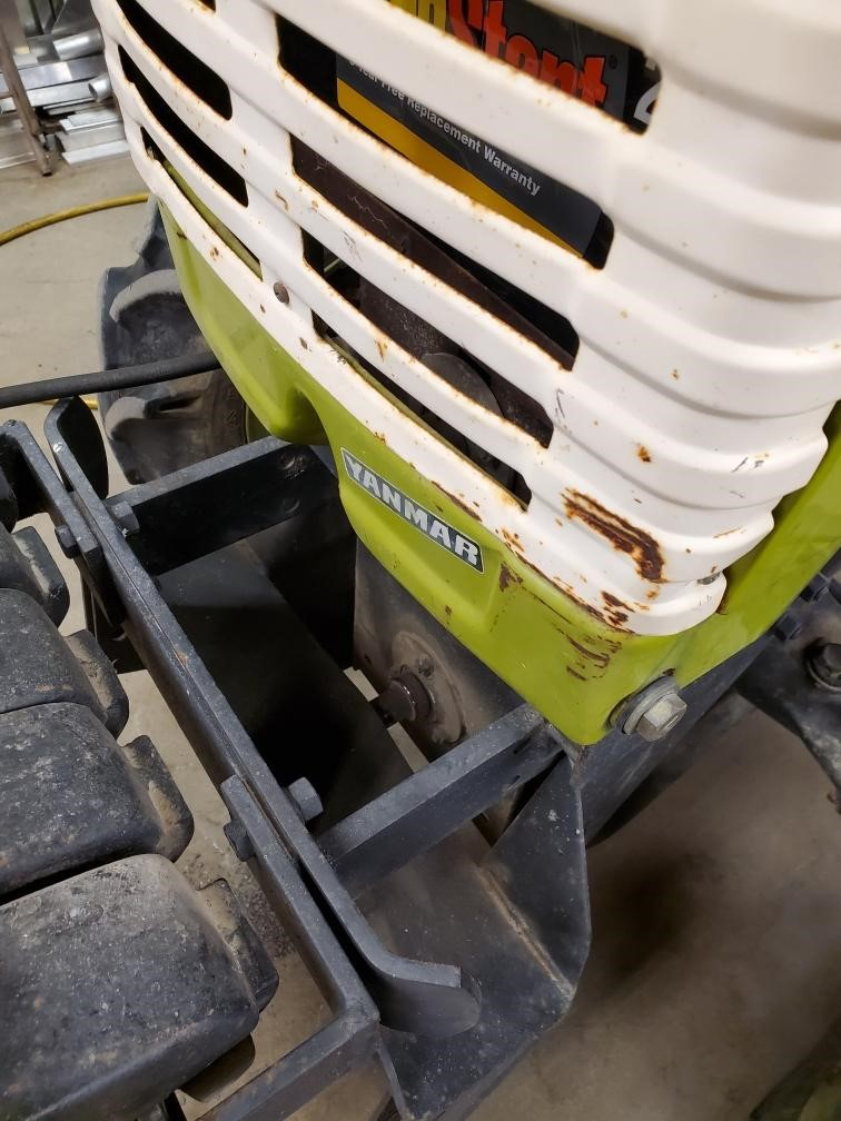

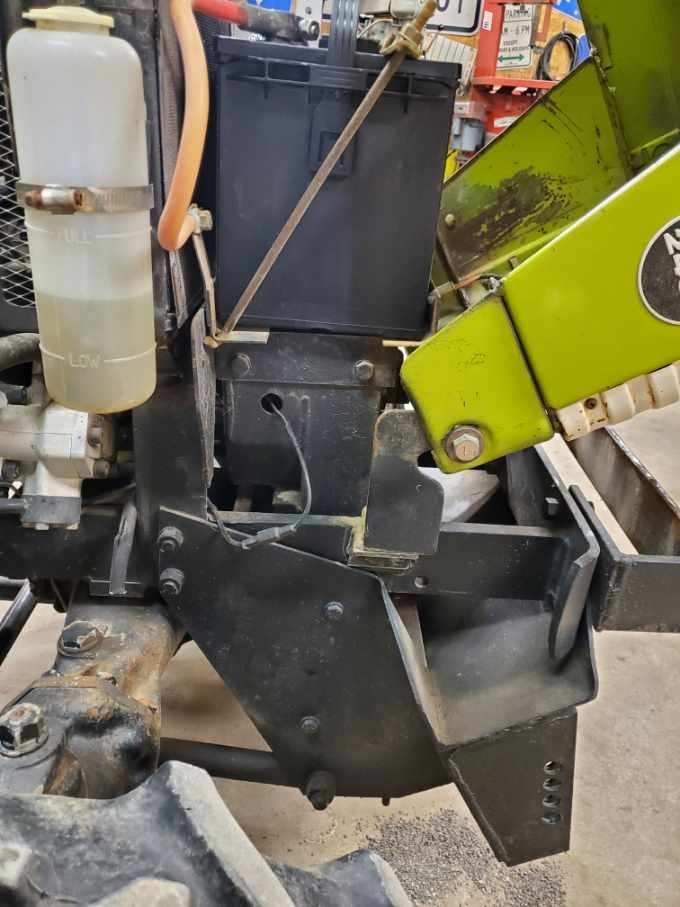

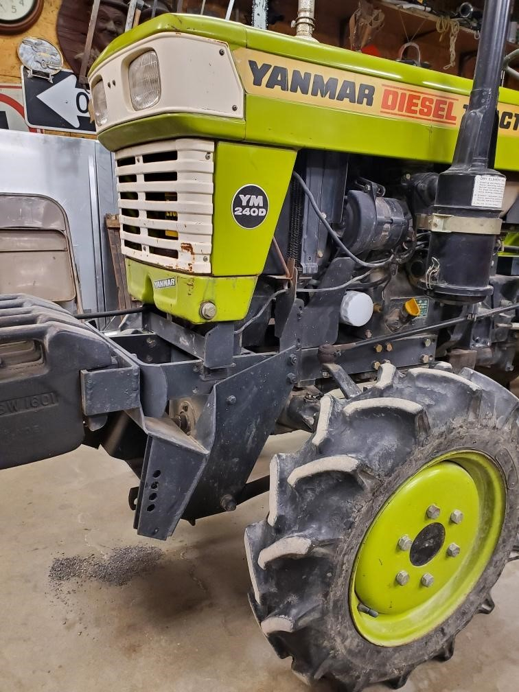

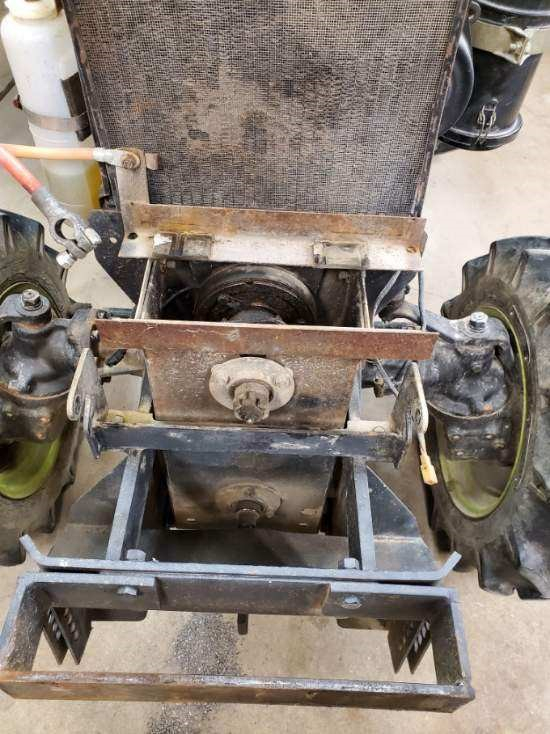

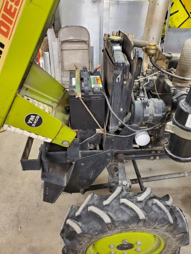

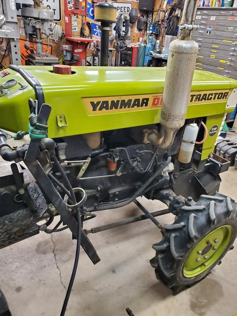

Does anyone know if Yanmar made a factory front mount PTO setup for any of the Grey Market or Domestic Tractors? Was this an option or did someone do a really good job making it look factory? I am only asking because a friend of mine recently bought a ym240d with one on it and it works good, it is a gear and chain driven unit with a switch on the dash. However he does not have a need for it and does not want to leave it on the tractor. The previous owner said that the guy he bought it from used it for a snow blower. He has taken it off already and will be for sale soon. I have attached some photos for reference, please feel free to chime in with any knowledge about this or inquires to purchase.

Yes.
It's in the Options chapter of YM240 Parts Manual as I recall.

Thanks California. I was able to get a hold of that manual and that image you provided. However that diagram does not look the same as what this 240d has on it. Completely different setup, or at least that is how it appears to me. The one on this 240d also has a chain drive as well as the v-belt. I will see if I can get some better pictures.
/ Front PTO YM240d #4
I really wonder if some took the rear PTO drive to a mid-mower and converted it to a front PTO application. It's doable from the looks of things. The too was OE from Yanmar in the past for mid-mowers being driven off the back PTO spindle. hmmm.
More pix would help a good deal.

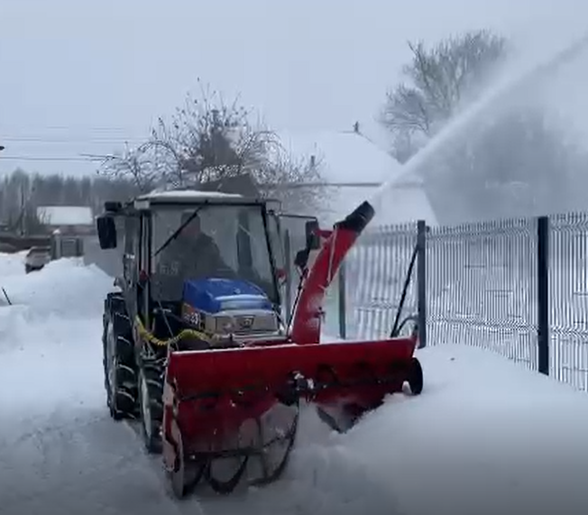

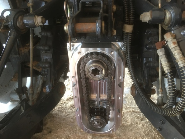

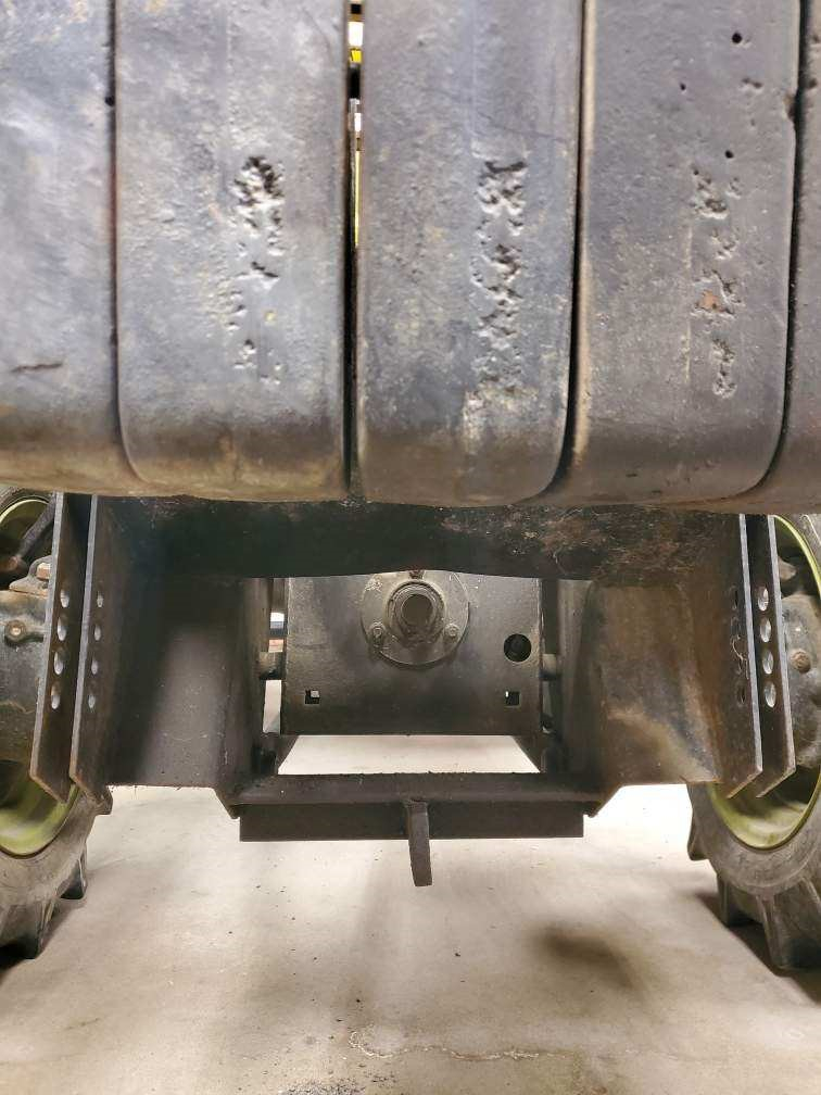

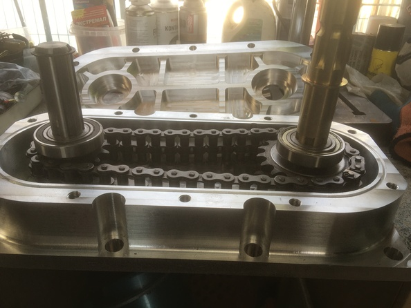

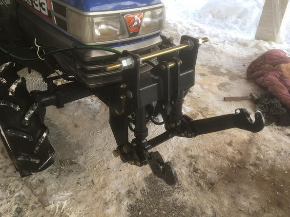

I was helping a guy out with his Iseki tractor that didn't come with the PTO option. I told him that some of the Yanmar machines had mid mowers driving from the back PTO spindle via a gearbox going forward. He took that concept and made his own.
He was able to order the front lift kit.
Now for the rear PTO drive, he had to make it. The tall spline shaft is his original PTO shaft out of the tractor. He placed it in there for fit/form/function purposes.

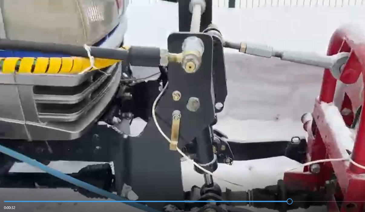

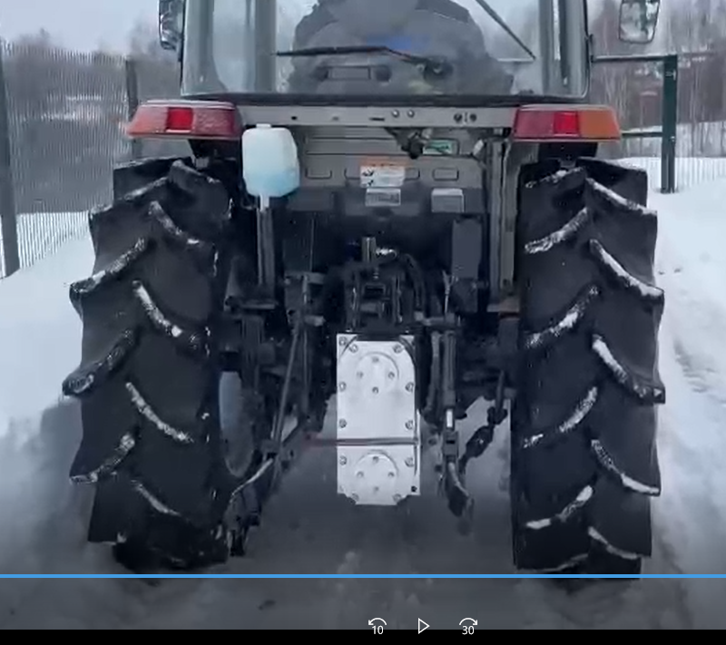

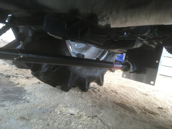

He posted a vid of the tractor in action. It is such a smooth drive too. When winter is done, he can just un-bolt the rear gearbox and use the tractor normally again.
That is some pretty amazing machine work right there. So his gear driven unit that he built looks pretty close to what is on this 240d, but is driven from the front of the crank and not of the the 3pt pto.

That gearbox sending the PTO to the front is working great for him. His snow blower must use most of the tractor's hp, and its working flawlessly.
/ Front PTO YM240d #16
Thanks! All better now.
I'm amazed how quiet it runs. In the vid the auger hits something like a stone and the noise is much louder. Everything is meshed together like an OE setup.
All I did was share a Yanmar manual with him for the idea of the gearbox. He and a few others did the calculations and completed the task. He did send me the SolidWorks CAD files too.
