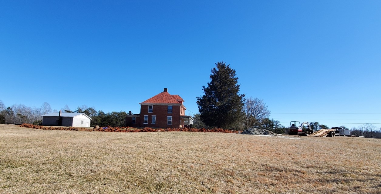

Well guys were back today to grout the casing, run the water line to the house and shop, ran the electric as well. Should have water Friday.

Nice place Step - what size pipe and pump and holding tanks are you installing? 1.5 or 2HP? Size depends on where the static water level is when pumping.
Sounds a lot like our new well in 97 - went down through granite from 10' on to 420' 1-2 GPM so had it hydro fracked (another $2K then) and got 10-12 GPM with water level at 90' with a 10GPM 1.5HP goulds pump @ 375'.
/ New water well
#39
We went a total of 610 ft. Well head is at 35ft, and pump set at 585 ft. With a 6inch casing this gives us about 800 gallons reserve at 3gpm replenish rate. More than adequate for a 4 bedroom/bath home. We put in a 30 amp 2 pole breaker for a new 220 volt Grundfos pump. I ran a line to a yard hydrant near the shop (250ft away) and a T to the house (about 100ft). Also put in a yard hydrant 6 ft from the well head for future use. All water lines are 1 inch blue poly. The entire process ran right at 12K finished including electric.
/ New water well #40
How long does it take them to drill through 410' of granite?
Here they went 760' and 4" casing to 460'. Mostly sand and clay took about 12 hours of actual drilling.
