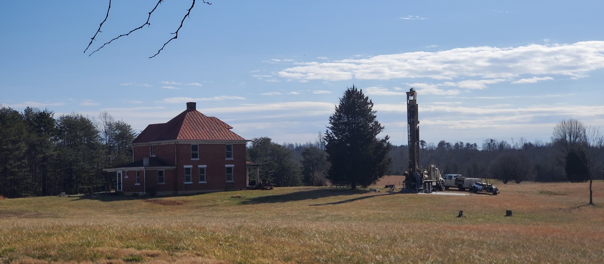

Just had my first experience with drilling a new water well. Pretty amazing piece of equipment to watch. Took about 12 hours to hit 620 ft. According to my driller we have right at 4 gal/minute replenish rate, a 570ft head of water with the pump sitting at 585; this gives us an 800 gal reservoir in the well. 4 gal/min doesn't sound like a lot, but with reserve we should have more than enough for two people. We have a spring house as well on the property, but I don't have power to it yet.

I always thought 4 to 5 gal/min was a good average. It's the reserve that is important. Am I wrong?
/ New water well #5
I don't see a slush pit, so must have drilled with air. Air drilling can go quickly if they don't hit anything very hard. 4 GPM is 5,760 gallons per day. As long as you have adequate storage 4 GPM can supply 10 or more houses. A good water well is one of the best investments a person can make.
Regular submersible motors do not have brushes. The brushless thing is for variable speed pumps, which you want to stay away from if you want something dependable and long lasting.
According to my driller you are correct; he said he has wells in the NC piedmont that only produce 1/2 to 2 gpm and work fine because of the high reserve in the well.
