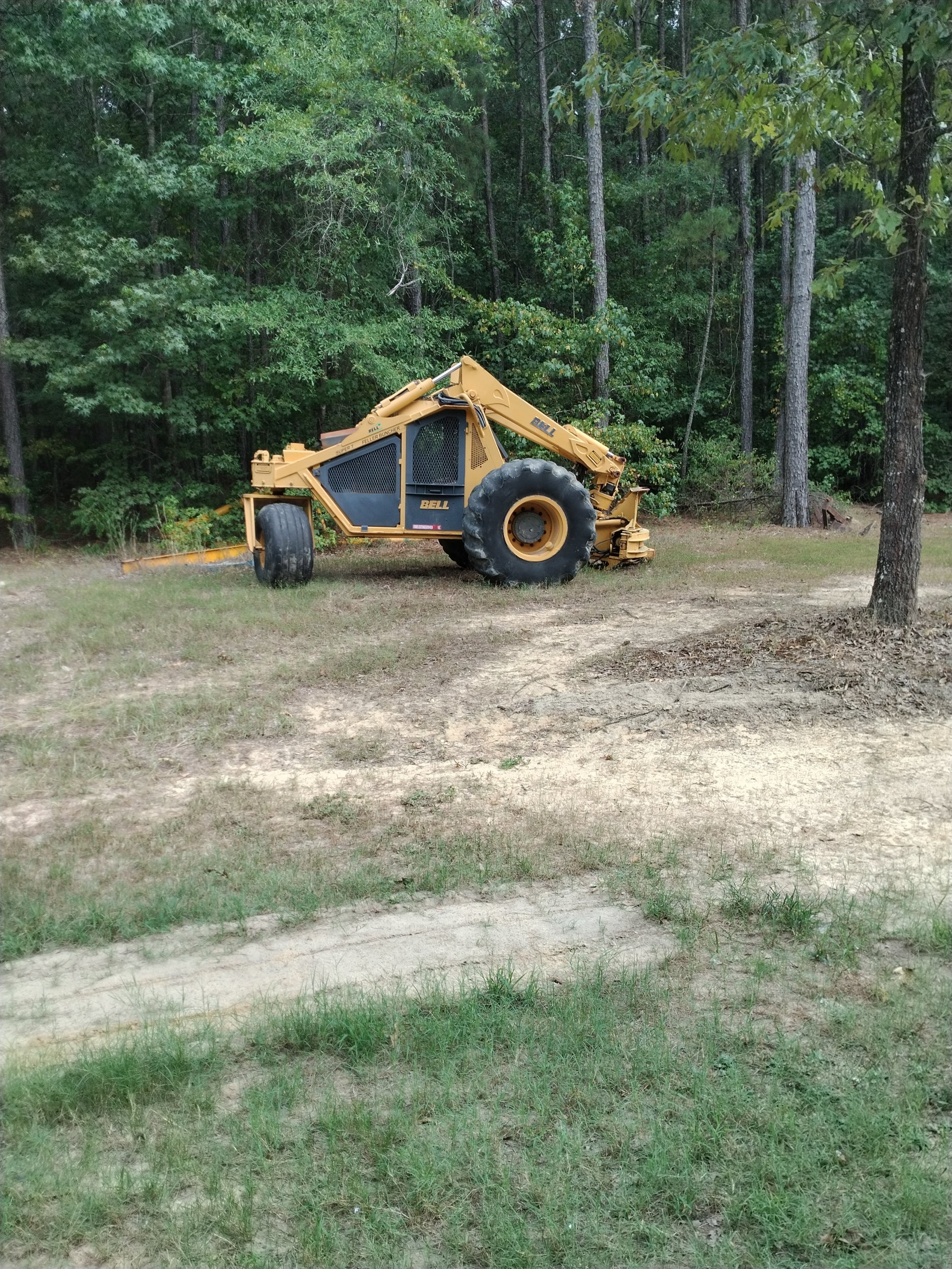

/ New Tree Shear slow closing. #10
We have a shear head or two for this. It has a lot of hydraulics, but it takes a lot too. Saw head is on it now.
