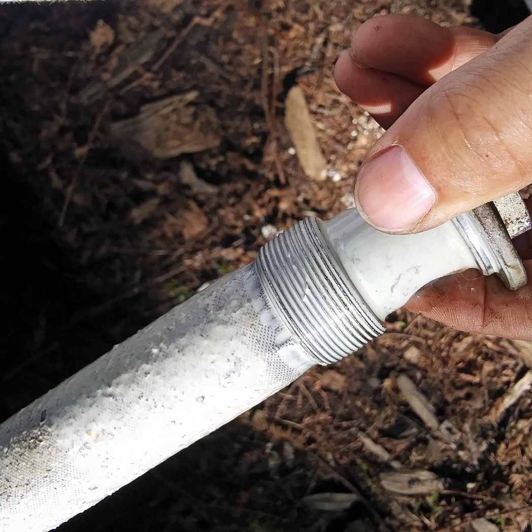

... there is almost always a screen on the suction line to the pump. If you are operating in a dirty environment, or the machine is older, or fluids are allowed to become contaminated, that screen can become plugged so that the hydraulic pump cannot provide enough suction to start picking up the fluid.
Yes!
Some of those early Kubotas have only suction filtration, and water contamination can turn the oil into a booger-like substance. Priming the pump thru a clogged inlet screen may be difficult.
Photo is inlet screen from a mid-80s B8200. Ugh.
