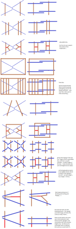

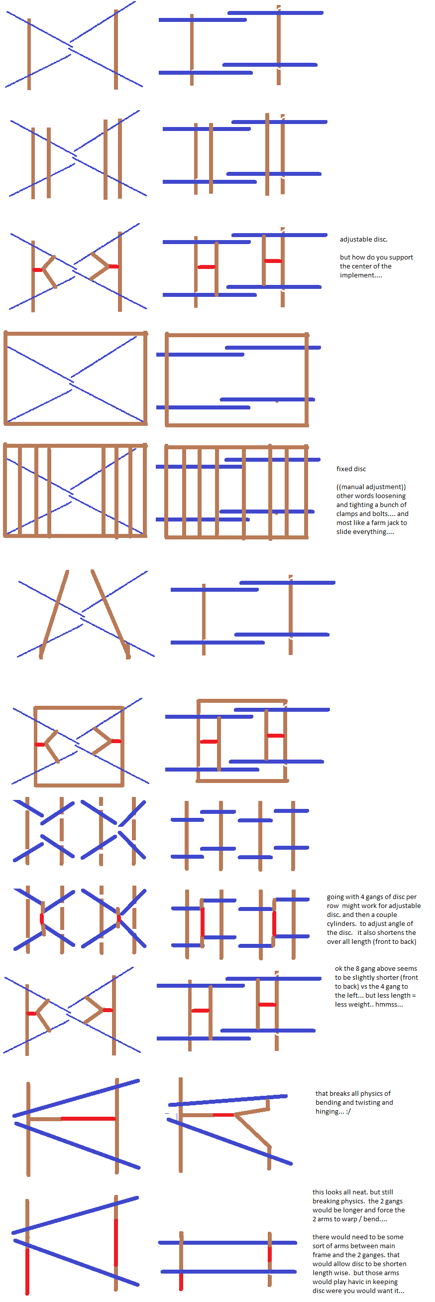

autodesk tutorial site, is acting funky at moment, pictures not loading / page not loading. and need to finish up tutorials before charging into the next video, not having a clue what he is talking about.
critical? huh? *shrugs* never phased me. *laughs* did not even think about it, till ya said something. internet at its finest, of being impersonal, and not being able to read body language of person ya talking with.
ya, i understand about keeping things simple. biggest part of this thread, is just getting a understanding of it all, myself, let alone anyone else.
electronics and lighting strikes :/ ya that is a big one. to many times machines get left out in a field and they are the tallest things around, and then of all things get placed right up near a field fence :/ *big frown* old farmer that worked this farm for some time, i know he has been nailed by lighting a few times. just driving down the field up near the fence line. and lighting hitting the fence clear down the line and out of site. and sending a charge down the fence line and attacking the tractor per say.
i am not overly to worried about lighting on each 60 feet section. but rather when 2 more 60 feet sections are combined into a single working machine. and lighting hitting one end. and sending electricity clear through everything. to the very far end at 120 feet away. that worries me. i guess i should say each section as well 60 feet is a long distance, for machine to get into different hot spots. that could cause a couple lighting strikes... (guessing)
i am still having a hard time with running electrical motors directly in the rims of the tires or the like. just do not like that many AMP's and chance of a potential vary dangerous situation happening. more so, someone bozo thinking they can fix something, without shutting things down and properly grounding things out before working on something...
good portion of above, is more likely ya see me reference to hydraulic hydrostatic transmission, or hydraulic motors.
complexity, and keeping it simple, ya it been driving me crazy, with the implement linkages, to linkages to deal with wheels to tracks. along with valving and sensors. KISS (keep it simply stupid). there going to be a lot of battle of this and that. in simplifying things to complexity. i am sure there going to be a few "wellll...." judgement calls, of adding a couple bucks more to total cost, for some sort of harness connecter for wiring harness, or a quick disconnect for hydraulic oil, or perhaps another bracket, that you can actually get a socket wrench / breaker bar on. and then just simply being able to maneuver around the machine to work on it, engine, to valves, to grease zerks, to fueling it up, and checking the fluid levels. to other. along with points were you can actually place a jack under something, to lift things up, to work on something. you say simple. but most machines get complex fairly quick. in order to make the machines simple... i am still trying to figure out, how that works out ;):D

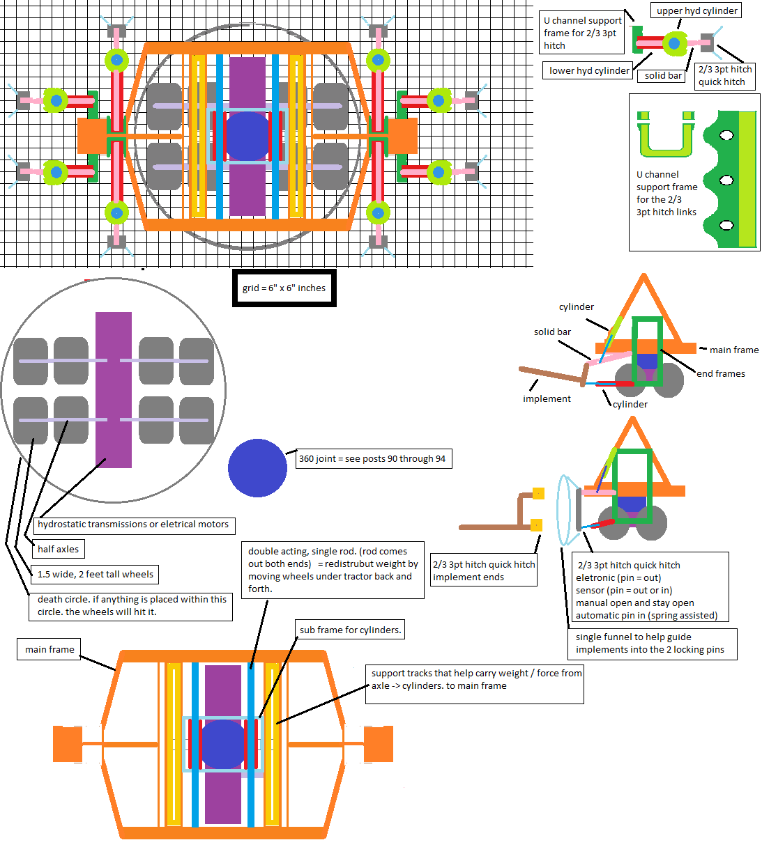

Using the electric motor drives is probably the simplest solution. I believe power to wheels and efficiently will be far superior to hydro drives.
Hybrid vehicles (Prius, etc) use electric drives. Some voltage reaching 600 volts.
Also modern railroad locomotives use diesel powered generators to power their electric motor drive wheels. Proven technology.
By using electric drives, the integration of controls is much easier on the entire machine.

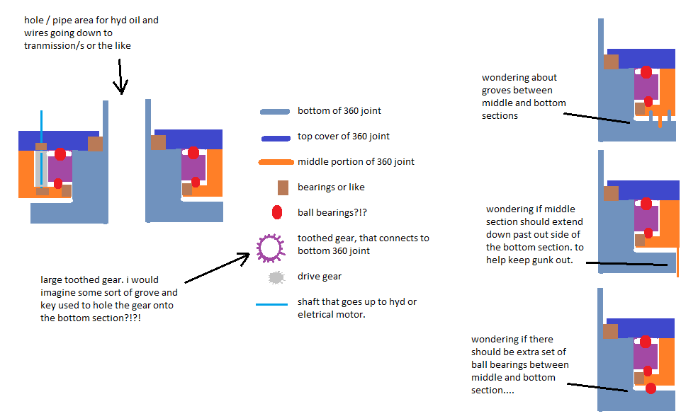

how are electrical motors going to hold up, when they get completely submerged under water and/r caked with dirt, that is a few inches thick? how is the "heat" generated from the electrical motor, going to hold up in those type of situations?
you really can not put a fan on the motor, and/or rely on "wind" of just going 30 to 70 MPH through the field to cool the motors.
any sort of internal fan. that requires any sort of *its on tip of my tongue*.. baffles and air ducts. to keep rain water and like out, and your risking flooding the motor, when ya go through any sort of mud puddle found in fields, and other nasty areas.
if a heat sink, was placed on a electrical motor, to help reduce heat. you are still at risk of mud build up. and reducing how much can be removed.
hyd motors, the hyd oil itself, can be cooled at a different location than were the hyd motor is. and in that help keep the "temperature" at the hyd motor down.
ya a blanket statement comment, of not wanting to submerge anything into any sort of water, or get mud build up on things. but if that is the case, ya sitting in the shed not doing squat.
a train, the wheels do not go through mud or snow, well i am sure they do, but once snow gets to a certain point, i would imagine snow plows get added to the front of the trains. to keep all the wheels on the track.
electrical cars / trucks. i really can not bight into, at least everything that i have seen so far, is made for highways, and streets were there is no mud / water.
there are some electrical tractors folks have done, and ones i have seen have been tractors that have been modified, were the engine was switched over to the generator, and removing drive shaft between engine and transmission. and placing a electrical motor back on final drive area of the tractor. keeping the motors up and out the way of water and mud.
at moment, i just do not see how a electrical motor located at in the wheels / rim. or just offset just outside of the wheel. could hold up.
and due to how the SSTT (sideways snake train tractor) would move, with both transport wheels, and then with large AG tires and/or tracks. i do not see how it would be possible to use drive shafts, to keep the electrical motors up higher off the ground. so they do not get submerged under water or caked with mud, in the every day life, of a field tractor. and if it was possible, (most likely is) adding the extra drive shafts, (like transfer cases for 4WD / MFWD) would add more complexity and points of failure.
then again, i very well could be wrong. i know, i do not know enough about electrical motors, let alone experience. to fairly judge them. would loved to be proven, wrong!
and i know "i just walked right into it" so lets hear it! :)

You bring up a good point regarding motor cooling. In order to keep the motors small, water cooling maybe the best solution. I agree air cooling is no good.
A good application of sealed water cooled motor to study is underground mining equipment. These motors must be sealed due to potential explosive gas encountered in the mines. Water is pump through the miner into water jackets that surround motors and then sprayed out onto the coal or ore to reduce dust. This is a very effective system.
Your system could use a similar set-up as the mining machine... except you would recirculate the water (closed loop) to a radiator. The system would be 100% sealed.... so no issues with mud getting in motors, etc. The motor can be directly attached to the wheels using a planetary gear train. Very rugged and very simple! Modern large dump trucks, wheel loaders, etc use this system. If you can use a brushless motor... all the better!
I believe the hydro system will have too much power loss on a machine as large as you are talking about. And will be especially limited at higher speeds. Even a small hydro compact tractor (5000 lbs) must use a 3 speed gearbox to compensate the hydro motor for different speed and load conditions. And they only have a top speed of 14 mph! Your tractor must have major pulling power and I'm just not "feeling" hydro drive for it.
Electric or Hybrid vehicles are exposed to extreme conditions during normal operation. Water is always an issue. Hybrid vehicles use a cooling system to keep the motor controllers and motors cool. The systems are fully sealed and have no issues when operating in mud and water.

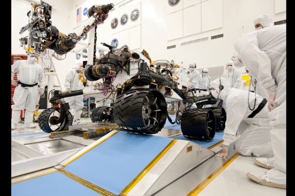

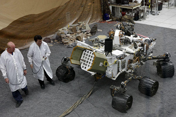

Great example of electric motor hubs operating in extreme conditions.... Of course in this case the machine isn't cheap! :laughing:
Looks kinda like your SSTT ey? ;)

but more to the point is the 2 cooling hoses. (cold in, hot out) lines. and then wrapping my mind around, needing to run some heavier wires, to and from motors.
the wires connections themselves, are going to be a problem. i am not familiar with any sort of larger size connectors for electrical wire, beyond "water tight" connections for conduit to run wire in. i am not sure if a simple rubber boot that could be physically moved about. to deal with wires on repairing things, would hold up long term. the nearest thing i can think of, using some sort of silicon or polyurethane or some form of calking tube. to apply something to water tight connections of electrical wires.
well a suppose a generic water proof/dust proof wiring harness connection could work. that has a 0-ring or 2 to seal things. but how do you deal with, when a wire gets snagged, and pulled. and redoing a wire, into a wire harness end connector...
i suppose awe i do not know the technical name. a plastic cinch? pushes over wire end and over the insulation, and is kinda in shape of a "cone" with slots around the perimeter of it. kinda like a compression fitting of a gas line, and tightens things down around the wire.
as far as gear reduction, and 1 to say 4 gear box. ya i know, MPH, both in field and in transport mode is still up in the air. planetary gears or other.
i really do not want to add a centralized transmission / gear box on the SSTT main frame. and in that rather have, each set of transport wheels, or large AG / R1 Tires, or tracks, have there own motor/s, /transmissions, and switches / sensors. on each doing. or near to that. some of it has to do with overall length and distances between each wheel set / tracks placement on the main frame. other. i could see a few folks. tossing the transport wheels, and adding another set of tracks in that spot. and then using some sort of modified "trailer" to transport the SSTT. or upgrading, from say AG/R1 tires, to tracks. another part is being able to "adjust" wheels and tracks. to some degree. for spacing for crops, to other. and perhaps "turning into a robot transformer in idea" between planting to harvesting, and turn into a better unit geared for harvesting or planting. pending on the upcoming season.
